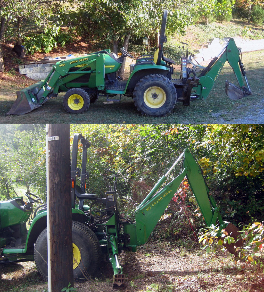

Thanks to avc8130 I finally have a mounting comparison between the stock 47 and my 8B. Looks like I might have done slightly better than Deere did. :D

I think the turf tires larger diameter is creating an optical illusion. If you're adept with a decent paint program, you could cut and paste the turf tires onto the rig with the R4's to get a better comparison.

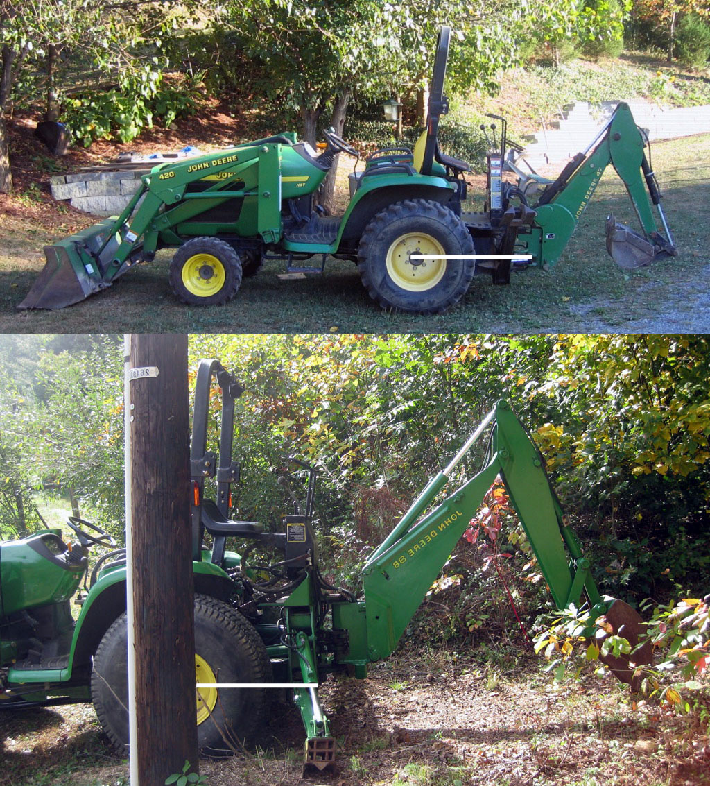

I was actually measuring from the center of the axle hub. See the new pic for what I mean.
How about this then.... my mounting isn't any worse than Deere's....

I agree that the different diameter of the turfs vs. the R4s make it hard
to compare the mounts visually. Of course, the 47 is much different than
the 8B, too.
It DOES look like your departure angle is better for the 8.
