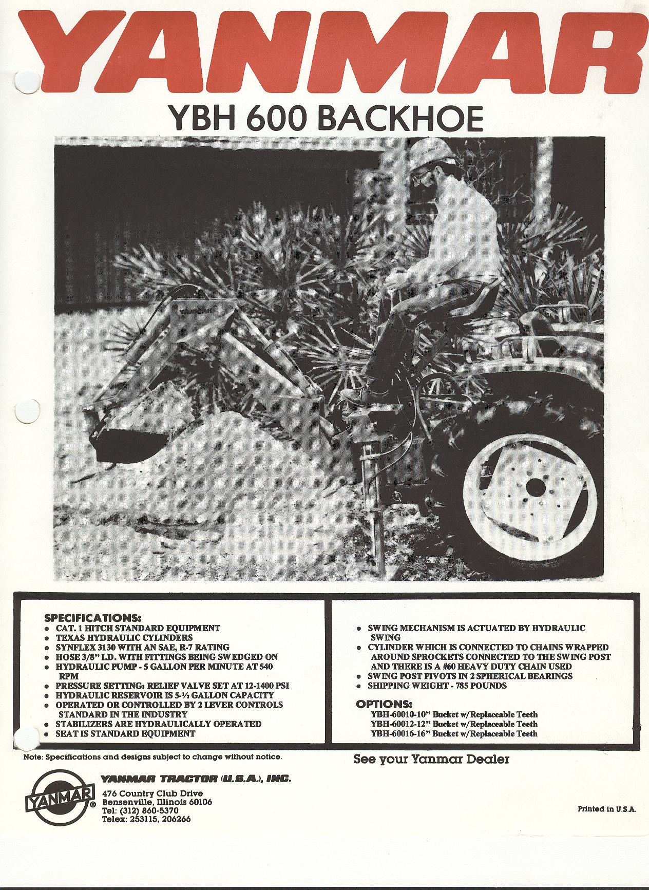

Sure you can do that. Yanmar used to make about 4 different models of subframe and 3pt PTO-driven backhoes for their 25 hp and under tractors. So did several other companies. Bradco still does. We had one...It was Yanmar model YBH600, and cost about $2500 back in 1985.
They aren't real popular and you could probably pick one up for under a grand today. There really isn't anything much to go wrong with them. Ours had a PTO pump and about a 8 gallon hydraulic tank with filter under your feet.
I used it for chores like you describe for about 15 years and did a ton of handy work.
It's almost a toy - but a toy that easily does the work of several grown men laboring with shovels and wheelbarrows.
Even these tiny hoes are rough and stressful on little tractors, and really throw the tractor around - but it sounds like you have the experience to avoid tearing up the machine. And if your tractor has automatic draft control BE SURE TO TURN THAT OFF! Draft Control can tear up a 3pt/subframe hoe and you with it. It almost happened to me.
But they are real handy. I replaced mine with a real TLB but if I hadn't I'd still have it. I've not seen a thumb for one. If I had mine back I'd at least put a mechanical thumb on it. No more power than it has, you wouldn't have to weld the thumb mount to the dipper stick, just use some old Chevy leaf spring U bolts ought to be enough.

I didn't even know Yanmar made one of these. I would LOVE to find one, especially for a grand! I'm gonna have to start looking. It looks to be a little smaller than what I was thinking of but with a thumb it would really do most of what I want it to do. If I could find one of these that cheap then I will keep the Case, just in case. Pun intended. The small size might just be perfect if I keep the big machine. And I already have a Yanmar tiller so it would have company when the post hole digger or back blade is on the tractor.
Thanks,
Eric
