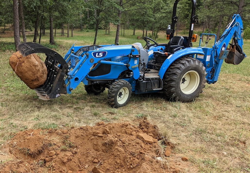

I've used my BH way more then I thought I would. Basically if I could lift the log, stump or rock high enough for my old 4x8 trailer I was good to go. I just have too many large rocks to use my tractor bucket where I need it, it just beats the crap out of it when I hit one.
Everyone is different but unfortunately for ME I ended up getting a 3pt mount BH for my old JD770 a few years ago as I just couldn't find the factory one. Just got tired of renting one, which is how I got my JD also. And I did look at 3pt mount issues. There's even someone who's broke their tractor WITH the sub-mount so, it's either gonna break or it won't. I tried to get the lightest one that looked like it would hold up. I ended up with the WoodMaxx WM6600 self contained one. 180 degree swing. Got it with some extra's like the Ripper, Quick Connect system (for bucket change over), and Hyd Thumb. I do love the hyd thumb, it does fold out of the way so you don't even know it's there. Comes with a 9", 12" or 15" bucket. I got the 15" as I needed more digging then trenching. I think I paid around $5000 and a few penys delivered. (pre-pandemic) Hell, my neighbor spends more on beer/cig's in a year. It depends on how you look at it.
I ended up getting a new '21 LS MT235HE this last winter so I've since moved the BH over to it. I also ended up getting a HYD 4-1 bucket for it also, but I still need my 770 to get to our burn pile in the winter/spring as the LS is just too heavy for our mud as far as leaving ruts.
