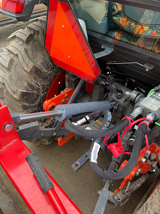

That's design and ergonomics built together. Awesome to be able to leave the lower arms in the tractor. I did a video here on trying to mount the BH92 Backhoe on the Kubota 3560... just NO clearance at all with the 3 point left on.
Additionally, I've found that a top&tilt option for the Kubota isn't offered if you have a backhoe subframe. Again clearance issued prevent this. You would think that instead of designing a subframe, and then finding that other upgrade or additional offered updates to the hydraulic functionality are hindered by its design, that Kubota would have done a contentious design taking into consideration all they need to.
You can do the top just not the tilt w/ BH. My dealer takes the OEM TnT Kit and sells just the T.
   / Anybody using a backhoe attachment on their CUT? #103
Is it the hydraulic remotes or the side link cylinder itself that interferes with the backhoe subframe? I can't really see what would interfere in that picture. Looking at the left sidelink lift arm, it looks as though you could just substitute a hydraulic cylinder there. Or is the upper attach point for the backhoe too close to it?
It does look crowded enough that you would have to take the lift arms off when installing the backhoe.
