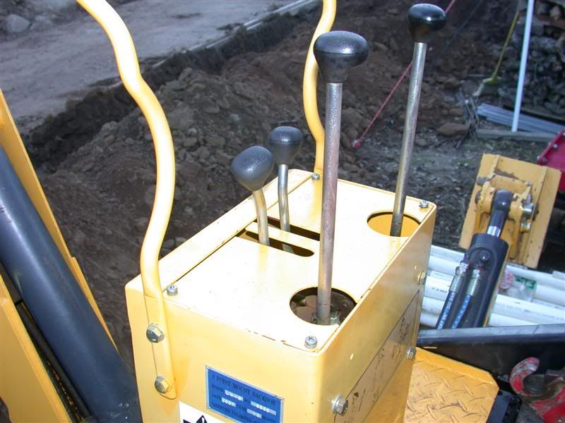

Thank you , yes you have . The valving you have is able to work in the x+ Axis and not just + which only allows for 90* movement . I wonder why they put the + in the tin panel so you can't use this function ?
/ Diamond Shape Sub-Frame for LW-8 Backhoe #22
Probally for saftey. So the user can only do exact movements. Liability. :mad:

Excellent. I know you were shooting for less play than with the Nardi's
subframe.
RE the LW-8 valves, I have heard a number of complaints. Compare/
contrast how they work with the Nardi valve: I heard they have no
load checks. Do they have any work port RV (shock-reliefs)? You have
already fixed the obvious limitation, the panel slots. If you can't
live with them, replacing the whole valve stack would not be too costly,
considering you got a great deal on the hoe.
Scott is possibly right in his reply?
Other than that, I don't know why. It works just fine when using simultaneous movements now.
Other than the valve is rather "rough" compared to the super smooth Italian Nardi backhoe valve. But nevertheless, I like the LW-8 and as you saw the trench, I'm getting used to it and it has a lot of power.
The valve is the stock Jinma Backhoe valve (I believe).
It's not nearly as smooth or nice as the one on the Nardi. But since I made that change to allow all movements, I've gotten used to it. Need a little more time in the saddle, but I don't think I'll be changing out soon. I have not checked the valve out completely yet, so I don't know about the load checks yet. I plan on installing a pressure gauge on it soon though. I want to be sure the working psi is where it should be.
In fact, the Chinese hoe is like their tractors, lacking in fit and finish but the basic concept is good. The Nardi is a top quality hoe in comparison. And even though there is a lot more "flex" in the LW-8, it is still robust enough to do the job. When I swing the boom around, the dipper stick jiggles a little. The Nardi is solid. It also has a hydraulic filter (not suction strainer) and the LW-8 has nothing ... not even a suction strainer. It does have a lot of power though.
