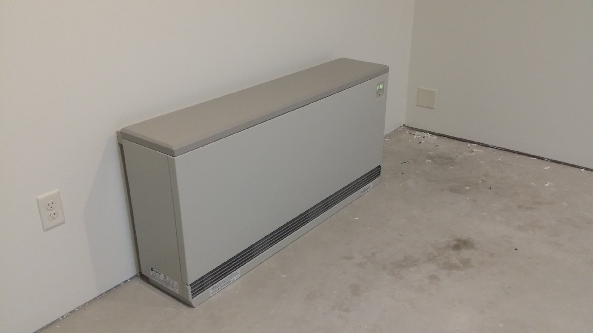

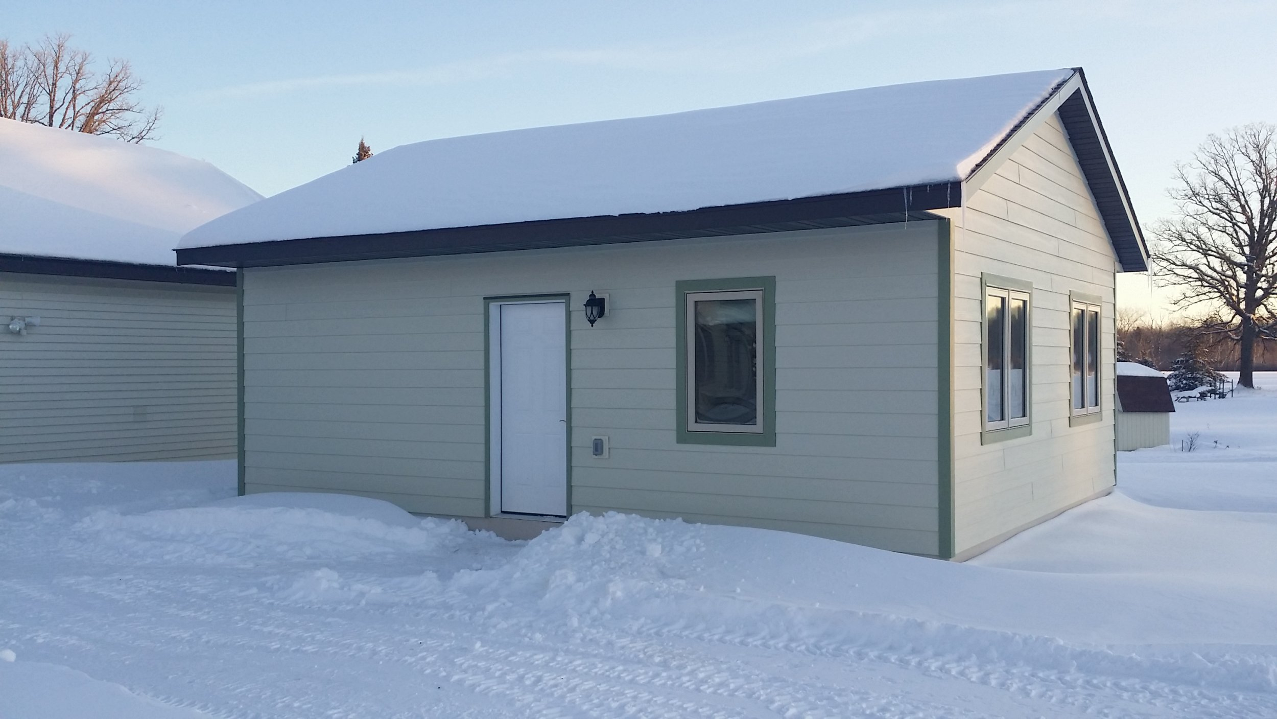

Yesterday, we just finished the installation of our 2nd electric storage heater. This one went into my wife's new 520 sq ft sewing studio....aka, her she shed.

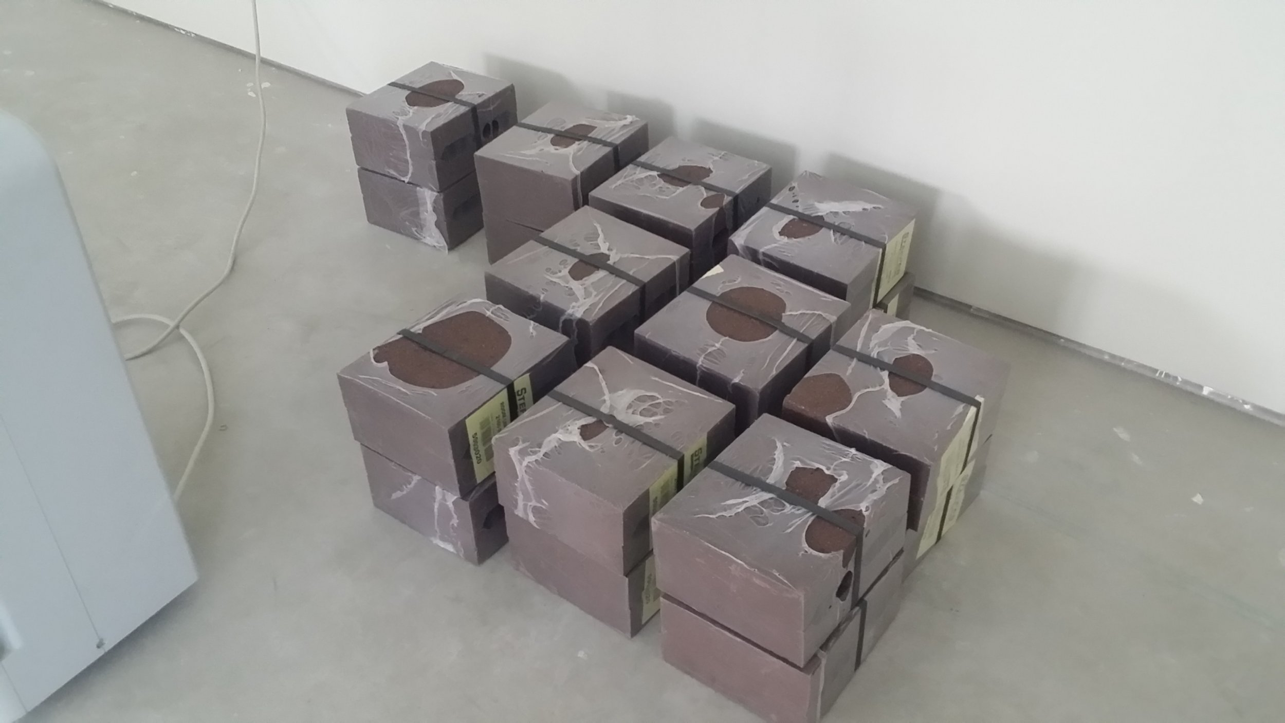

As wired, the heater runs on off-peak power. When "charging" and using both heating elements, it draws 7.5 KW. The heat generated by the elements is stored in 400 pounds of brick that takes up the majority of the heater's internal space. An onboard controller determines the speed of the blower fan so as to push room air through the bricks and out into the room in order to maintain the desired temperature. An outside temp sensor keeps the controller updated to help it more efficiently determine how much "heat charge" it may need to store during the next cycle. I'm sure the control algorithm is more complex than that but that's basically how it works.

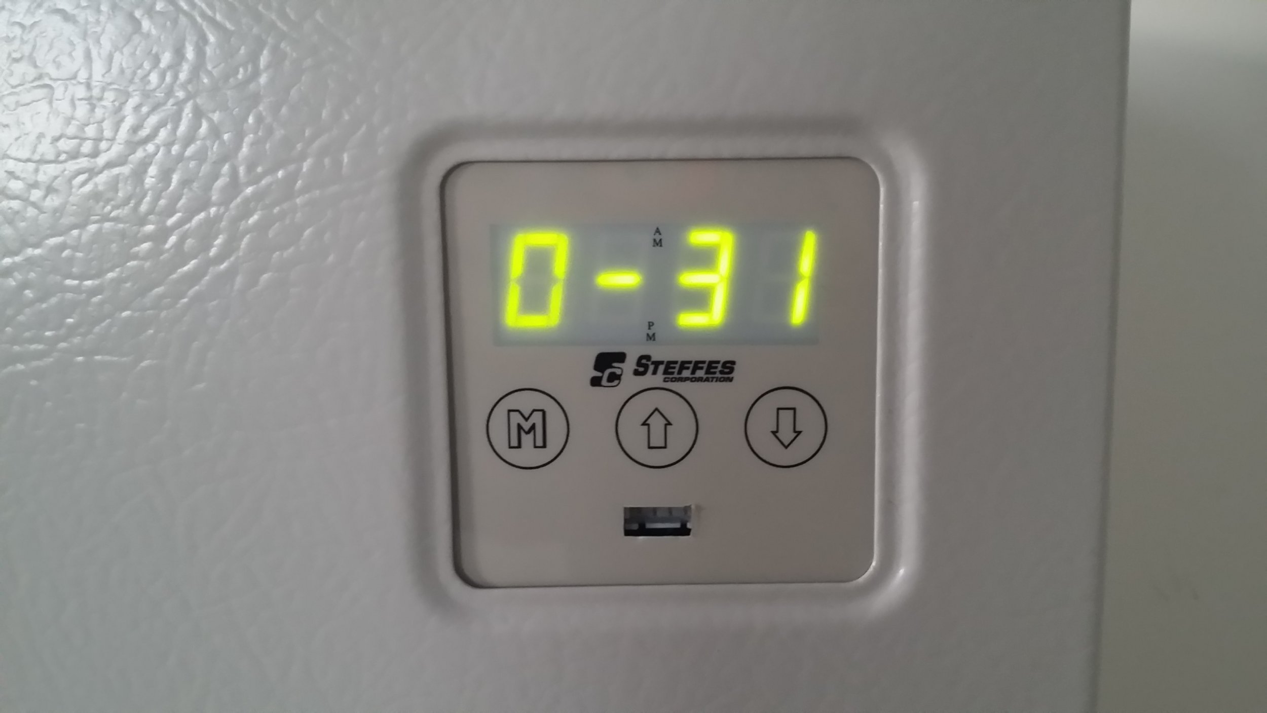

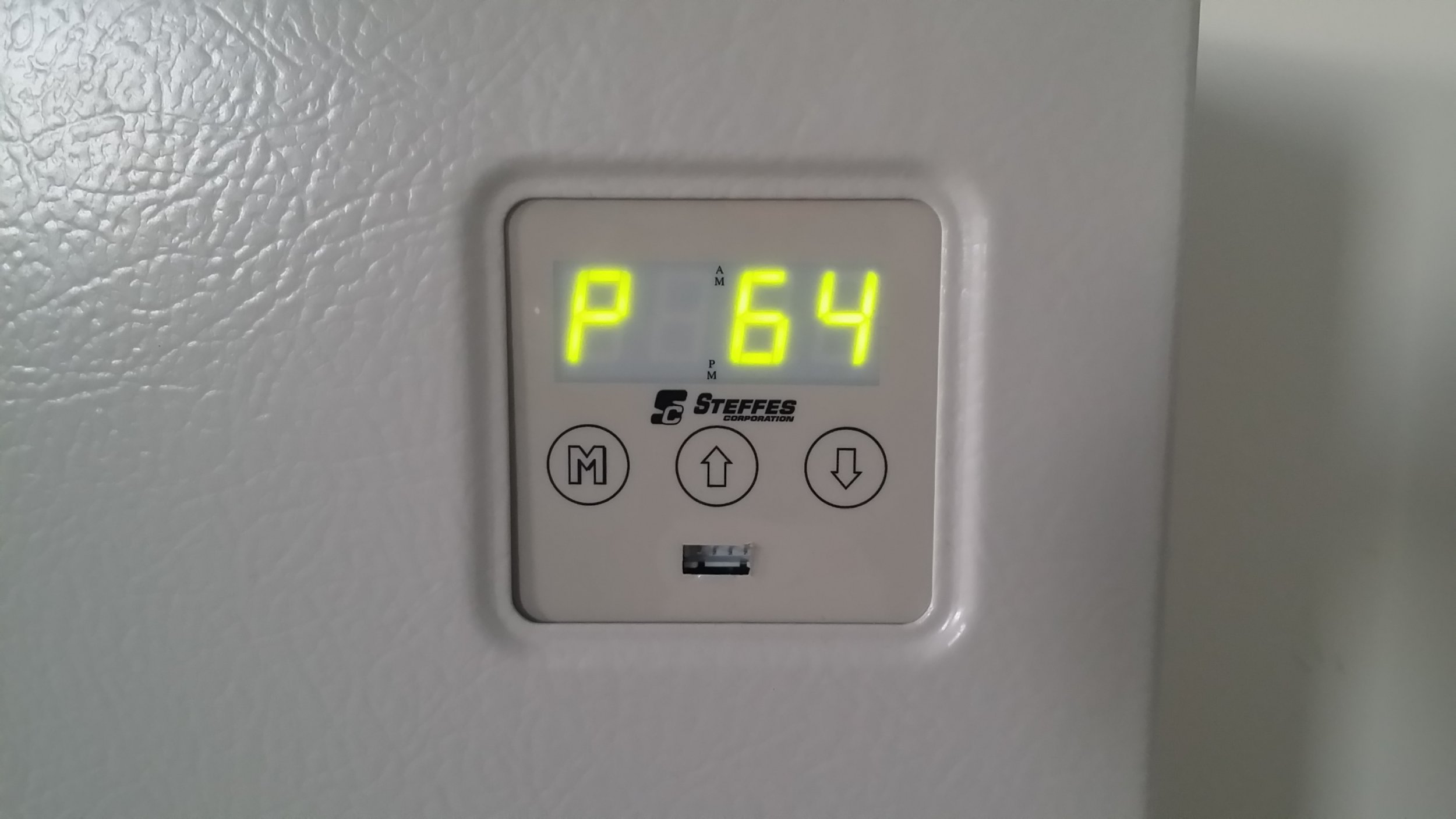

So last night was the first night of use and the first time after being installed that off-peak power was available. When I got up this morning, a quick trip to the sewing studio showed everything working perfectly. The 2nd photo shows "P 64" which means the off-peak power is not available and the ambient room temp is 64 degrees. The 3rd photo shows "O-31" which means the outside temp was -31F. The 1st photo shows the storage heater as installed in the studio. The 4th photo is of the sewing studio. The 5th photo shows the 400 pounds of bricks before they were installed in the heater.
We'll be putting in a new wood stove in a week or two. When my wife is working in the studio, she'll light a fire in the woodstove. The intended purpose for the storage heater is to maintain a constant temp in the building so that her sewing machines and other items don't experience the winter temp swings that northern Minnesota would otherwise cause.
We have another one of these storage heaters in our 1000 sq ft ICF basement. It keeps the basement very comfortable without really trying all that hard.

As I said, it was just installed a couple of days ago so we're going to have to go a few more weeks before I get a bill. Obviously, it will depend on what we set the temperature to and also how cold it is outside.
If others wish to consider it as a heating option, they will need to take into consideration how energy efficient their building is. My wife's studio doesn't have the flooring installed yet, that is how new it is. It is very well insulated too with 6" walls, 1" hard foam between the OSB walls and the wood siding, with about 16" of blown-in insulation in the attic. The floating slab has 1" foam under it and 1.5" foam around it. Lastly, the windows are quite good and have excellent solar gain for the larger windows via their south-facing placement.
That all being said, I'm guessing my heating bill will rise about $50~$60 a month during the coldest winter months....but that is just an educated guess. I won't know until later in February. Also, the building will have a nice wood stove in it so the days my wife is working in her studio, she'll have a fire going which will greatly reduce what the storage heater needs to supply to maintain the desired temp. In fact, with it's thermostat set to a lesser room temp than what the wood stove is maintaining,the storage heater's variable speed blower will shut down and conserve the stored heat in the bricks.
