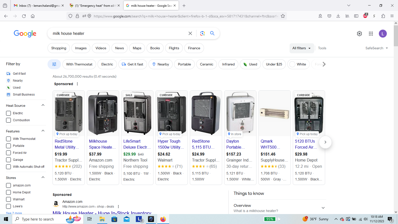

such as this or the cheaper ones from Amazon;
We have used the "milk house" electric heaters for many years in milk house to prevent freezing.
They are used all night long "unattended" do we worry at times? Yes, but I'm not going to sleep out there in the winter!!!

Those milk house controls are great for items that are exposed in the milk house, which are also usually made of non-flammable materials like concrete...
