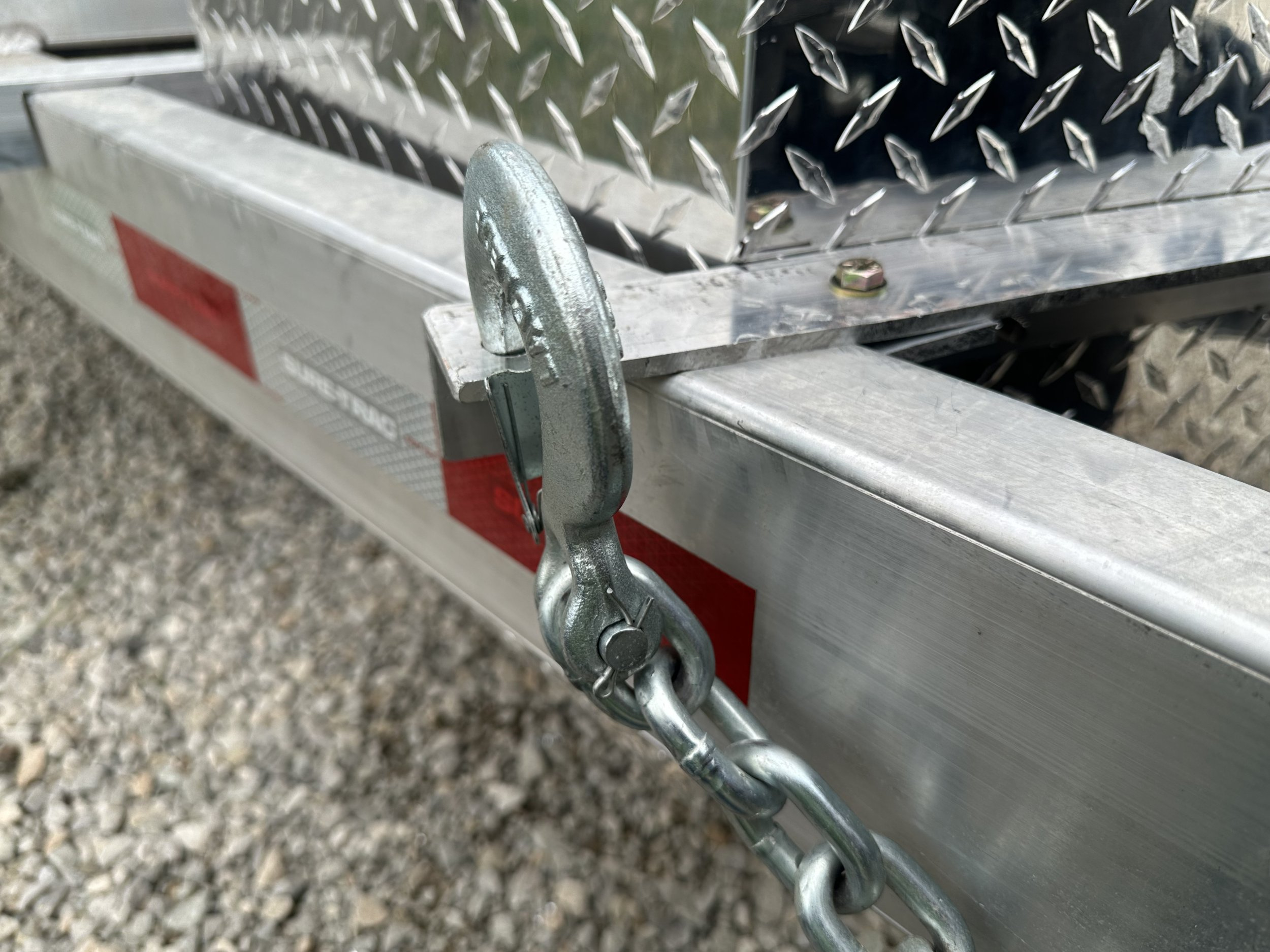

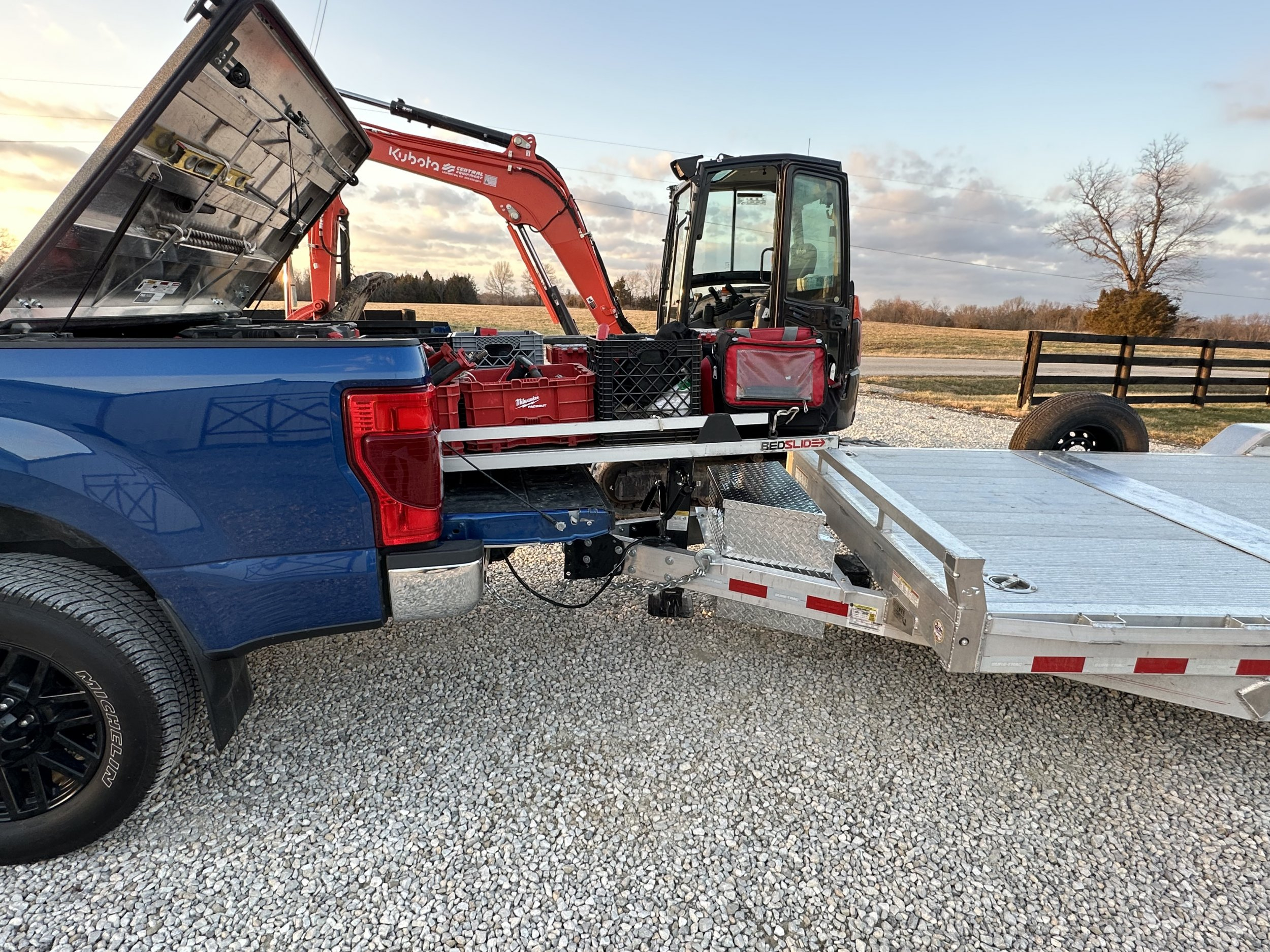

Got everything situated, set tongue weight to 1380, and figured out the best way i could strap it, the little swivel D rings they put in are crap. The D will eventually pull off its retaining shaft. Had to use rub rail/stake pockets. They seem to hold up just as good as regular steel ones and i cranked til i couldn’t. I have a fab shop a few miles down the road, who incidentally happen to be a sure-trac dealer and will have them add some sort of heavy d ring if rub rail seem to fail. Would have bought from them but there was no delivery date sure-trac could give. Drove to the cat scale today and not surprising I’m running out of payload. I unhooked the trailer so it was a separate weight and it came to 13800lb. 200lb shy of gvwr. Only thing else going on trailer is a 20lb aluminum tongue box. Excavator has a full tank also. My last trailer had a gvwr of 14900, but i derated it to 14500, it weighed 4400lb which technically gave it a payload of 10100lb. I was putting 12k on it. Zero issue and pulled great, but, you know….
Was still bellow 26001 just couldn’t deal with being technically overloaded. Didn’t need that responsibility issue. This thing is light, I’m under its capacity and it pulls fantastic, which was a relief cause i was worried it would wiggle being it was a shorter wheel base.
Heres the worthless D rings

Here’s at the cat scale as it will sit, total weight with me is 23100, with other trailer it was 25400 without gravel bucket.
Also heres a vid showing the trailer and how its built. The axle housing is a galvanized steel setup, about 4’ span that the trailer is sitting on. I’ll keep up dating this with any issues, but so far it seems good. Not what i want, but it’s all uncle sugar says i can have without joining his…I’ll just leave it at that and say I’d much rather have a bigger, heavier trailer. i hate the fmcsa and the arbitrary numbers and laws legislators pulled out of their rears.

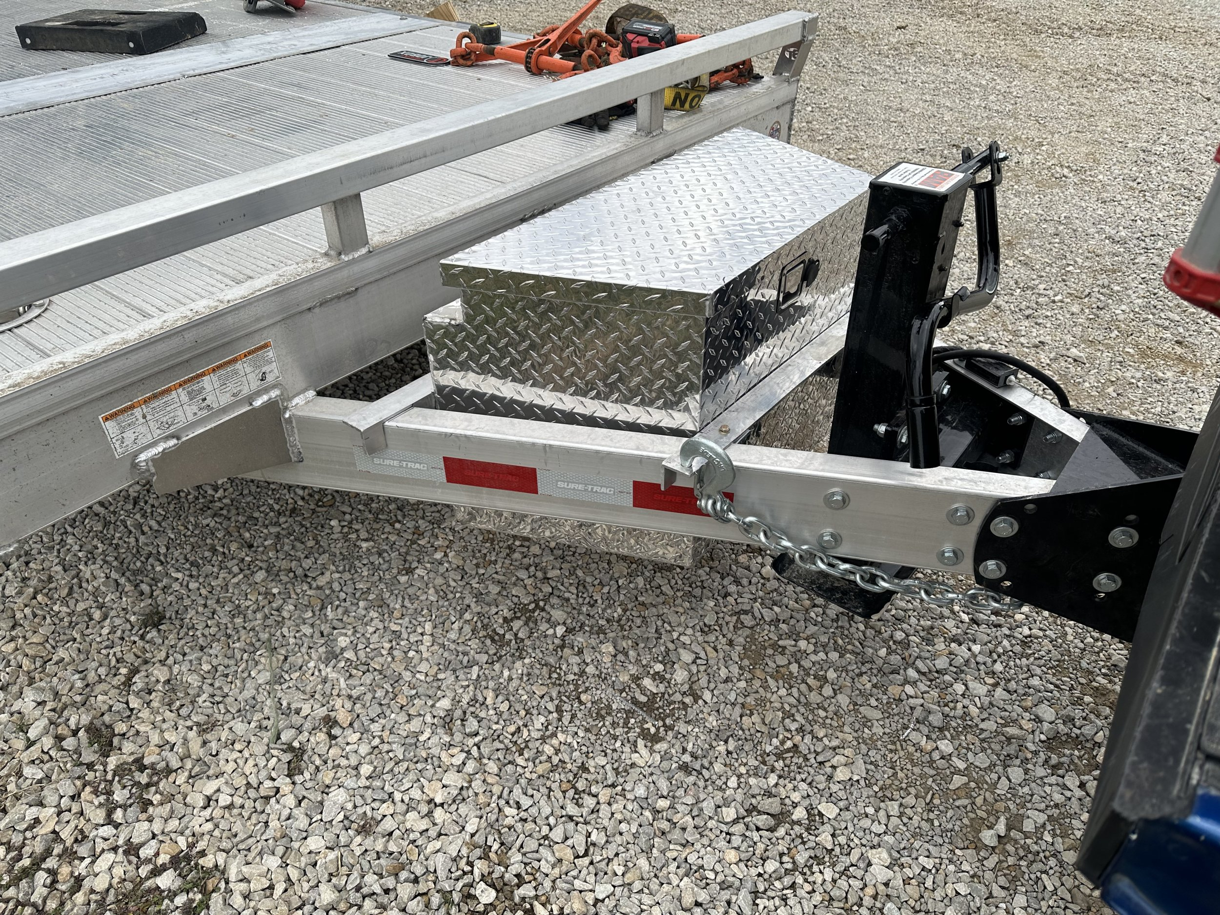

I got the cheap tool box mounted on tongue. I DID NOT want to drill the tongue. So i cut some square tube up and cut some slots to set on tongue. If it was steel i would have drilled or welded to fit it up, This being aluminum, i feel as though i have to treat it like an egg. Was able to add hook storage holes.
This trailer is low enough i can access my slide out wile hooked up, other trailer had spare tire and jack in way.

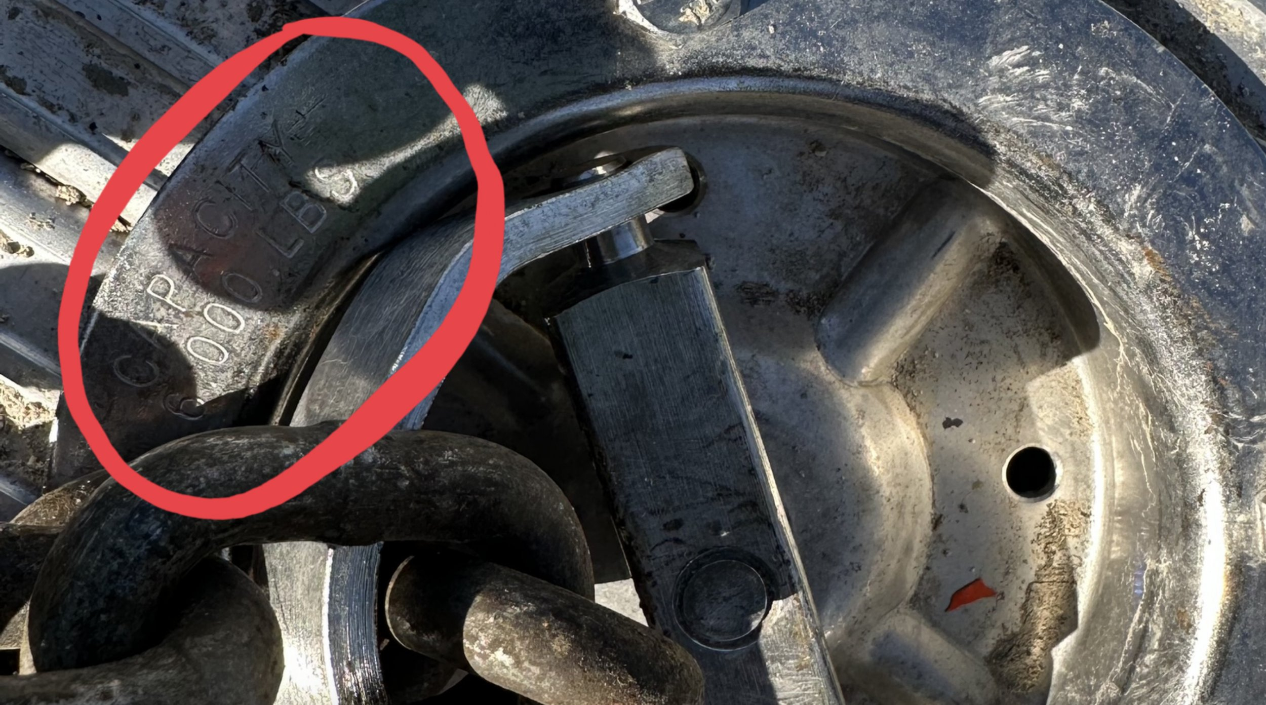

Hershey - I think you misread the D ring stamp. It says 6 000lbs. Must be 6 pounds. I would say it's safe even up to 12!
The set-up looks good, and I was going to ask if you could put the extra bucket in the bed of the truck, but I see the slide-out and load of tools. Question for you: When you weighed the rig, did you have all of your hand tools loaded as well?
/ Aluminum equipment trailers.
#77
Yes, when I weighed both mini ex and my truck were full of fuel and all tools. My extra bucket is a homemade gravel bucket and will go on top of my bed cover. It’s rated for carrying 1600lb on it. Diamondback bed cover. The bucket weighs 500lb, I’ll set it on a pallet.
