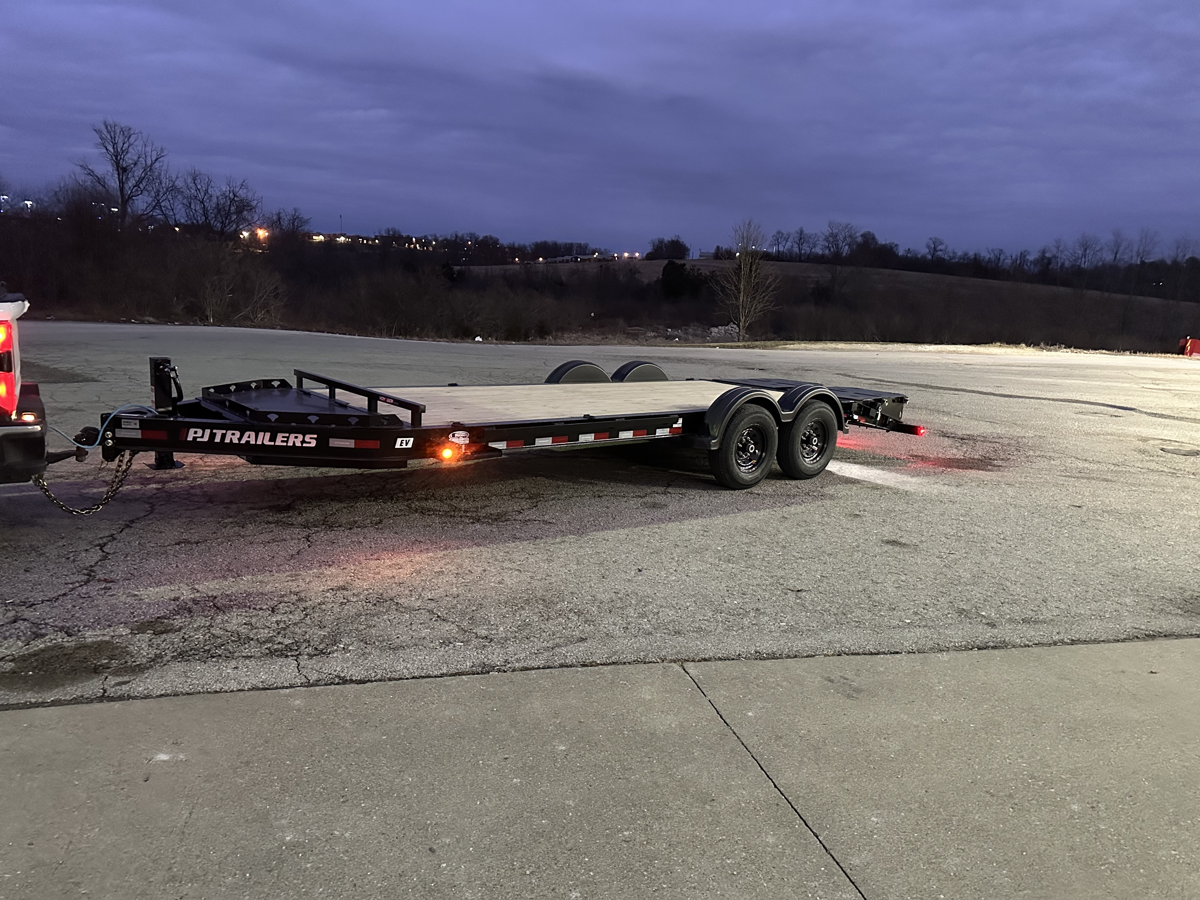

I fixed my aluminum trailer issue. I got a pj evolution. I know pj has some online hate, and probably justified. They got bought by big Tex parent company. My choices for for my payload capacity needs was between this and diamond c’s new line, baseline. It’s a 16k with a weight of 3100. This pj is 15400 with a weight of 3380. Convenience and price plus the ramps and tool box led me to this trailer. Welds are great, the wire harness is the new plug in solid kind, has nice max ramp style ramps and a great lockable tongue tool box, basically like diamond c lpx. Dexter axles. The tongue/main rail is 8” and 1 piece that bends at the tongue instead of being welded. This new line from pj is i guess their attempt at getting back to quality and competing with diamond c. With my excavator/truck/trailer and loaded i am at 24500. Also the fenders are a new plastic fender, very strong and easy replace. Little weight savings. They are stand on. Will keep this posted.

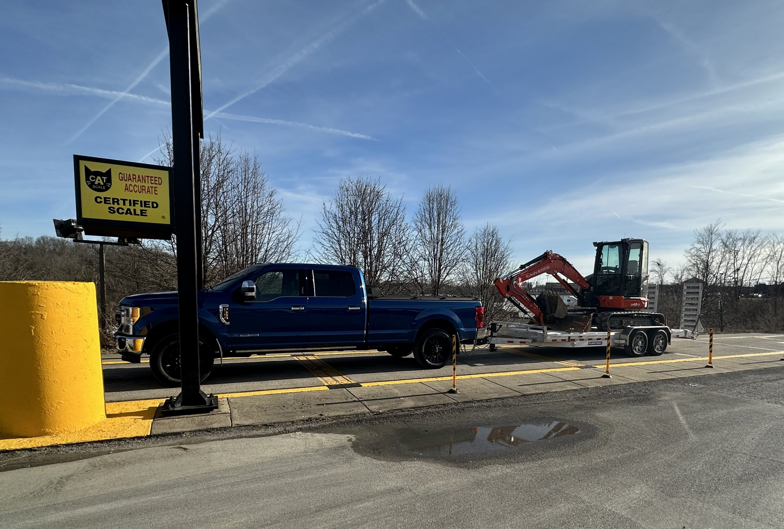

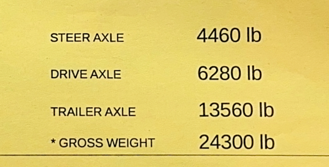

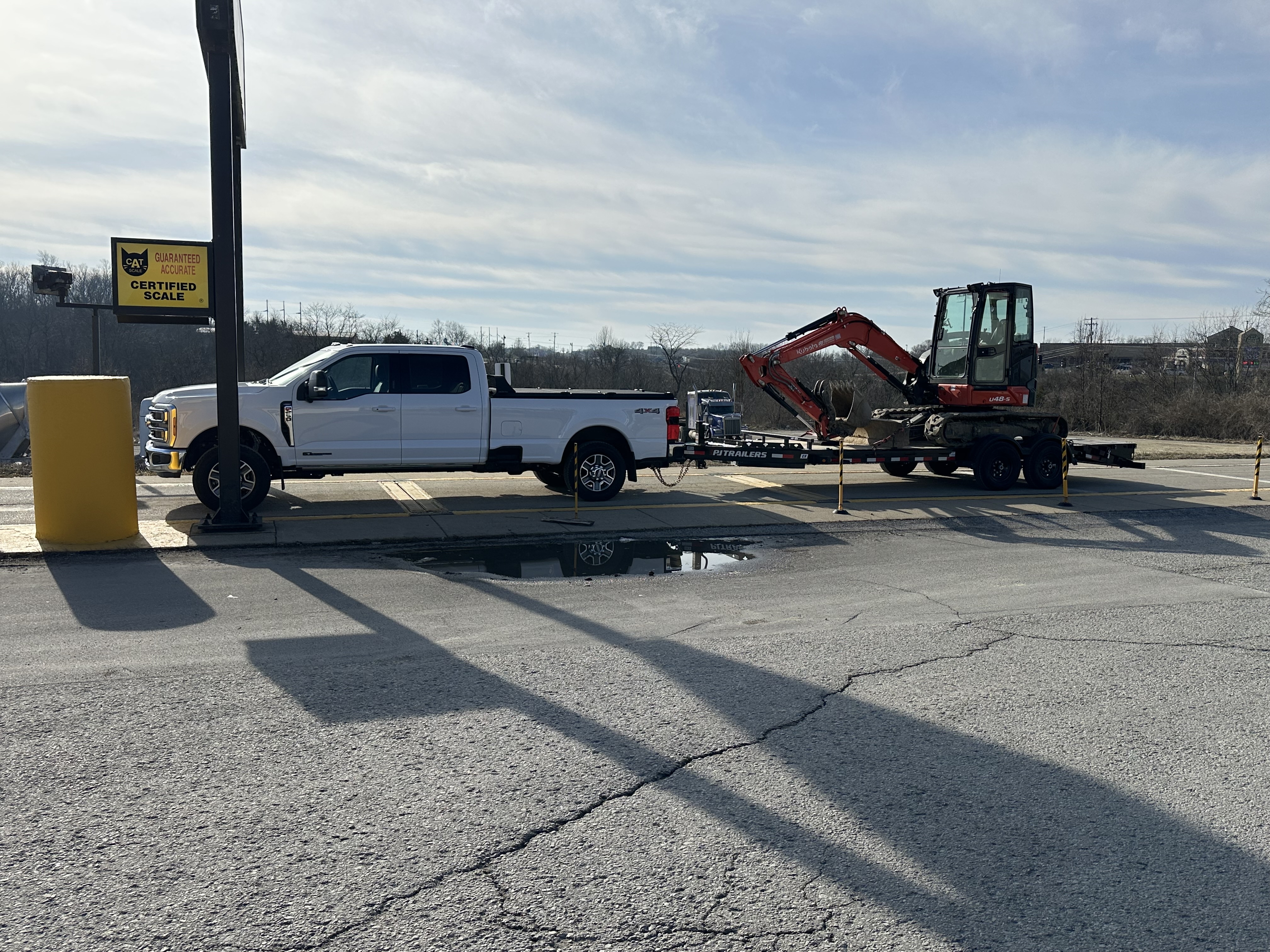

I got situated, welded on some d rings in spots I needed, set my tongue weight and scaled. It’s nice having a steel trailer again, especially with an 8” tongue and frame. Going to put 14 ply on.
/ Aluminum equipment trailers. #128
Was that everything full of fuel?
14-ply.....good tires. Just did it on my trailer. But will probably add another 200# to your weights.
Dont leave much room for other stuff, extra bucket, tools, etc. You flirting with the 26k mark

Yea full fuel, i doubt the 14’s are 200lb more, 40-50, sure. I have a 600lb gravel bucket i may start back taking. Plenty of room.
