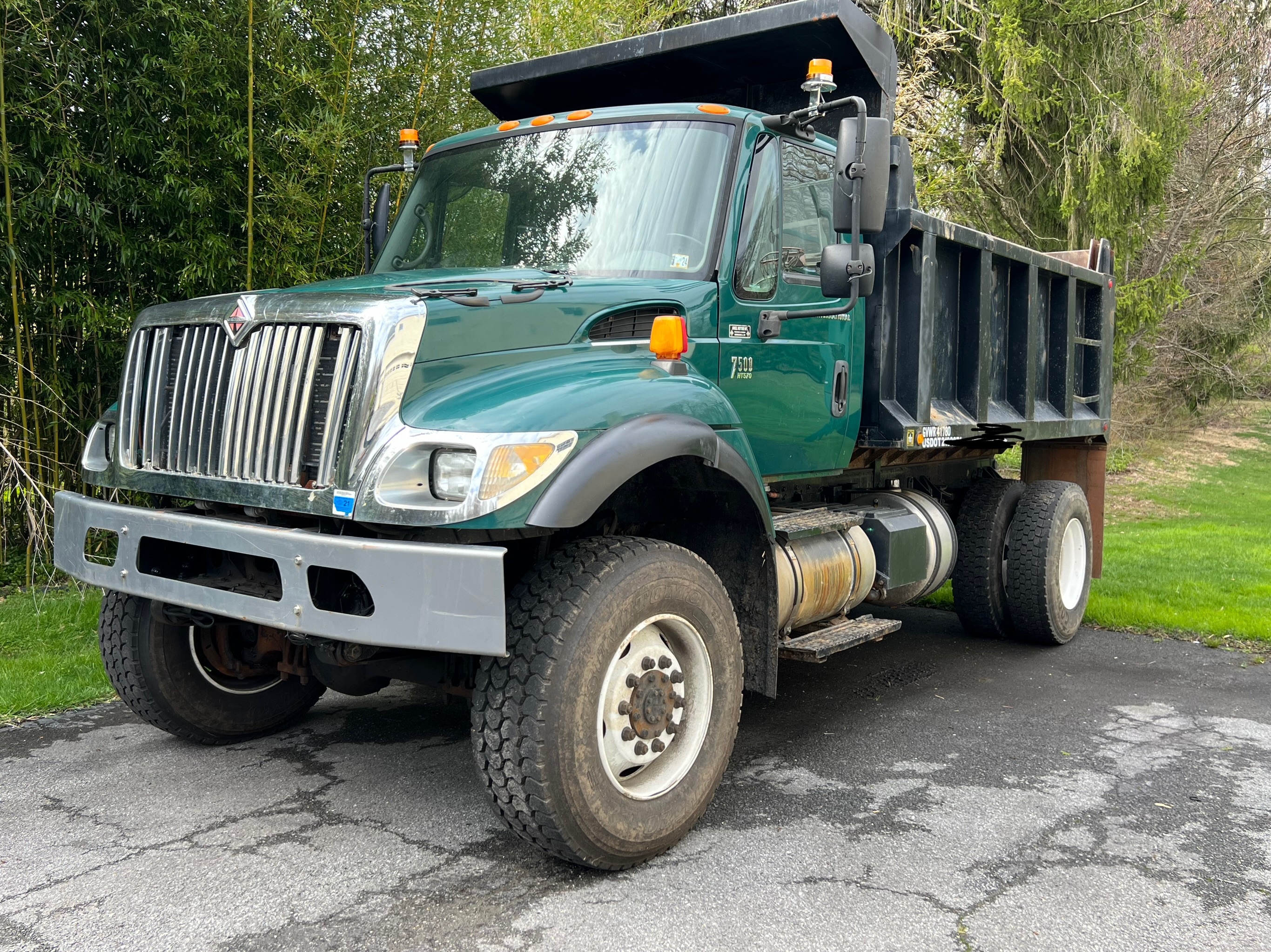

Thinking about selling dump truck and buying dump trailer
