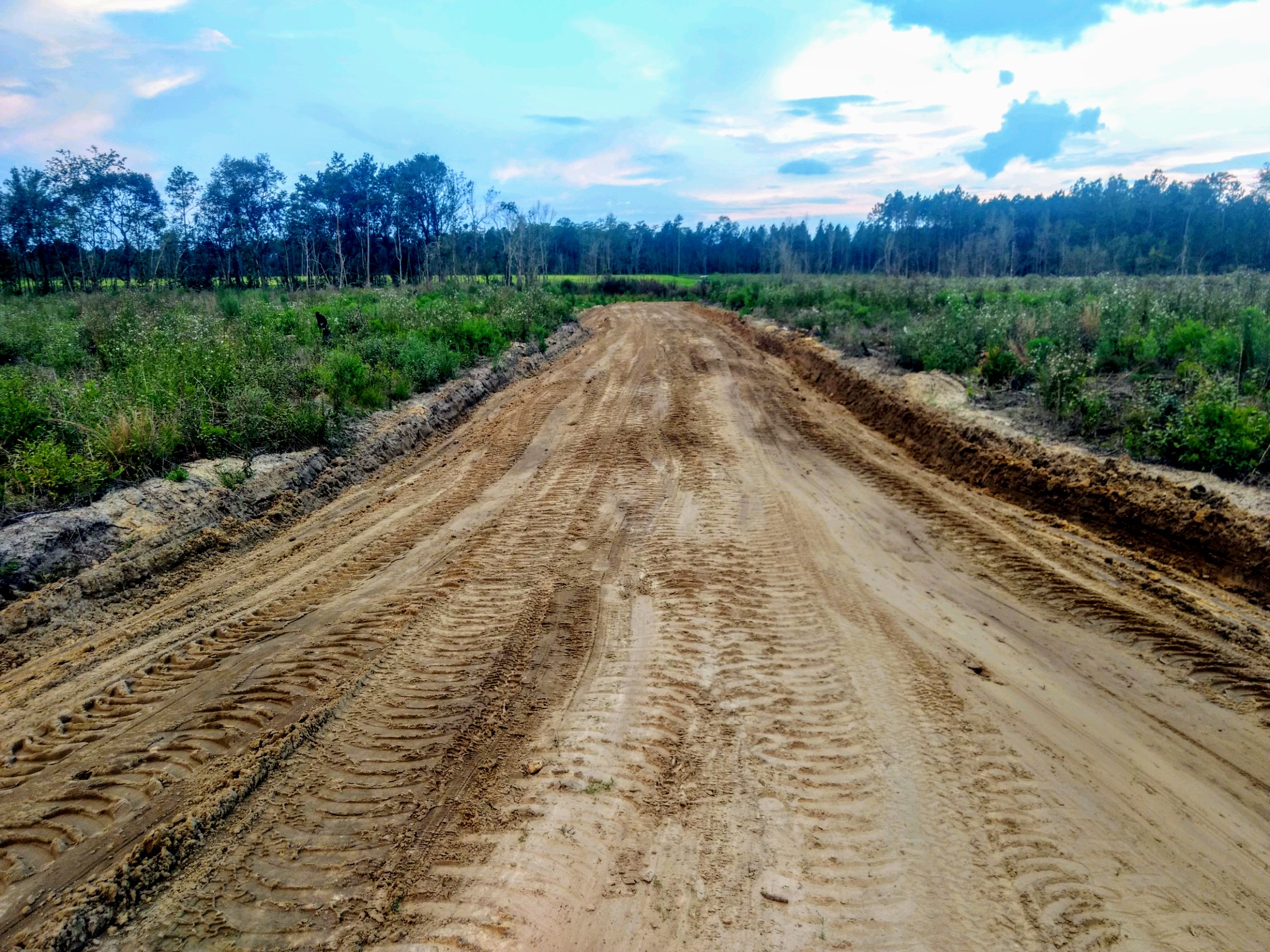

Depends, does your tractor have draft control? I think that it does, but not sure. Learn to use the draft control with your blade and there is no need for gauge wheels.
What would draft do when pulling dirt leveling a road? I mean I understand draft control, but maybe not in this case. If the blade come into contact with a high spot with draft set wouldn't it cause the blade to slightly rise up from the pressure leaving the high spot?
/ Advice on Grader/Scraper blade #46
It would if you have it set that sensitive. All I know is what MY Mahindra 7520 will do and how it can be set. People think that when using draft control the blade raises inches to get through a tough spot. I suppose it would if it were a rock or some immovable object. But when working with ground that is simply hard and soft in areas it raises 1/16"-1/8" at most and allows the machine to continue on. That is if you have everything set properly.
So much of this is learning how to make FULL use of the features that your tractor has and how they react to different circumstances.
I can go over a mile and never stop or adjust the blade. It's all in learning what the machine's capabilities are and do your best to not exceed them.
As an example, there are parts of my road that don't get used as often as others. I could set the blade to make a 3" cut in that area and the machine would do it no problem, but if I had it set for that much of a cut and then got down to the area where I can only make a constant 1"-2" cut, then yes the draft control is going to raise up quite a bit. So either something has to be reset or I just set it for a lighter cut from the start and go on my way.
From what I have seen over the years, a lot of people try making a deep cut to move more material and then have to spend half their time fixing what they made a mess of raising and lowering the implement trying to get the deepest cut that the machine will do at the time. When what they should have been doing is taking a third or maybe half of what they were trying to cut.
A lot has to do with experience, but so much of it is common sense and knowing what the capabilities of the machine are and how to make the best use out of those capabilities. But then that comes with experience. ;)

I could see it helping going from compacted material to soft where the blade could just bury itself. I think I understand what you are saying, I use draft & position with my disk harrows when trying to light disk broadcast seed in to where it is more less just dusted in under the dirt. No matter the ups & down in the ground it stays the same & harder to softer material. For the most part, maybe a 1/2 difference which is much better than 3-4 without draft. 8 acres I just planted in Brown Top Millet.
I'm still a little unsure though about the mechanics of how it will work to keep from having hoops with draft moving even though we are only talking fractions of an inch, but I know the position of the top link on the tractor influences sensitivity & reaction speed of the draft function as well. I have plenty of grading and practice to do here shortly so I'll give it a shot! Thanks
/ Advice on Grader/Scraper blade #48
Look at the pictures, zero wash board. In those pictures the variance you see is the color of the ground itself. The top link is in the most sensitive pin location and the cutting edge is set at about 1" down with the position control. I then set the draft control lever at that depth so that it will cut at that setting for the length of the road.

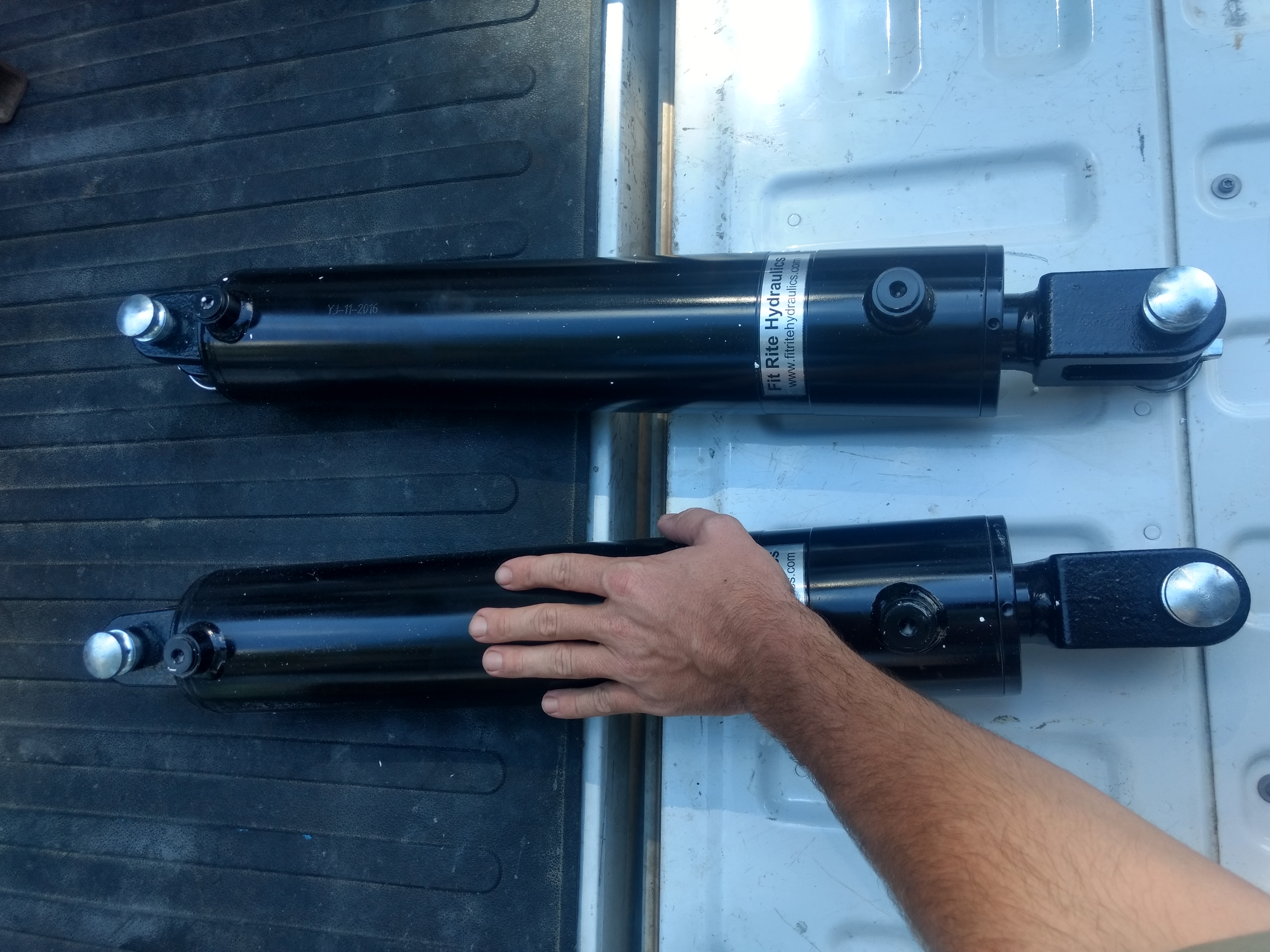

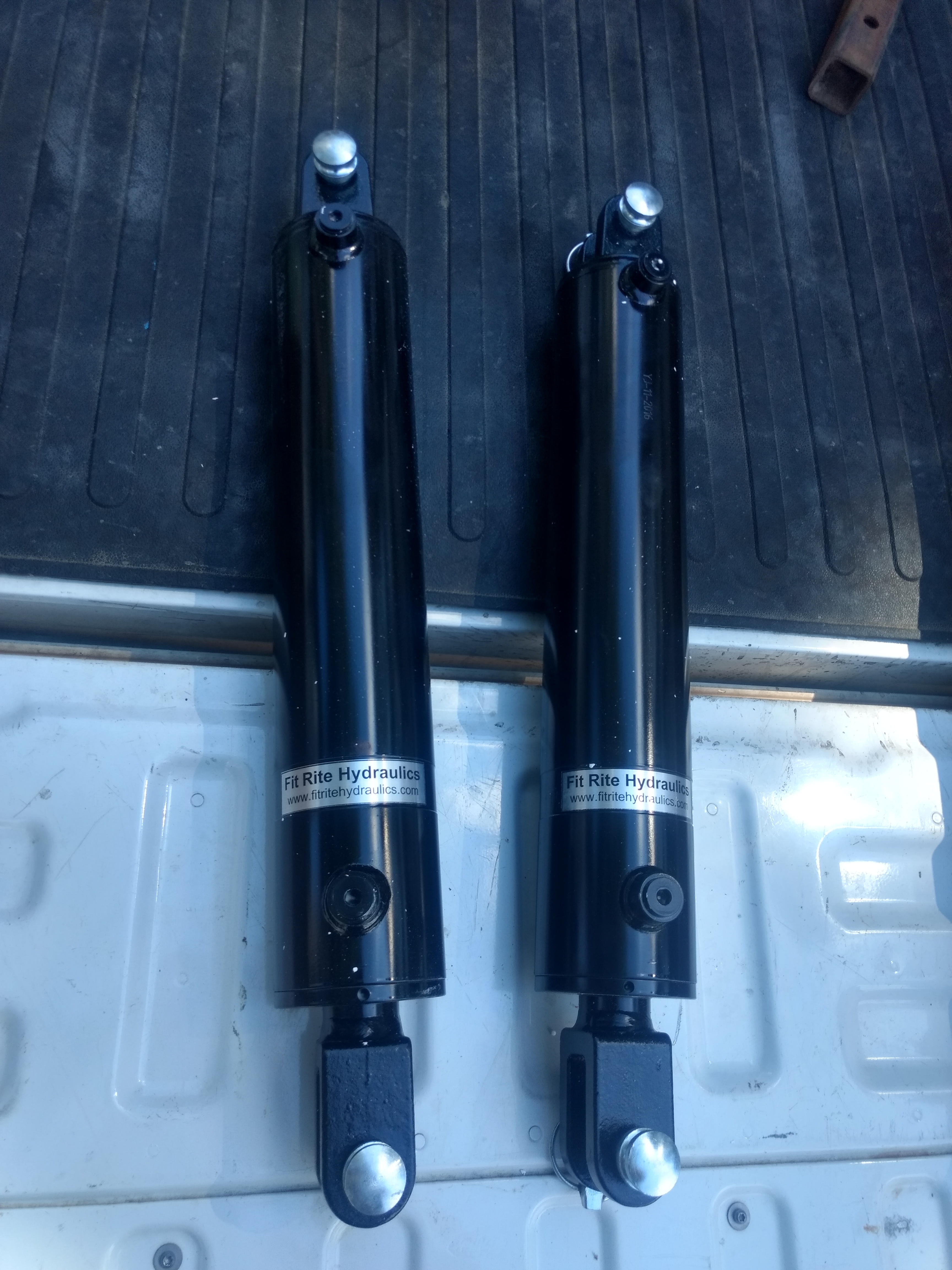

Look what the brown truck dropped off today :) Hoses haven't made it yet. I'll say this, I think cylinders being a weak point is no more, these are massive. Photos don't do justice but I put my hand on one for reference & I'm not over size man but I'm 6' 1" and fairly good sized mitts on me.
Going to drop them off with the dealer this week so they can install them on the blade when it comes in.

Must be for a 100HP tractor.

You would think so, but no I think Brian at Fit Rite believe's in what he says to sale a better product at the same or less. It was $305/ cylinder from landpride that are 1 1/4" rods that I'm sure would hold, but for $266.50 for a stouter cylinder, 1.75" rods, and support a TBN member it was a easy decision. Didn't know it would honestly be cheaper until Brian sent me the final quote.
I'll also say we have been discussing a hydraulic multiplier for my rear remote and from some pictures of my tractor he's given some great advice and ideas how to set it up and look clean. I'll be purchasing that soon now.
