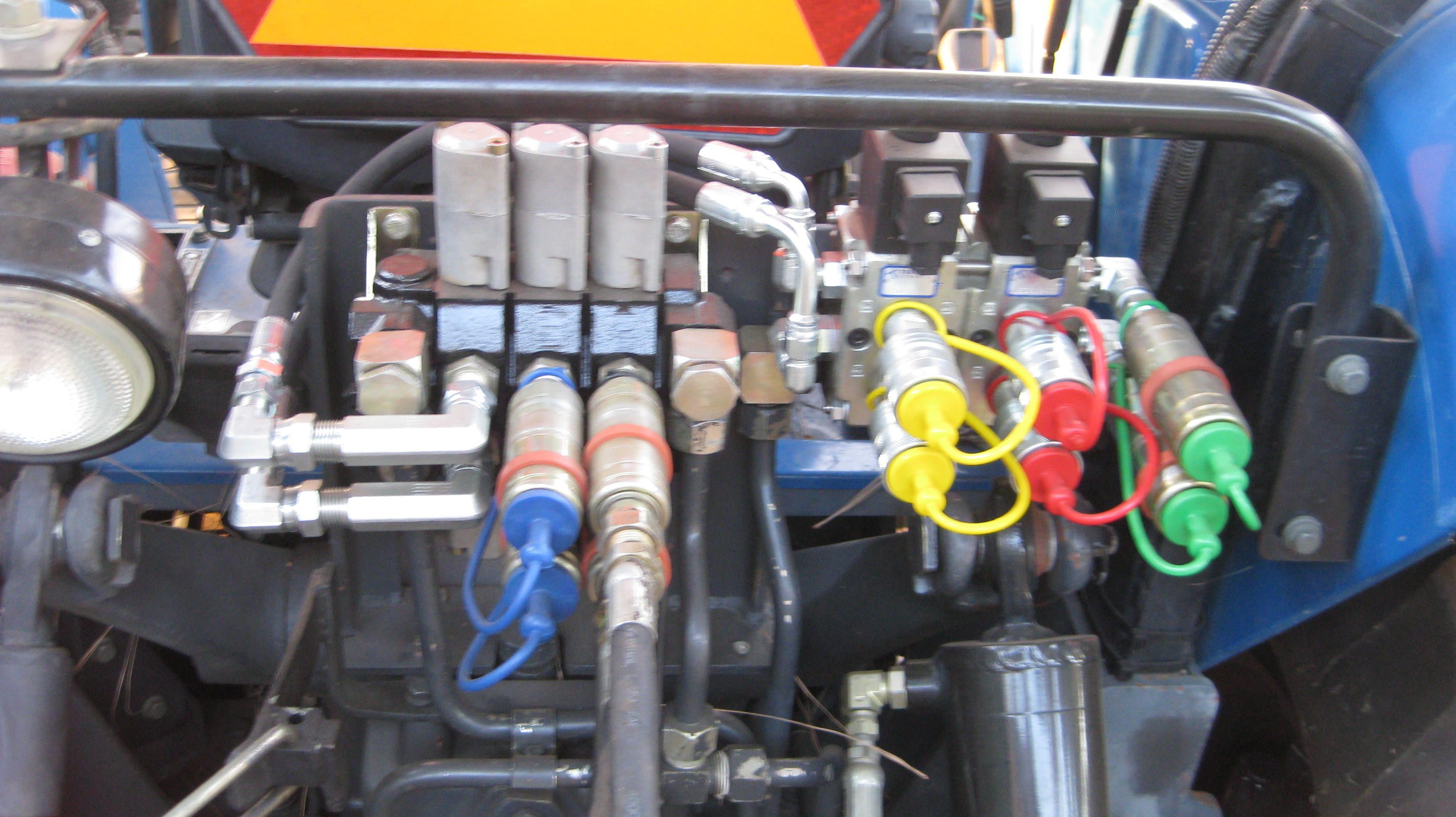

How many rear remotes do you have, 2? Pretty easy to bump that up to 5.
I added 2 diverters to my 75hp tractor. We can add 3 to your tractor. :cool:
I only have one, didn't think to have a second installed when I purchased. I talked with him today about adding a second and he said that would be about $1,000. But he mentioned I could hook the second cylinder up to my 3rd valve function if I didn't need to use that until I felt like spending the extra money.
What are the diverters? Ran tractors my whole life but know nothing about the hydraulic's of them.

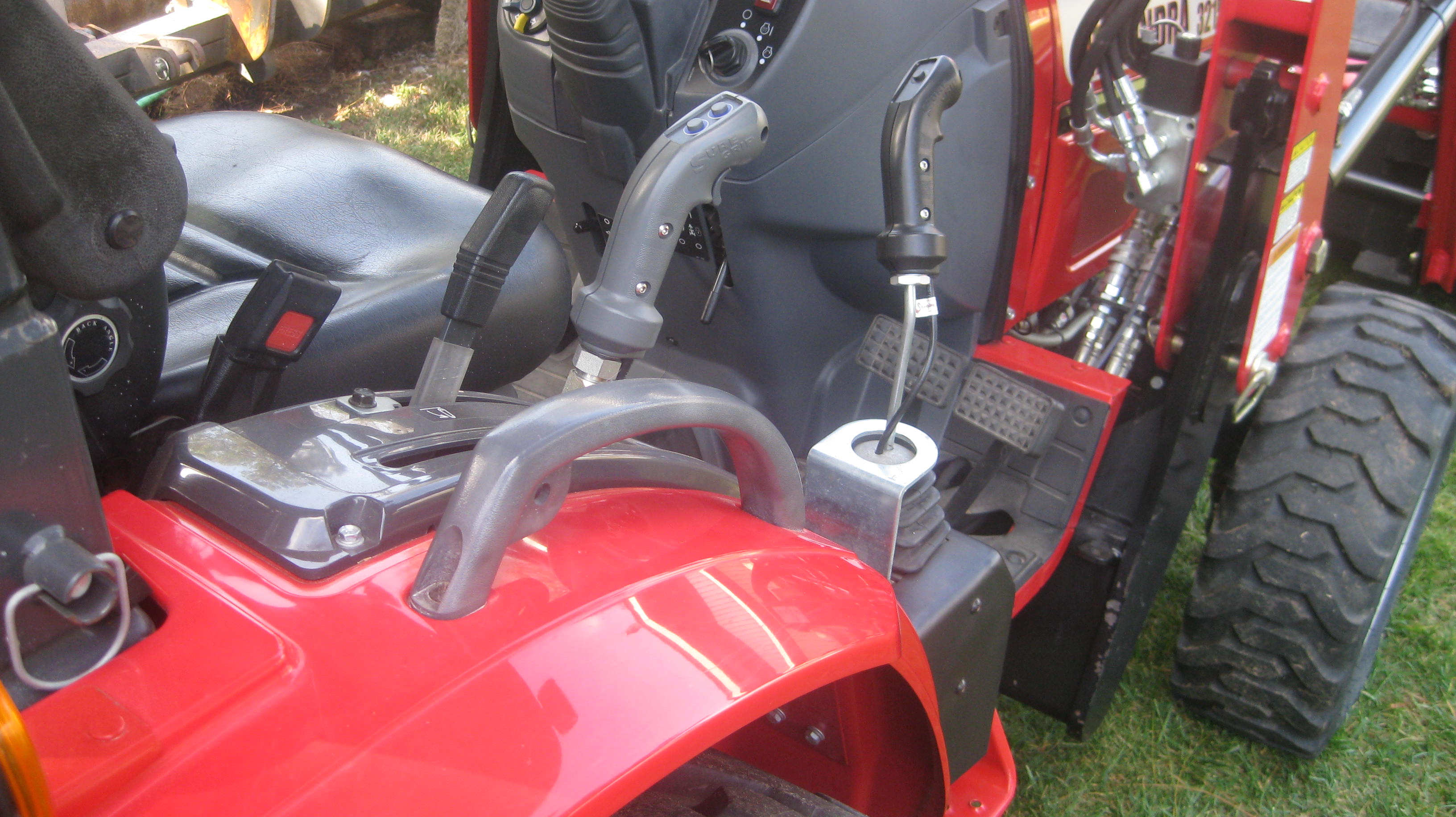

$1000 to get a second set is not what I would do. :eek:
You can use the single that you have, add 3 diverters for $1375 and that would get you a total of 4 sets of rear remotes, all controlled with the single set that you currently have. That is what I have on my smaller tractor. I had one and is all that is available for that model and I needed 4 sets. My previous post shows my 75hp tractor that had 3 factory sets and I have added 2 diverters so that I have a total of 5 rear remotes on that tractor.
First pic shows 3 diverters and the second pic shows the gray control grip on the factory control lever. The control grip has 2 buttons and a trigger switch to control each diverter. All pretty simply really. :thumbsup:

Thank you very much for the info! I'm waiting to hear from my dealer on the hydraulic's question about the angle & offset then I'll know wether I'm stuck with LP's or to get with you on ordering yours. I have some more questions about the diverter deal as well I will message you about.
