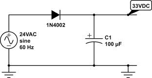

/ A Battery Rejuvenator #148
I believe it will be pulsating DC, not sure about the voltage.
Seems like adding a capacitor will increase the voltage.
Excerpt:
If one adds a capacitor to filter the output, the PIV doubles to 24 volts, because the capacitor now holds the output at +12 volts while the voltage on the anode of the diode swings to -12 volts
