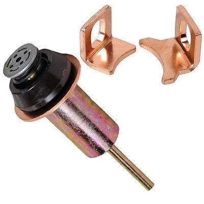

/ John Deere 950 no start condition #3
Common problem: The 2 contacts within the solenoid may be burned, melted, worn, or fubar'd. New parts and easy to change. don't need the plunger.
