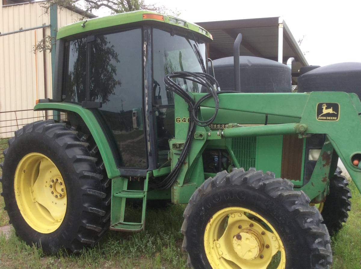

1993 JD 6400 4wd
Ok had some issues starting and we thought it was battery cables so we took them off cleaned posts and it worked for awhile then had issues again and would wiggle the four small gauge ground wires and it would start. When we had issues it would click click and then try to turn over but was weak. If you keep working the key it would finally just out of no where just fire off. Battery is good even jumped it and didn't make a difference. We followed wires back all the way to the starter and alternator and they are all i place. To the point now even trying multiple times wiggling wires or working the key off and on it won't go.
I am starting to think it might be the starter or solenoid? Do I have to remove the starter to know if the solenoid/starter is still good? Can it be tested on the tractor? TIA

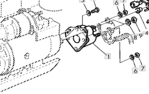

When you state shorted across with a screwdriver which solenoid relay did you short across? Item # 1 or part in shaded outline on starter?

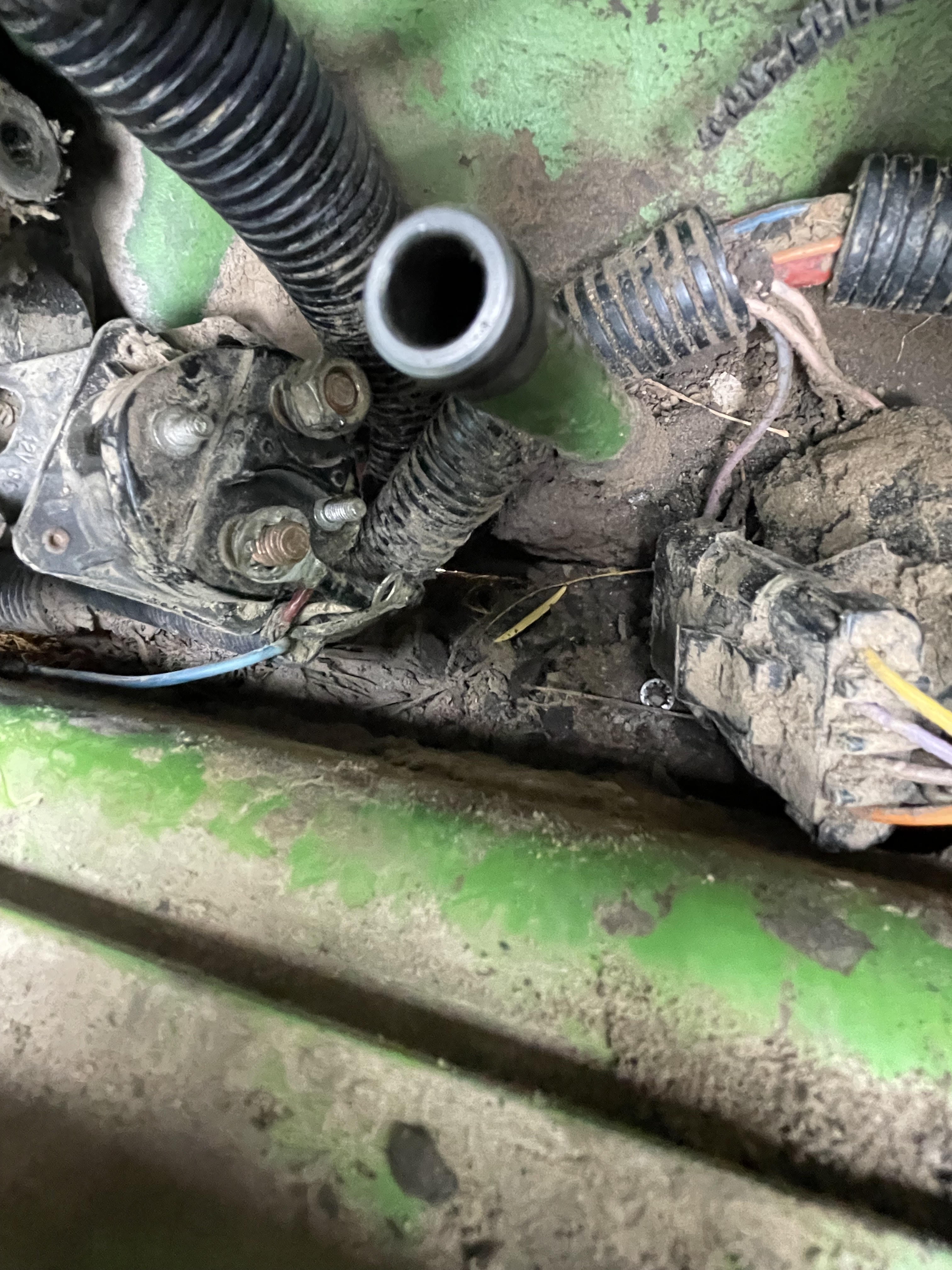

#9
two big studs/wires

The relay in your photo needs to have a ""good ground connection to frame to operate correctly on one small terminal"" & 12 volts from ign switch on other small terminal when ign switch is moved to start position. The larger posts on that relay provide 12 volts to "S terminal on starter solenoid" when ign switch is in start position..
