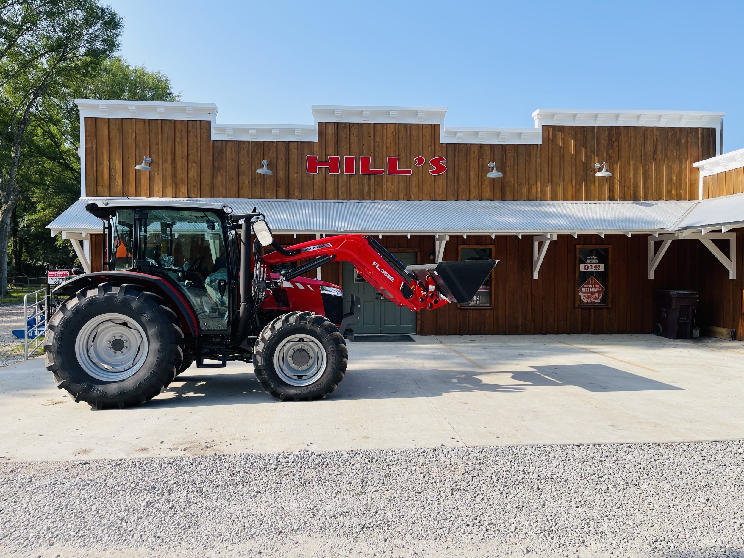

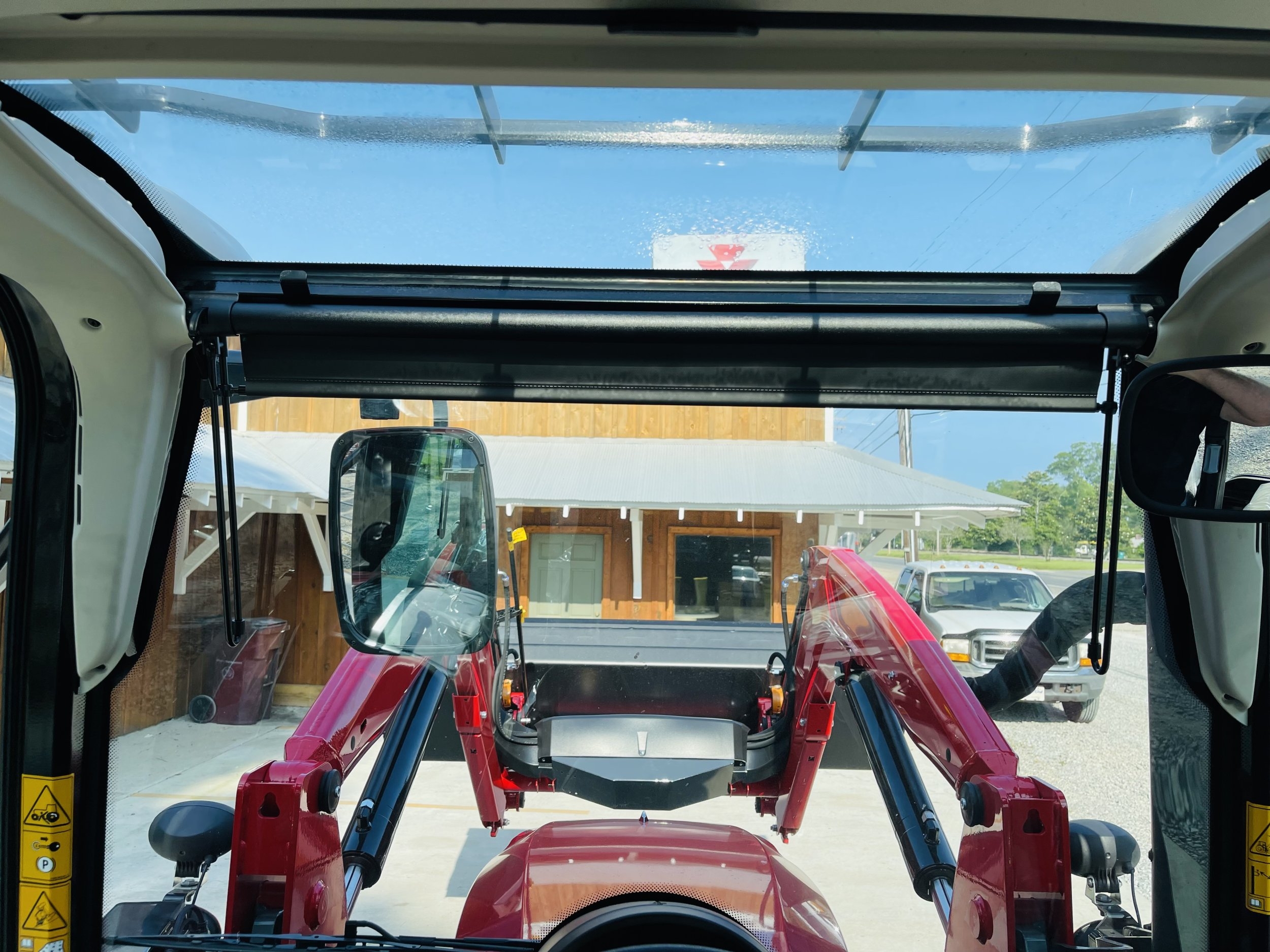

Hills Equipment in Livingston, LA has one with the Visioline Roof option. It took 2 years to come in.
