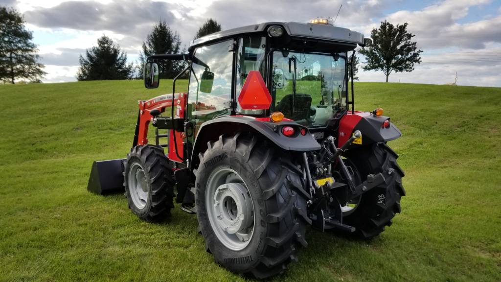

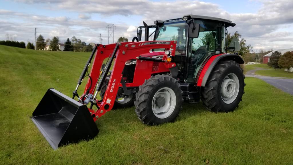

I have had mine for a month. Absolutely love it. Super comfortable, fit and finish are excellent. Visio roof is awesome and is steel reinforced.
I bought mine with deluxe cab, 3rd function remote, Visio Roof, 936x self leveling loader, wheel weights and front Fenders( not yet installed)for $45200 (tax exempt) in Pa.
A few pieces of advice:
1.Set the auto RPM setting to 1200+. There isn't much torque below that, so I set mine to 1200 after startup.
2. Set the turn stops in so the turning radius is good.
3. Remember that it will not get full power until it has warmed up.
4. Transmission is super smooth. It actually shifts best using the button on the shifter.
If you have any questions, give me a shout. You are going to love the machine.

Thanks Dave. Sounds like you found a sharper pencil than mine, we both have front grapple hookups too. Those mud flaps were quoted to me at 1400 bucks, I passed. Don't have much mud or do much road work, pretty sandy here.
My dealer threw in a new genuine bush hog at no cost since I was trading in one I bought from him earlier this year, just going larger all around.
So there were some other incentives.
If I had wanted to buy a Kubota again, I would have considered going to PA to Messicks. But my local folks have mechanic problems and
can't fix things right the first time. Not being a mechanic I need a good local dealer.
