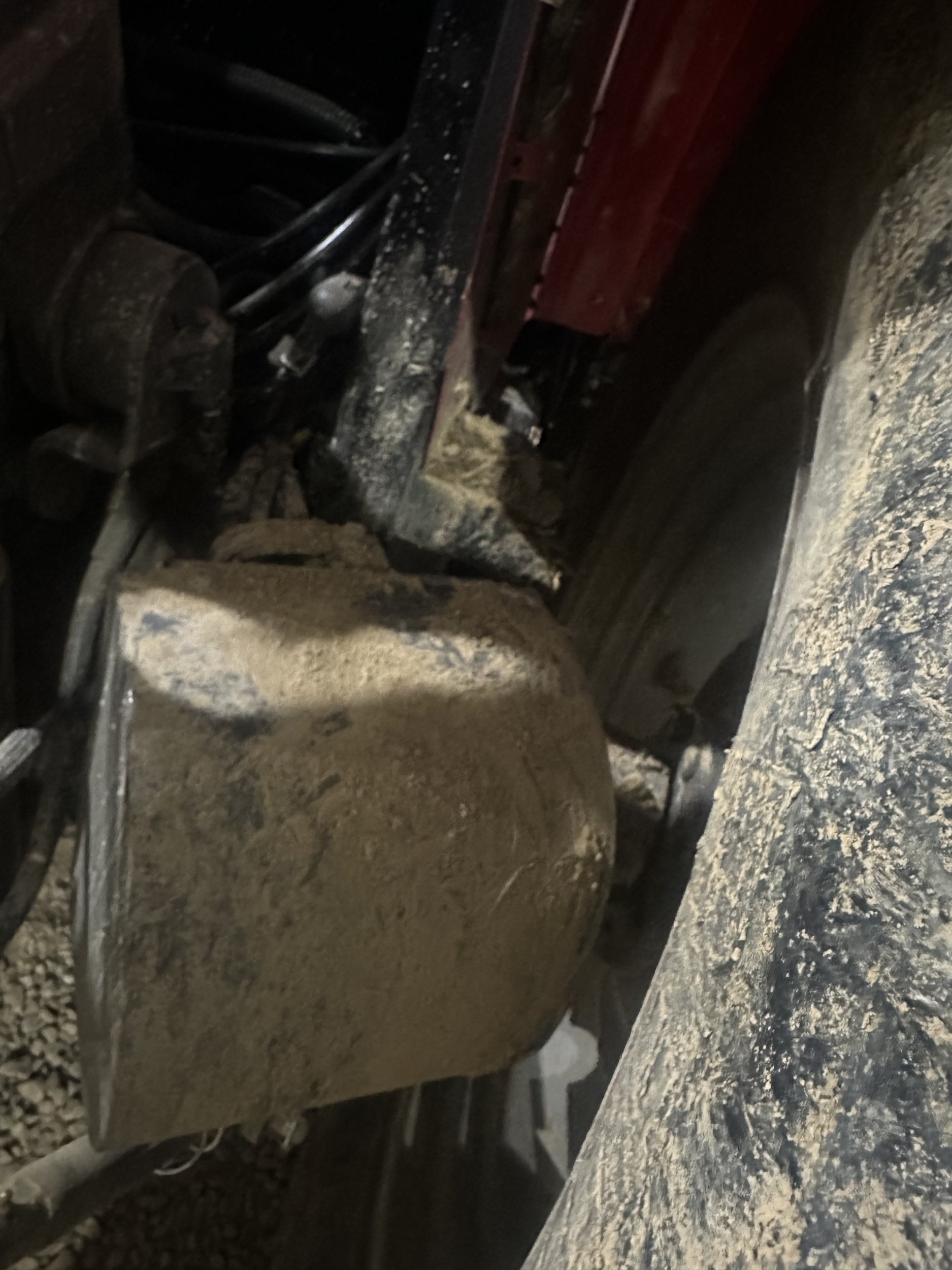

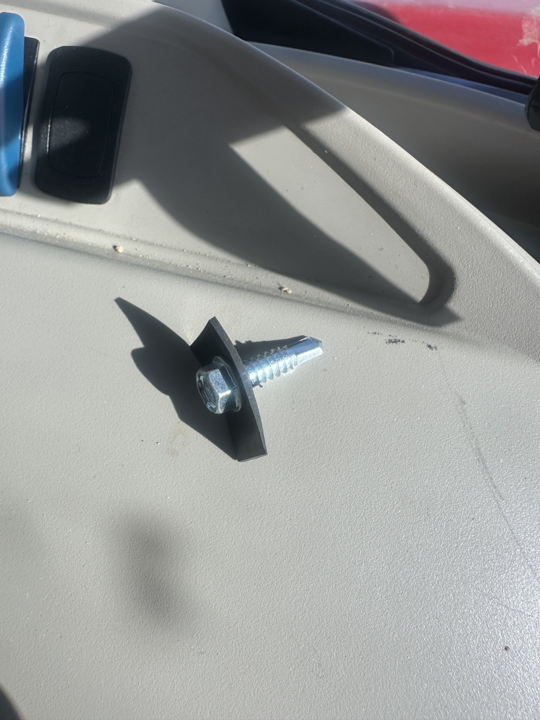

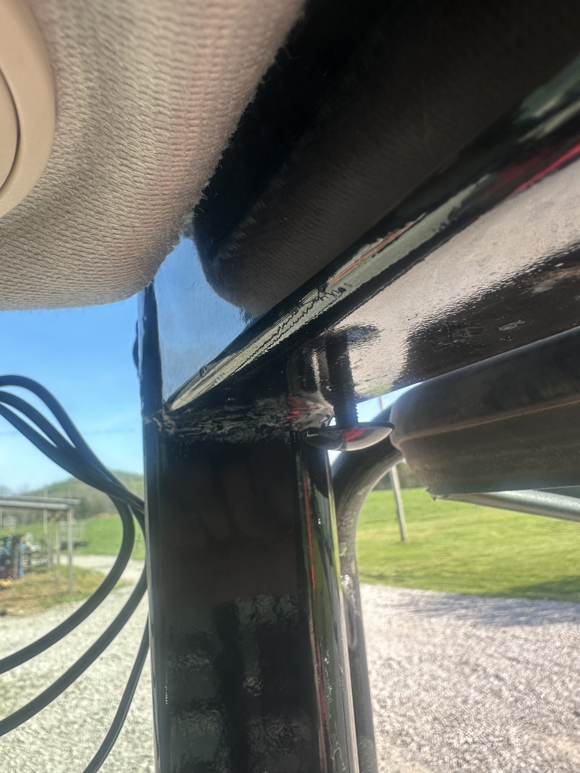

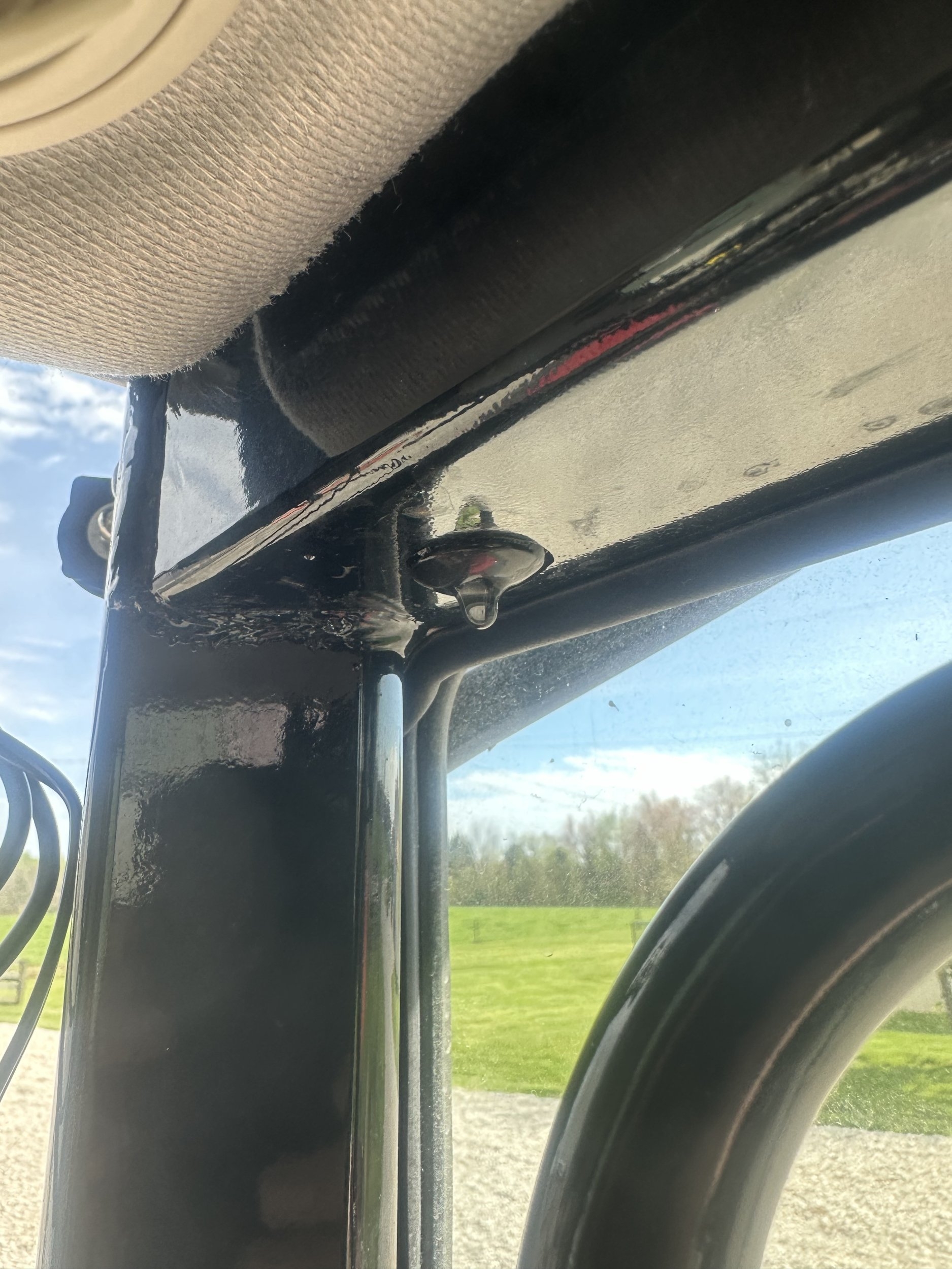

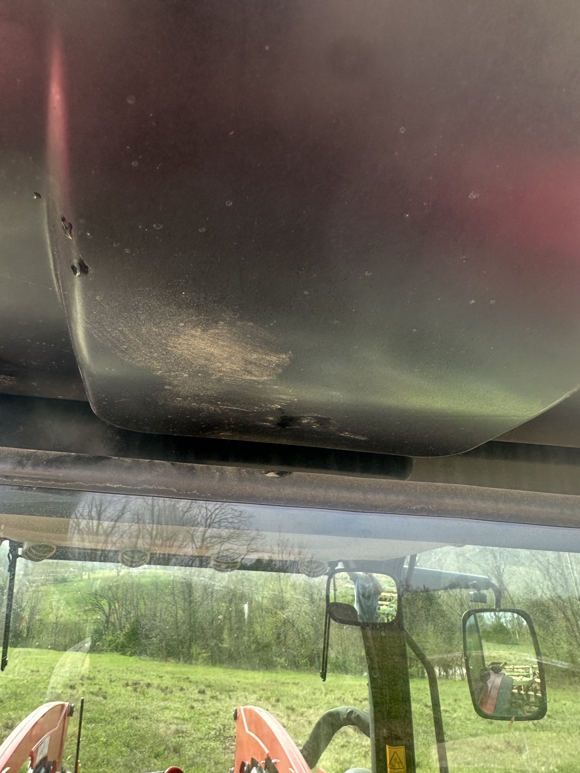

Eddie did they get the ac leak fixed? My 5711 is dripping too. I think it’s the ac lines condensation inside the frame. I’m going to temporarily fix it with screws and rubber washers. Don’t want to permanently fix it til I know how much water there is. There is also a hole in the bottom of ac pan outside above back window that drips on to window. I’m also going to re-run the fender drain so it doesn’t drip on my def pump and keep it a mess.

I wasn’t a facebook member but joined to try and join that group. Ac does work good and pretty sure we have the same unit. Yesterday at about 84f I was reading mid to low 30’s with the occasional 25f which is probably right before compressor is kicked off. This is with a Milwaukee ir temp gun. This is why I’m rerouting the main ac drain, when working dirt it keeps mud caked on the axle and def pump.

often issue is just chaff/dirt/bugs clogging up a drain hole, happens in rv's too.
