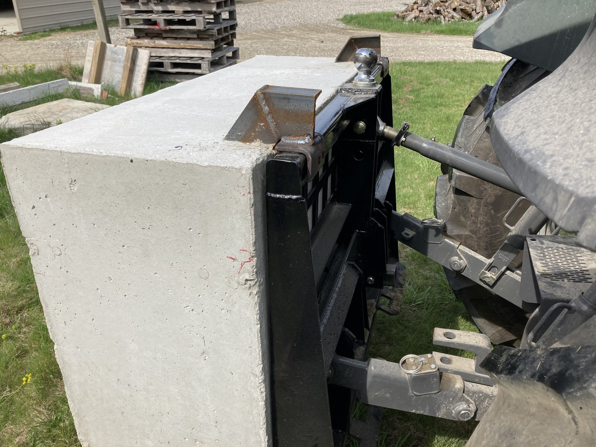

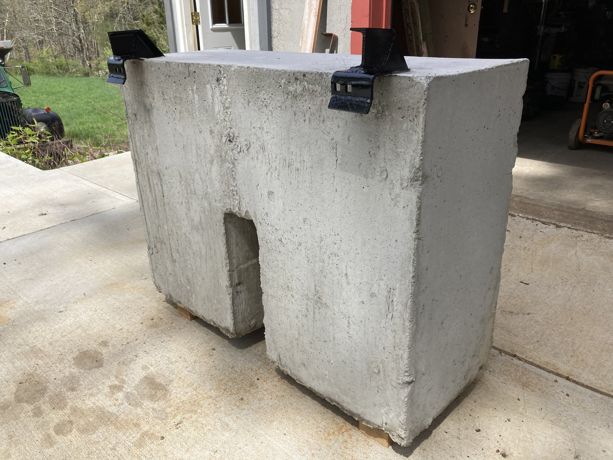

I made a new counterweight for my 4707. Quick attach style. 2,600lbs.

Man that’s an anchor, very nice work 👍👍. You’re front axle will thank you when doing heavy loader work
I like your quick attach method for connecting to your counter weight.
What loader do you have and what are you lifting that you need so much weight on the rear of your tractor?
I have the basic 931X loader. I usually have my hay spear on it and my bales are anywhere from a thousand pounds at the biggest, to 750 pounds for the smaller ones. I don't have wheel weights or anything on my 4707 to counter the weight. I've never thought it needed it, but I'm curious what the benefits are?

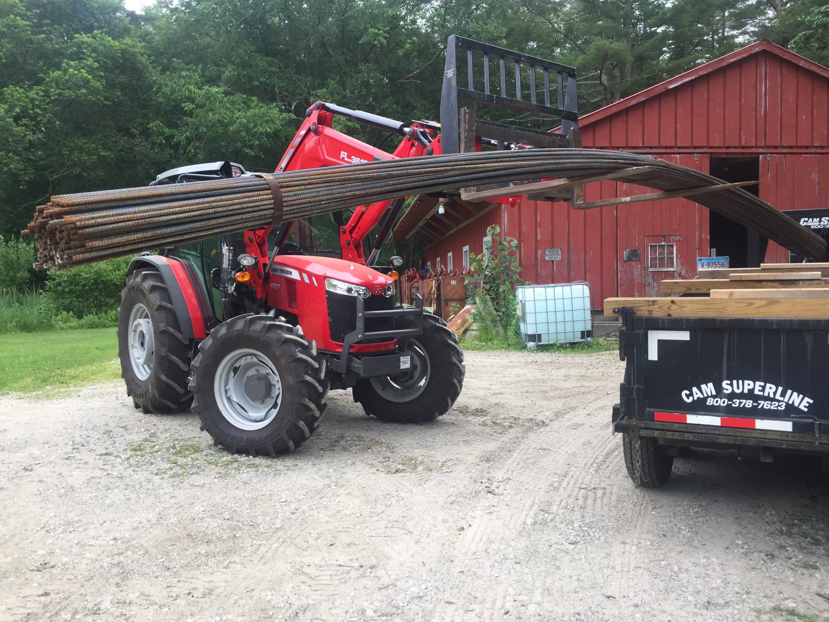

My 4707 has the FL3615 loader, which has a rating of 3,400lbs. I routinely lift and move 2,000lbs with the loader and many times fill the bucket with gravel or loam and that must run 2-3,000lbs. Even with just 2k, the back end is light and forces me to engage 4wd.
