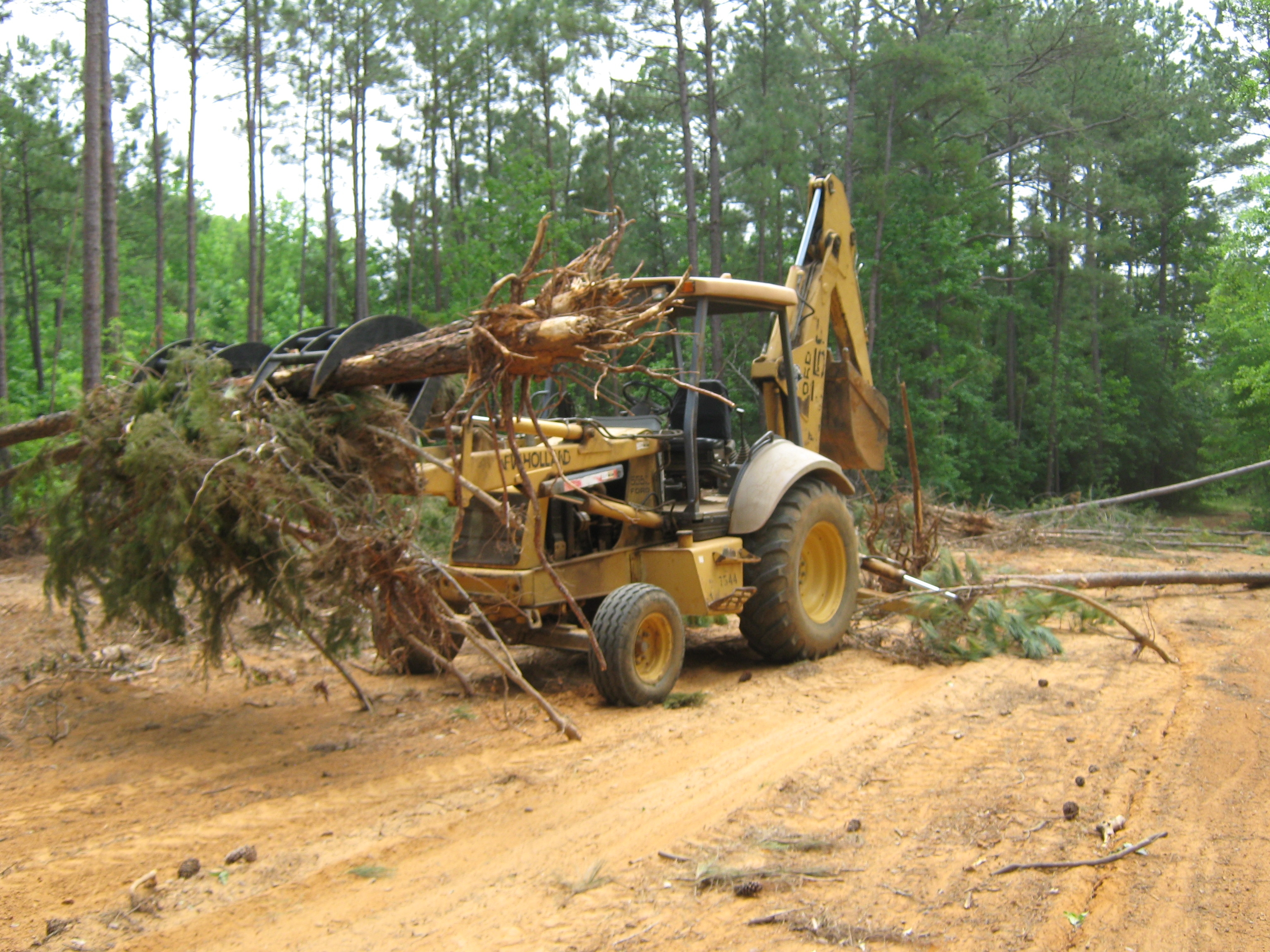

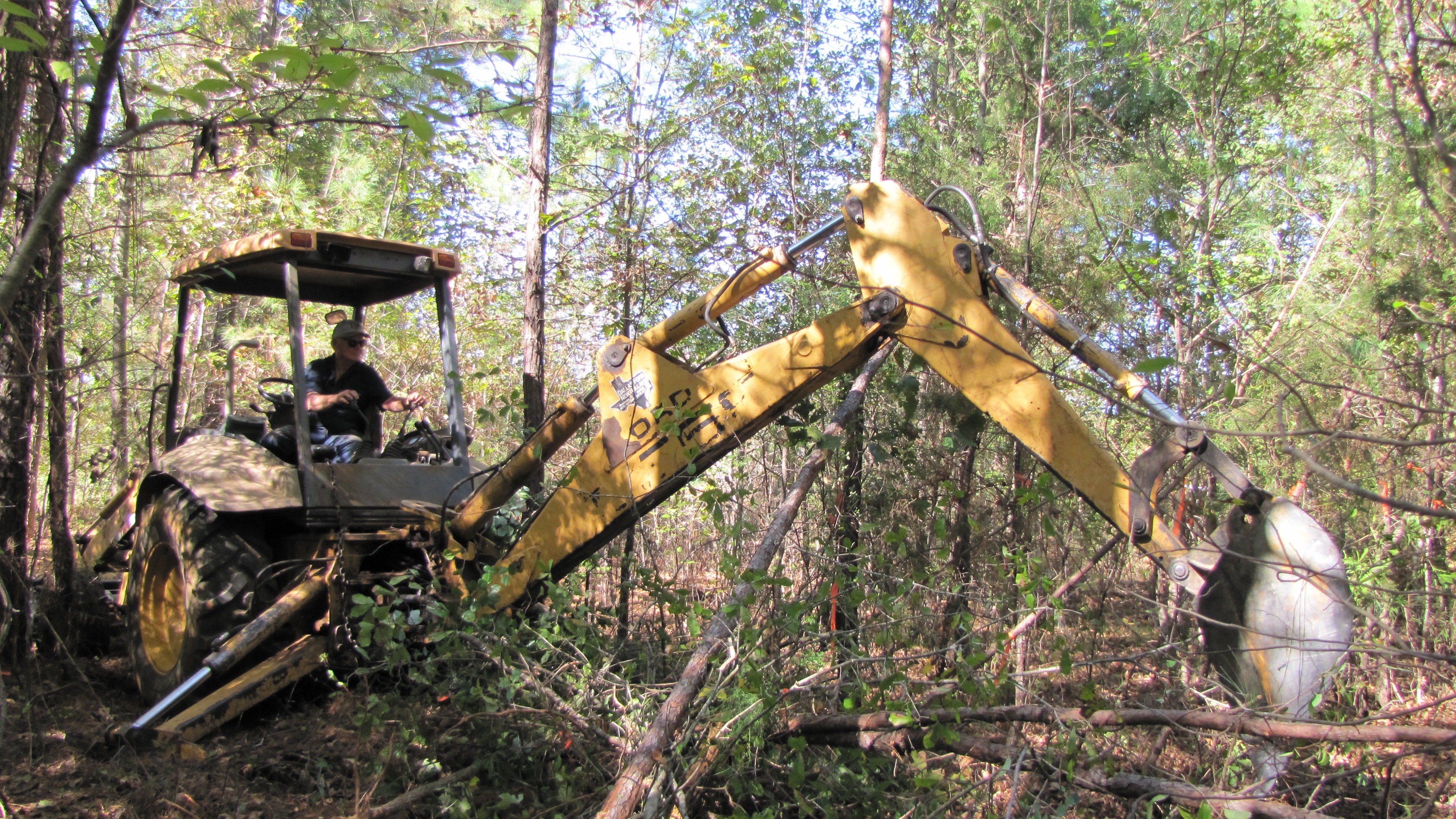

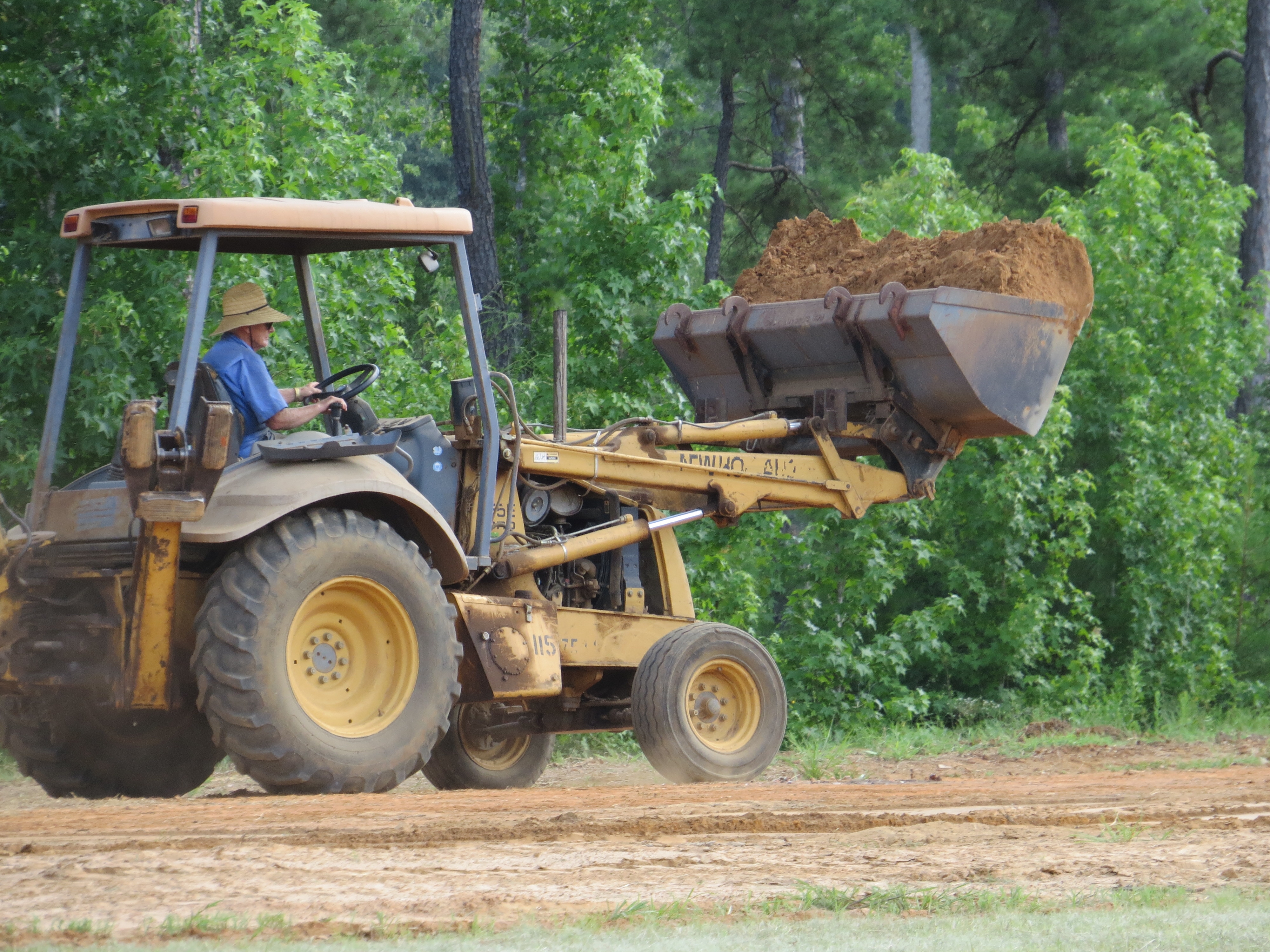

I bought a used 1998 2wd open station full sized New Holland 555E for clearing my land. The loader is night and day better than the Massey or my 5065E Deere. The bucket holds a Yard of dirt, and it's rated to lift 6,000 pounds. Being able to dig up stumps, take out entire trees or just pull apart a pile of logs is easy with the hoe. Digging anything is easy with the hoe.
I modified my front bucket so it's now a Quick Attach. I have pallet forks for it and a grapple. The grapple was the big game changer. I can dig out a tree, then pick it up with the grapple and carry it to the burn pile without getting off the seat. A 4 in 1 bucket would be even better because I could haul a bucket of dirt back to the hole from the tree and fill it up. Now I use the Massey for hauling dirt to the hole so I can leave the grapple on the Backhoe.
