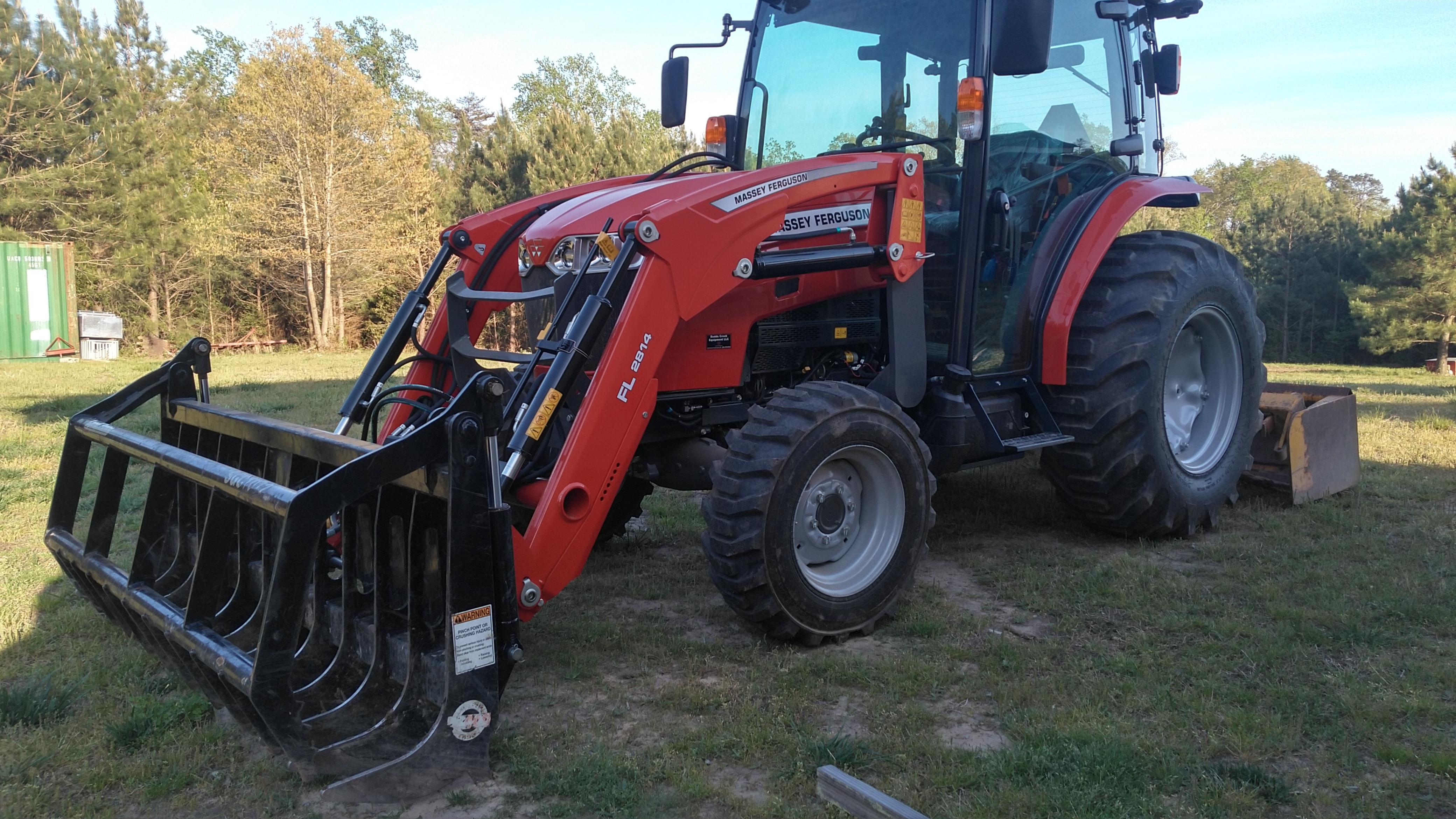

I honestly think the MF 2850M/2M50, or 2860M, will do 90% of what you want, without being unwieldy. If there is 10% that its just not enough machine for (im assuming that means clean up), hire or rent. Dont know what you are saying on your mill, but 2570# at pins/1880 at bucket edge; probably about 2250 with forks, is a good sized log. You probably arent saying 30 ft whole logs, im assuming you saw 12/16 ft logs.

I am not saying skid steers dont have a place, but the bullet points for our OP, IMO, really seem to point to a 2860M class machine. Enough power to run a good sized bushhog, disc, strong enough to move logs to the sawmill, and grind stumps.
My Only hold back on that, the slash clean up, if thats tree tops, fine. If thats root raking, thats a JD 544 wheel loader job

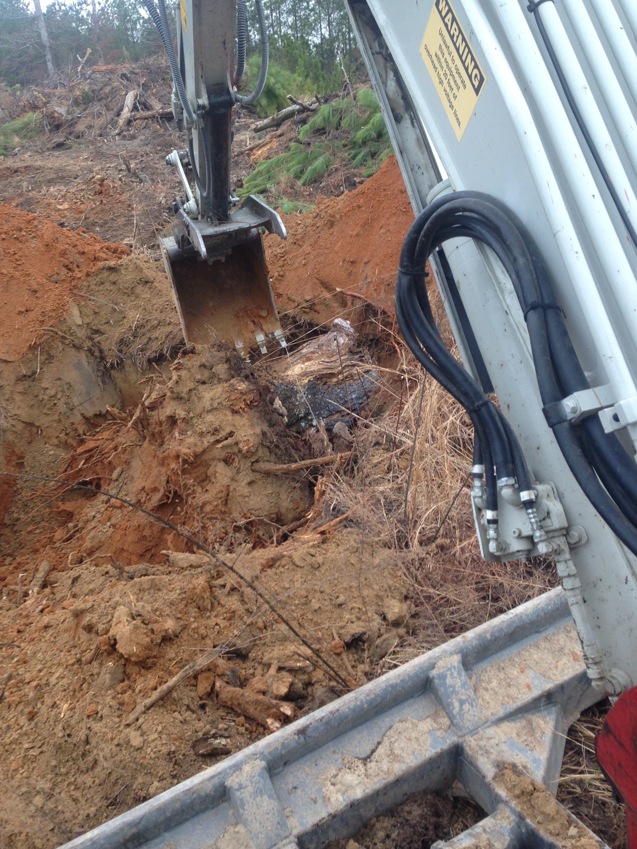

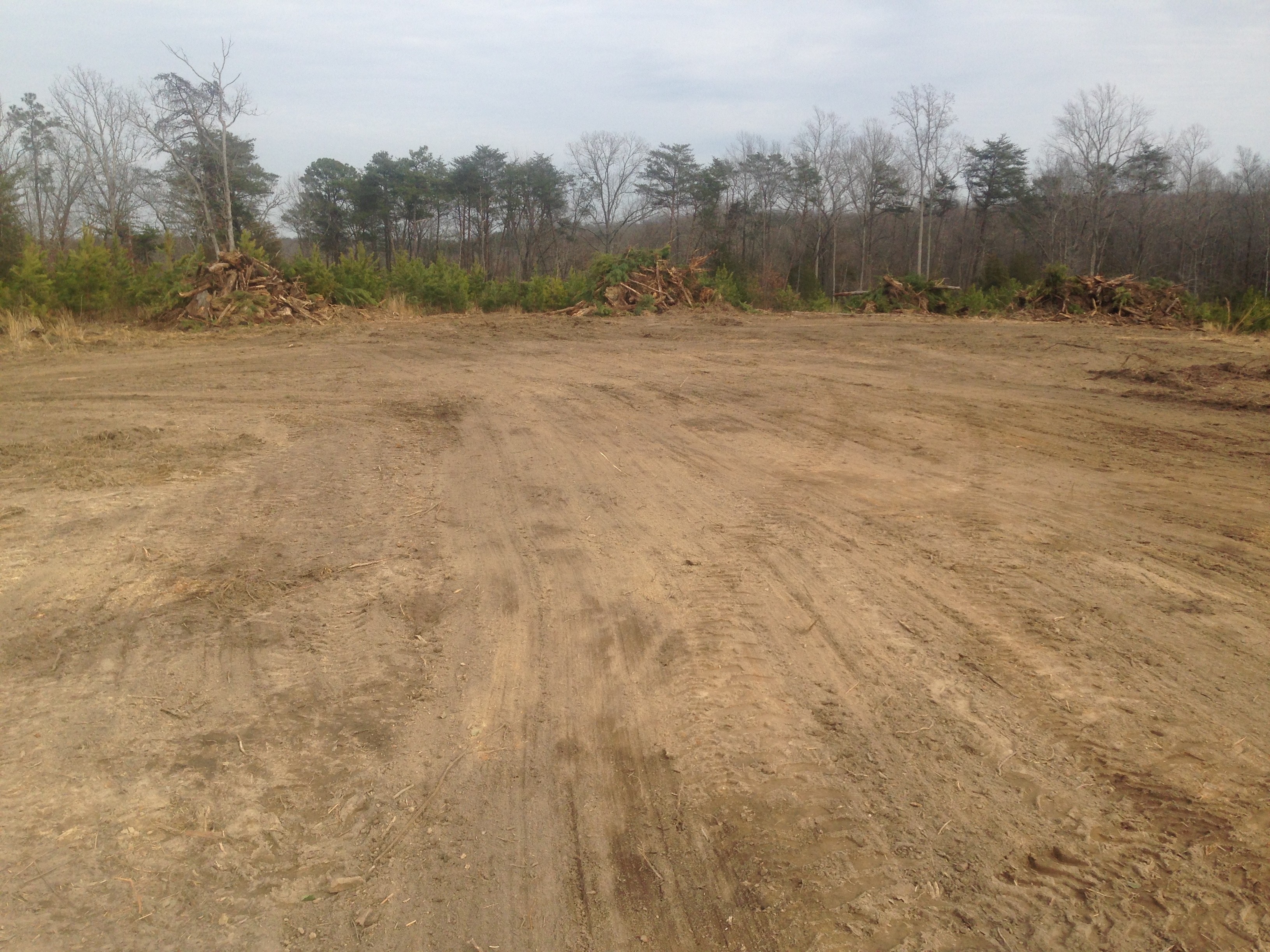

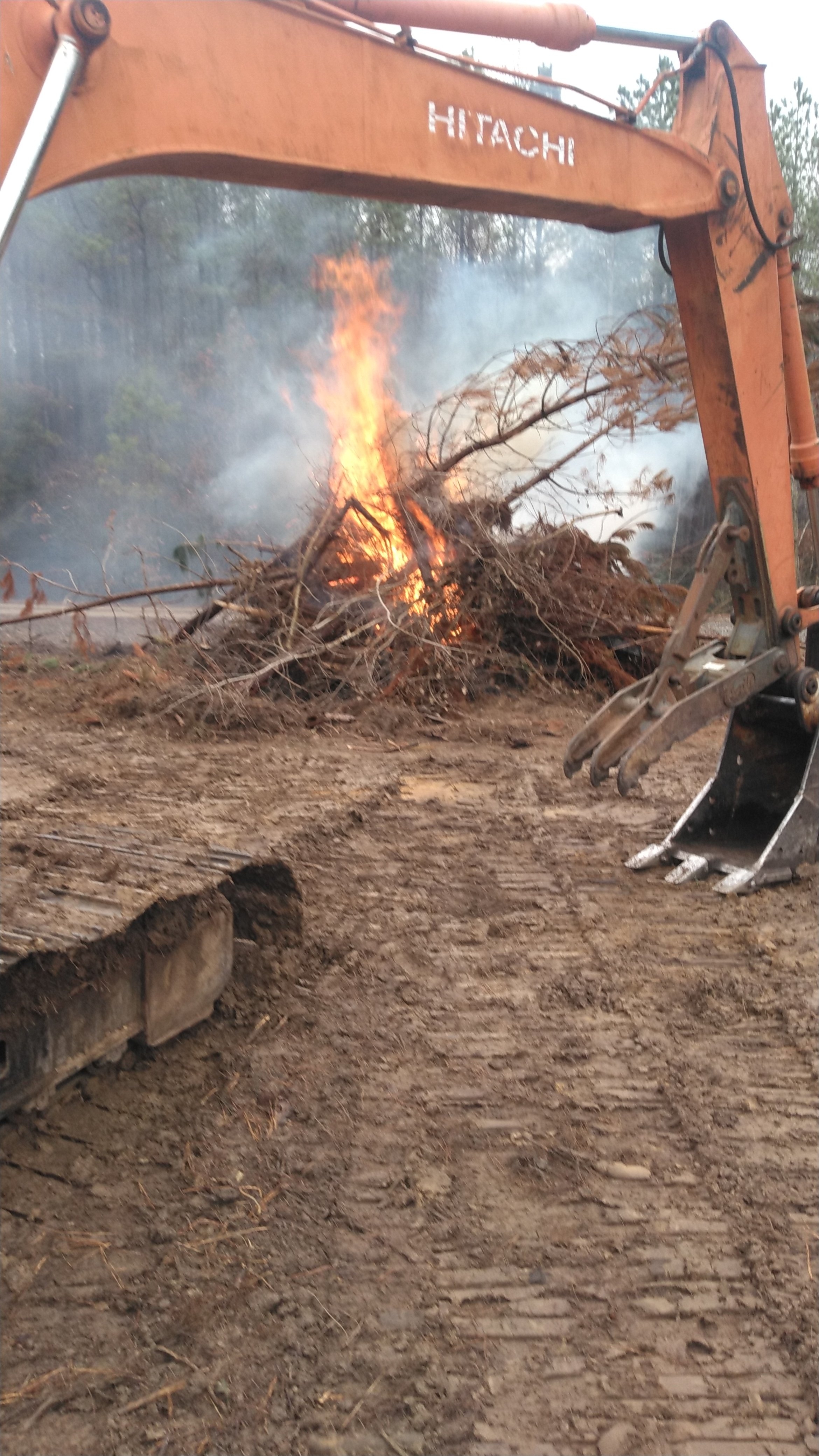

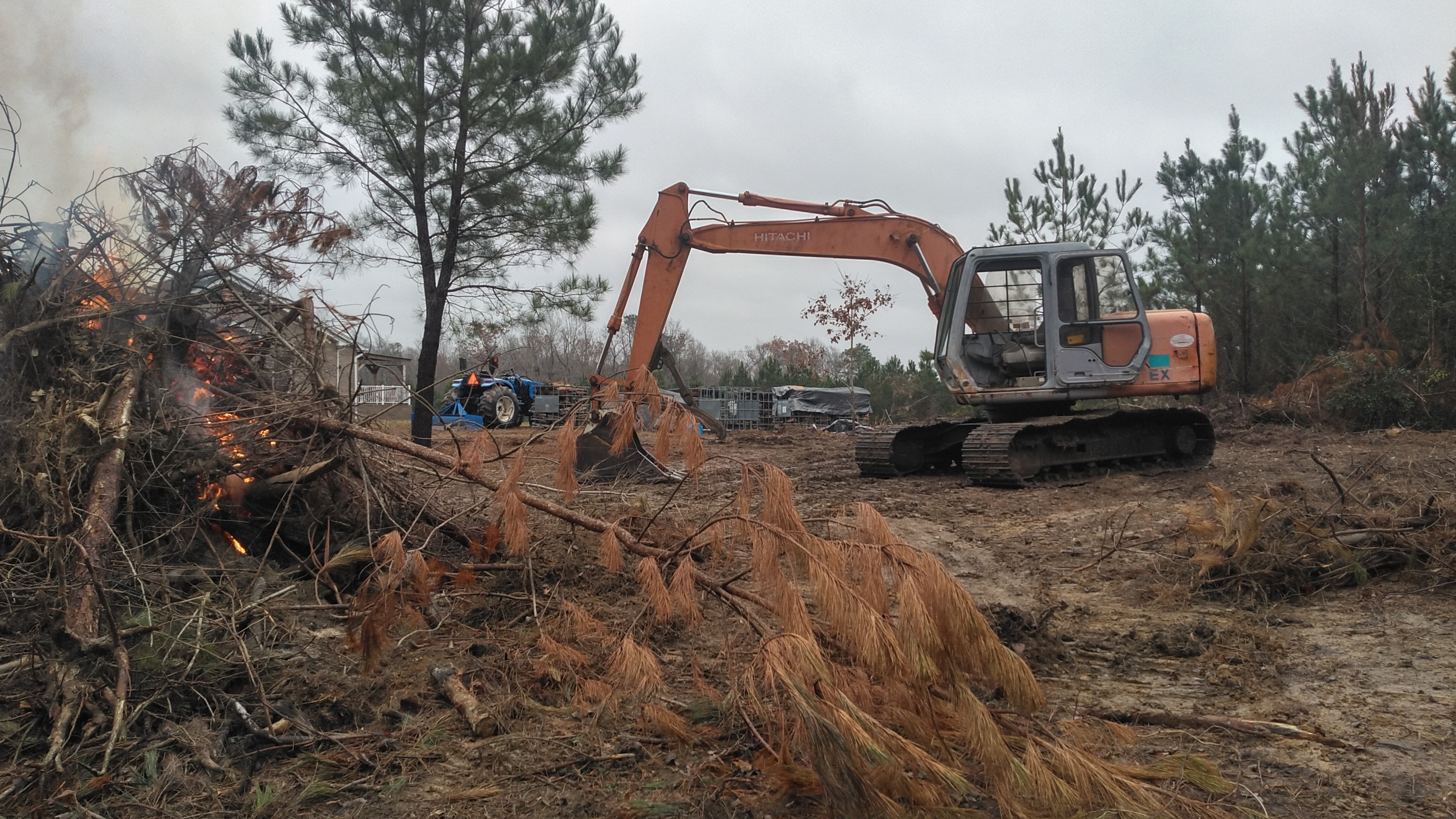

How big are the food plots you want to make? If you are just doing a couple of acres or less of food plots, rent a big mini-ex for a couple weeks (3 to 4K) and dig the stumps out. Then you dont have to worry about anything in the ground. Also, you could buy a 12K track loader and get yoru heavy work done and sell it or keep it and buy the tractor to go along with it.
Use the 2m.50 or 60 cab for road maintenance, bush hogging and moving around brush. I really like my 2860m. For a compact tractor, it is strong. I live in a smaller cut-over in VA and cleared with the excavator and did the clean-up with this tractor and an older 40hp tractor. Excavator was old and free. Put 7K in it while I had it and then sold it once I was done. It did a LOT of work for me, just expensive to work on.

Slash cleanup is tops. I plan to use a grapple to pick up loose stuff and move it to burn piles. Any serious roots or stumps I need gone will see the stump grinder.
