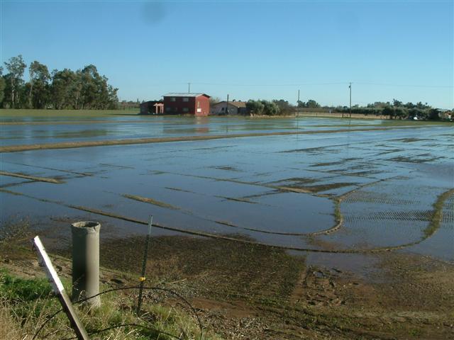

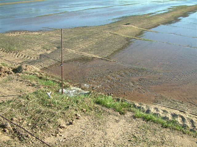

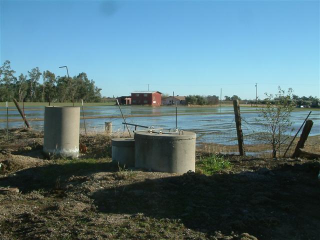

Here are some photos of that alfalfa field when the irrigation system was being tested.
The main pipe is underground. The concrete caissons provide access to the main valve.

You can see two of the long checks that have been plowed into the field. Separation between checks is about 105 ft.

Water flowing from one of the taps in the main pipe.
