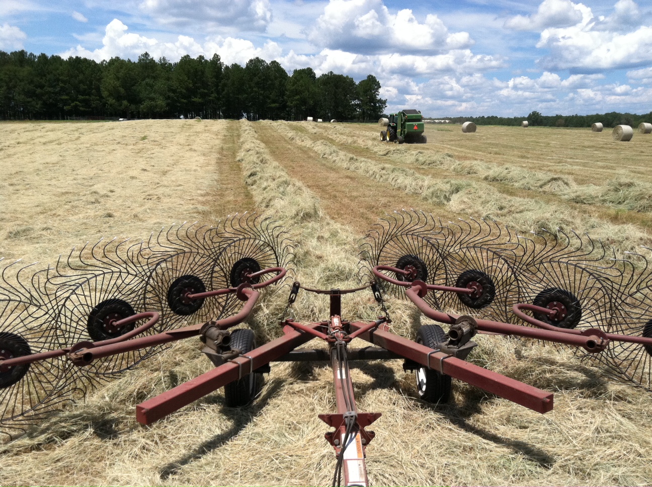

I've been growing Coastal hay in east GA near Augusta all my life and I've never seen a drought year reduce cuttings by more than one, from three to two.
It's a lot cheaper to just lose a cutting than to irrigate. If you miss a cutting you can still utilize most of the fertilizer when it does rain so it's not a total loss.
I have a pto pump in one of my ponds with 6-inch underground pipe that terminates near one of my hay fields but I have never irrigated it.
Here is a picture from a couple of weeks ago of that non-irrigated field, first cutting, which was a month late due to drought. I should get one more cutting.

We get 45 inches/yr average rainfall and I see no way to get 5 cuttings out of that unless you're just cutting a bale or two per acre. I assume I'm about as far north as you are. Cutting every 28 days/5 times per year without irrigation is theoretical be nice in my book. I let my hay get thick enough to start falling down, usually takes at least 6 weeks. My horses and cows eat it gladly and they stay fat.
Also, you will struggle to get enough psi for a traveling gun irrigator with a pto pump and a small tractor.
