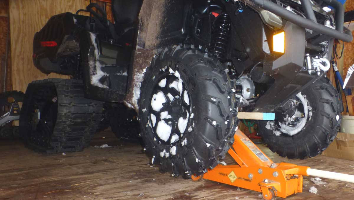

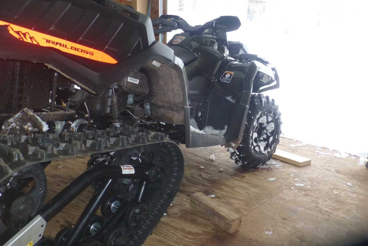

Got the machine back and finally into the field today. Heard from the dealership there is a know problem with the strength of this shaft AND there is a aftermarket shaft for it. Will report back on it.

Hey ArlyA, that could be the case. My mechanic friend has some highly modified Can Am atv's and he's the head mechanic at the dealer. He was telling me about some splined shafts that are failing because of bad heat treating.
I think it was axle shafts? He had to have a few warrantied.
/ 2022 Outlander Max 6x6
#150
Seems they're several aftermarket shafts out there and I'm trying to decipher if there are stronger or better. This is the front drive shaft that goes to the differential. Seems all the guys running pods are breaking them.

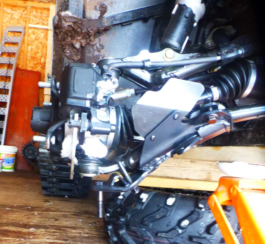

The aftermarket shafts have a much thicker body but have the same splines where your shaft failed. The design of the splines/joint is not that strong because of the lack of contact area. The spherical cut axle spline fits into a pocket with a straight cut spline. It seems like it is a poor-man's CV joint design. I wonder if the added torque of running pods would necessitate a different design for the entire length of axle?
Lost my front drive.

Interesting Wonder if it pays to thoroughly grease it during installation or add a grease fitting somewhere to be able to grease splines?
#157
I'd have to guess these couplers were well greased when assembled. Off snow season, we never even run 4wd so I'd guess we have about 10 hours with it in 4wd with pods. A weak setup? :unsure:
