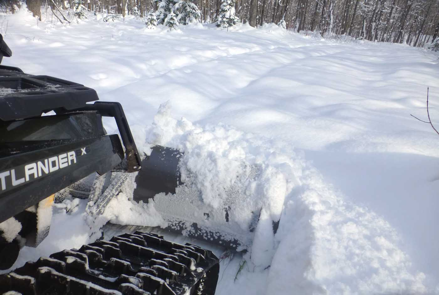

ArlyA thinks towing an implement is harder on an ATV than plowing. Perhaps. However he still hasn't explained how plowing is actually untaxing to the engine.

The machine is already back out in the field and yes, these couplers are known to fail with people who groom trails and equipped with pods. BRP does know of these failures. Some claim these spines were not heat treated properly. 🙄

Getting back to causes of failure imo evidence of chipped or broken off splines would indicate a sudden impact while plowing which could eventually cause those splines to look ground down, I believe the op loaded up the springs on the plow for the tripping mechanism. I have in the past also. Welding a pipe to cutting edge really helped me anyway for significantly minimizing sudden hard impacts.

I can imagine the amount of heat produced by pushing heavy wet snow is significant especially on a belt driven cvt drivetrain requiring additional friction on the belt and clutch sheaves to push.
/ 2022 Outlander Max 6x6 #199
It not the pushing, or even the throttle pressure...it's the sudden stops that is hard on equipment. This is true for both the engine and drivetrain. Pushing snow and then suddenly stopping does not prevent the physics of momentum from proceeding to the weak link.
Every ATV, UTV based machine encounters sudden stops in pushing snow. They don't have the weight to push through.
