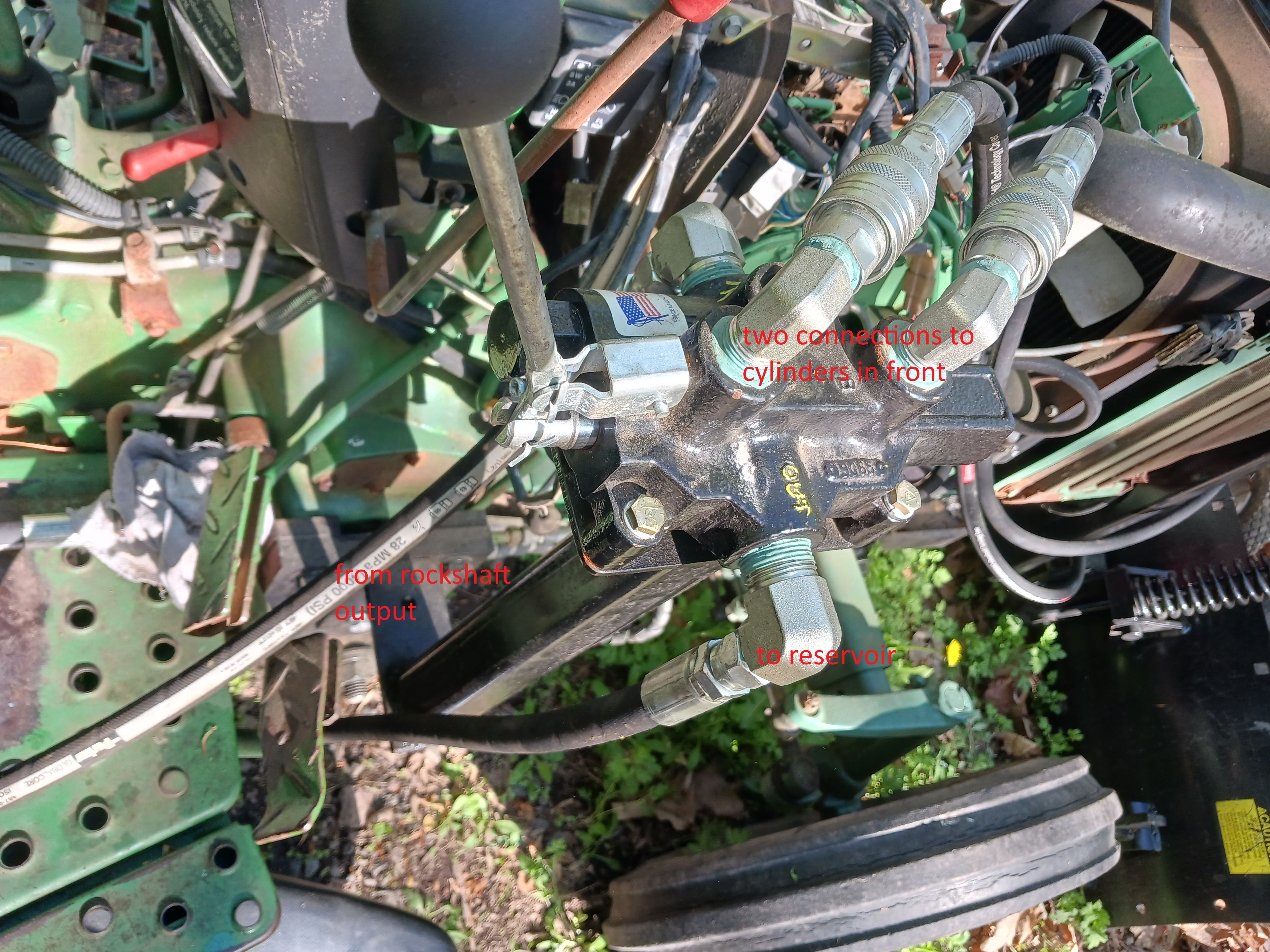

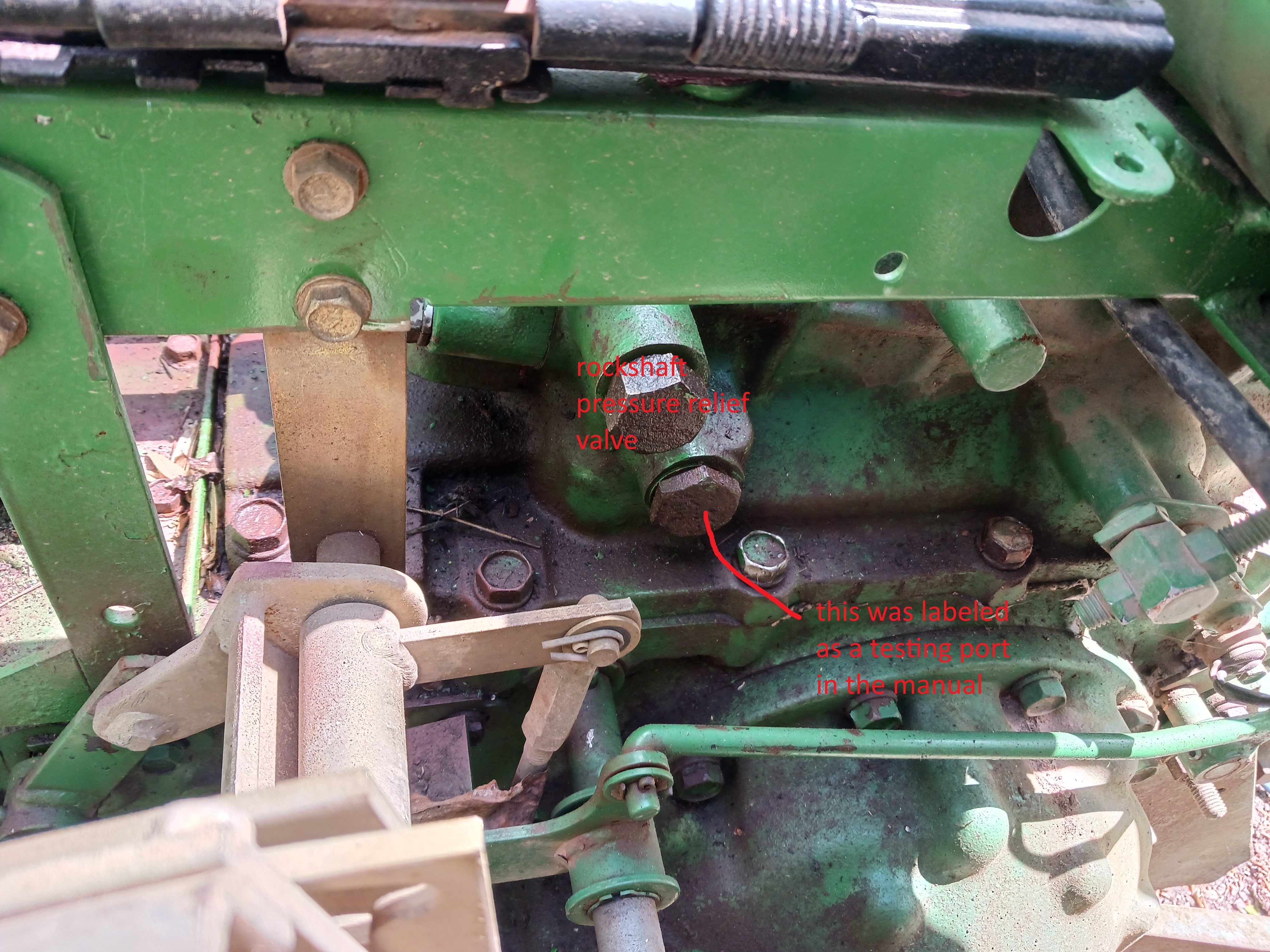

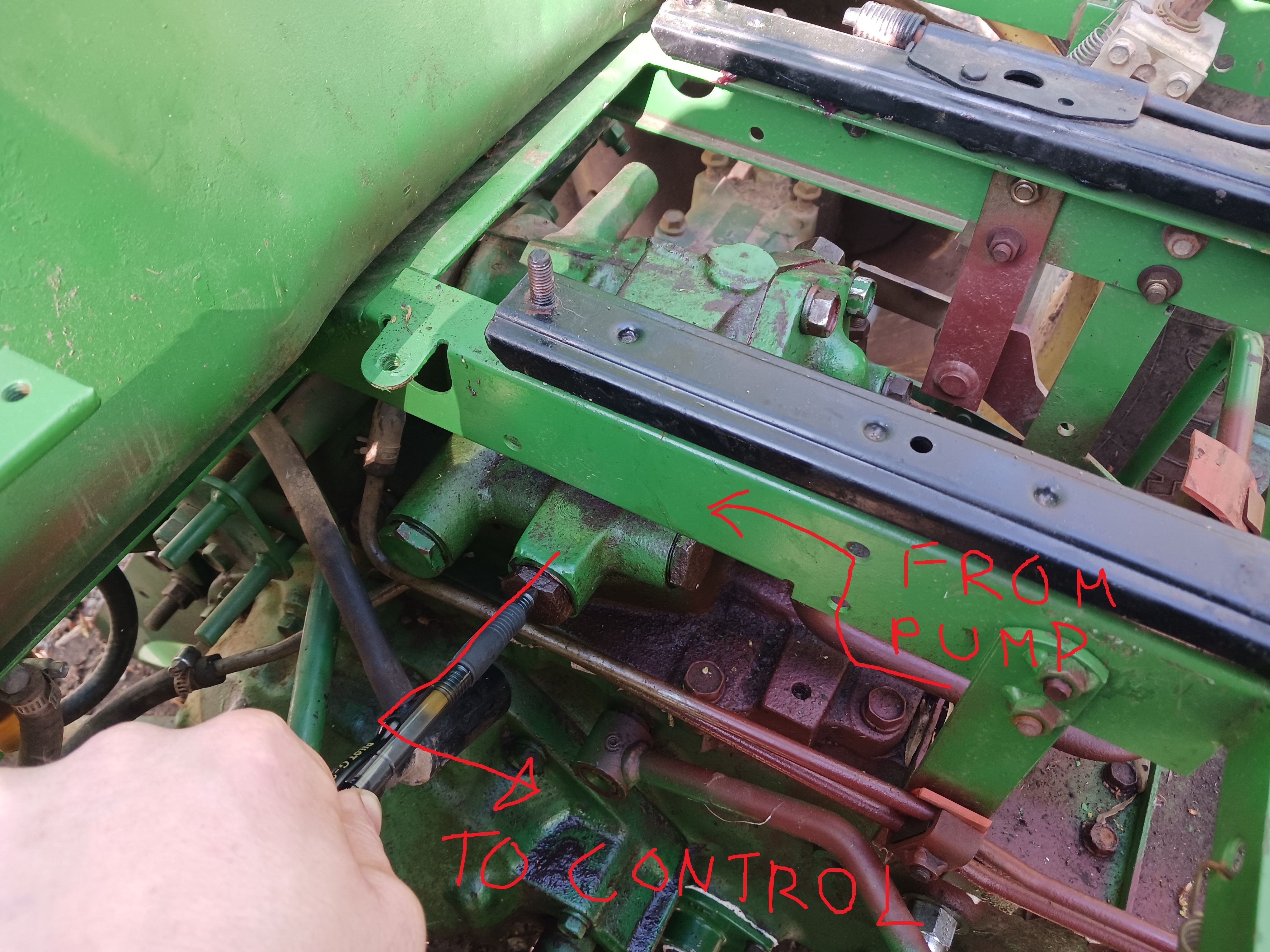

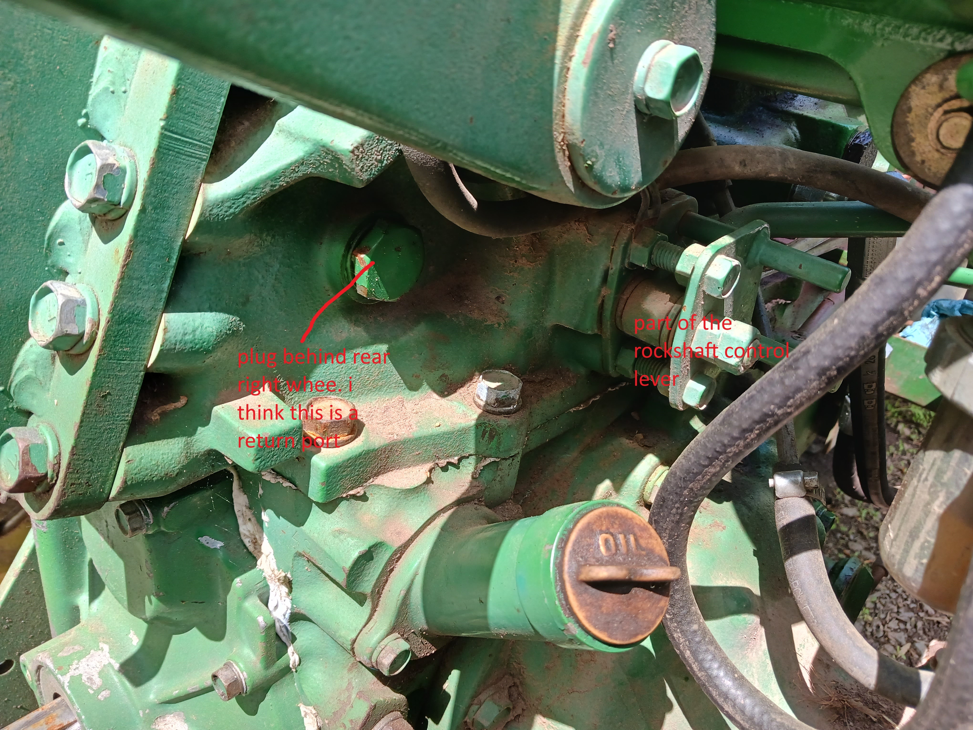

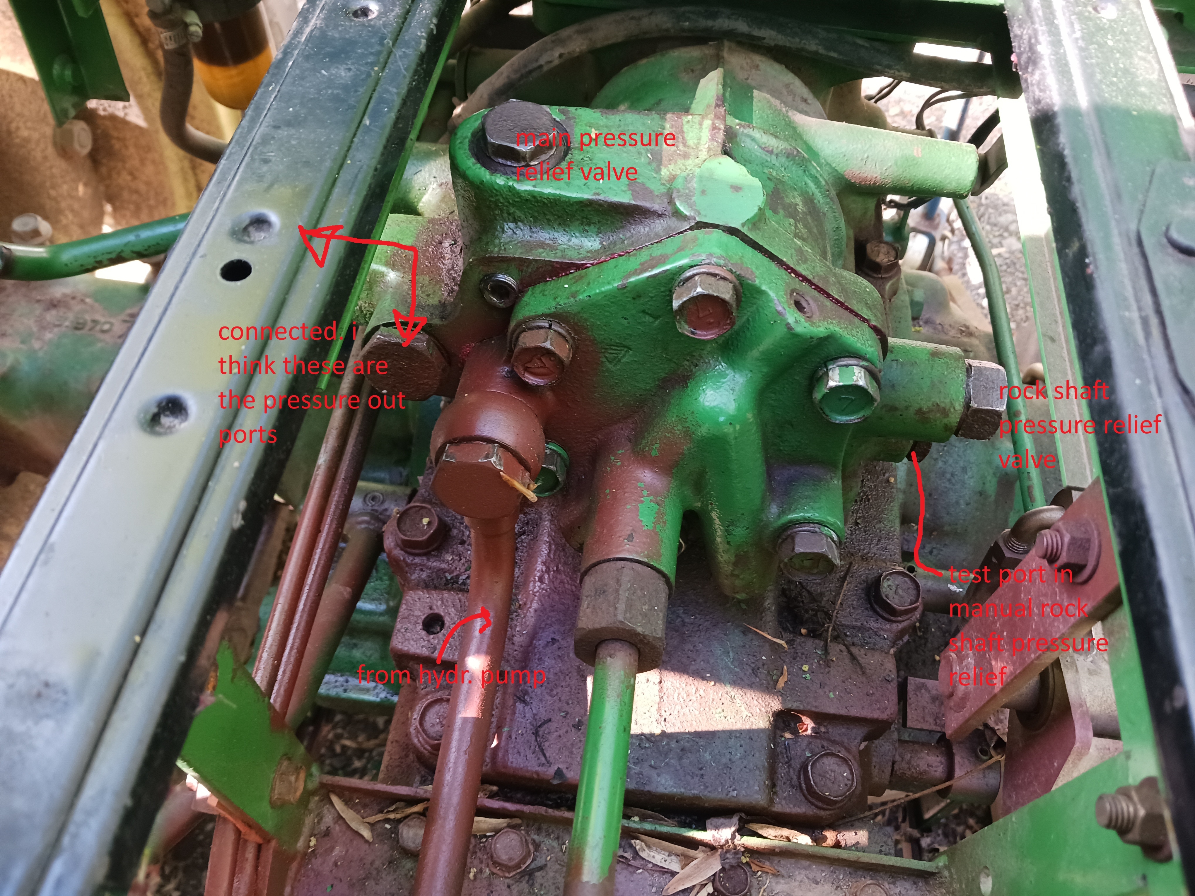

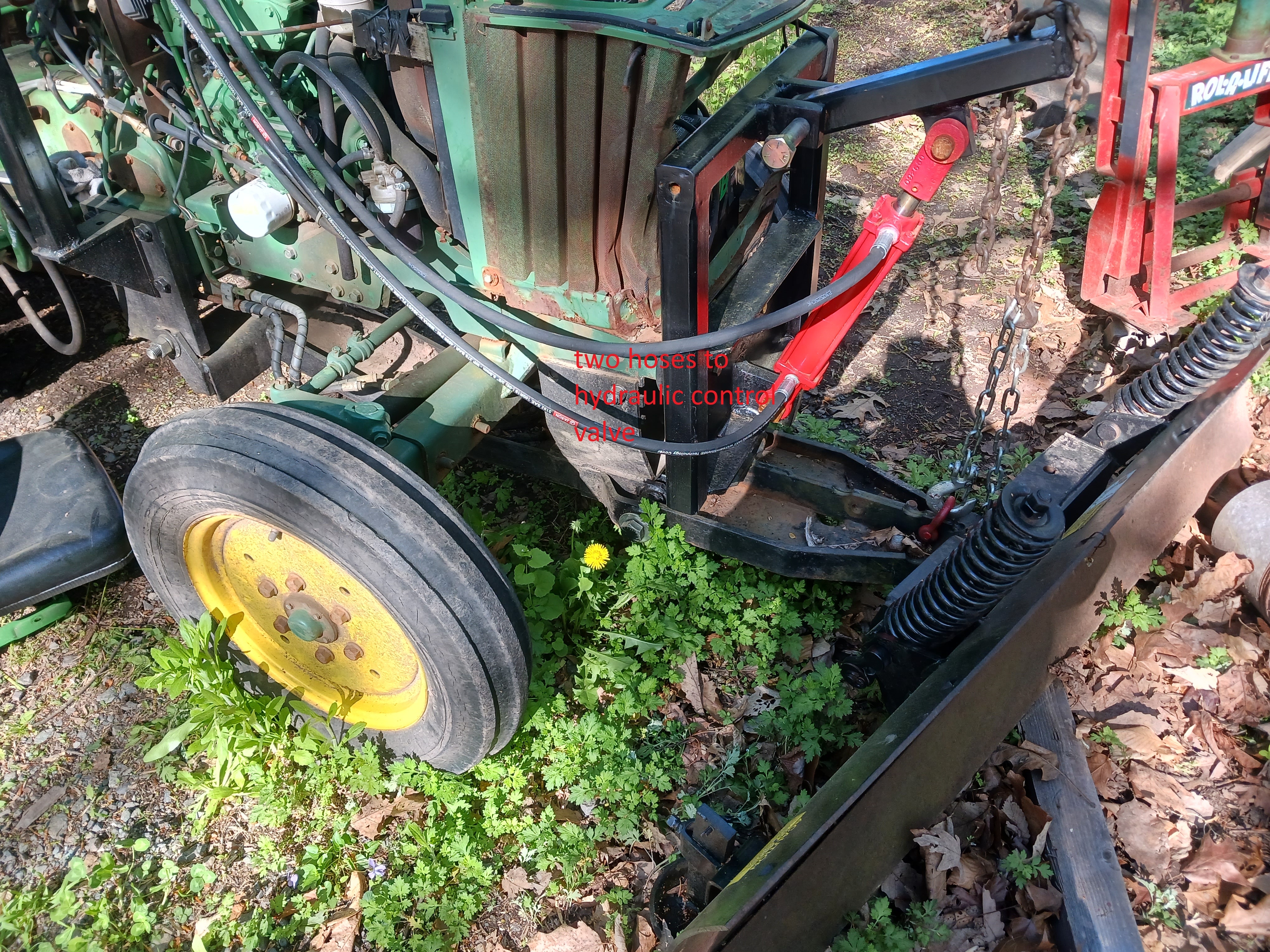

attached are pictures.
1. showing from behind tractor from right. shown are the hyd oil fill port and part of the lift lever control. there is 1 port here which i think is only for return (as it shows this getting used as a return for some attachments)
2. showing from left side of tractor. showing rockshaft pressure relief valve and bottom port which was labeled as a test port in our manual which we had originally used for testing the psi.
3. from front right side of tractor. showing hydraulic cylinder with chain lift. both hoses go to the control valve outputs
4. prince spool valve. has casting number 9065 that doesn't match up to anything but the important thing to note is that its an open spool so has flow through.
5. from right side of tractor. pen is on what i believe is the output for pressure.
6. from front of rockshaft casing. basically looking left from the right side of image 5. shown is the main input from the pump and the main pressure relief valve.
7. right side of tractor along the bottom frame. showing return line to reservoir.
with a bit more research i've seen it written that instead of an open spool (flow through) valve that instead i should be maybe using a closed spool valve since pressure doesn't return to the rockshaft otherwise?

i got the pressure gauge out and measured on what i believe is the the correct port for outputting pressure to attachments (photo 5 where the pen is pointing and the port directly to the right of it, which are connected) and at idle it shows 0 but if i throw a board under the lift arms (to test full power) it hits around 2000psi. the tractor specs say 2200-2300 so i'll call that good on that front.

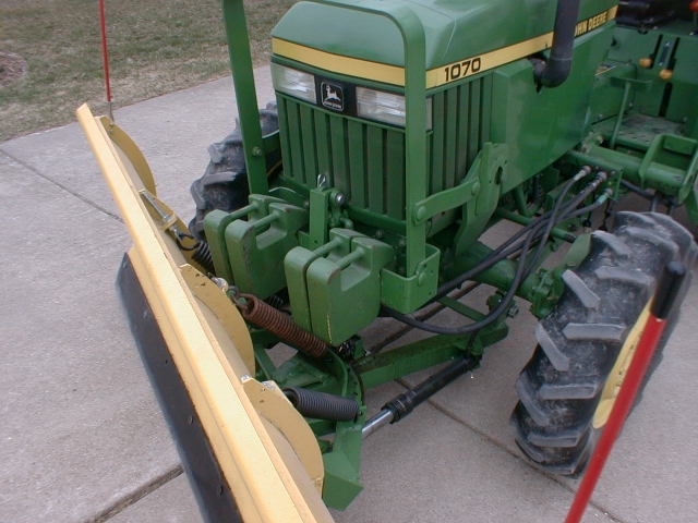

Easier solution is using loader circuits with curl doing plow angle (no loader involved).

figured out a solution, listing it here in case anyone else can make use of it. any of the loader circuits or rear take off are $1500+ which isn't a solution at all for what i wanted to do. i replaced the hardline pump to rockshaft case hydraulic line. i made a new flange for the bottom of the pump with an o-ring tapped for 1/2 npt (i had this from my testing phase) and ran a hydraulic hose from there to a 3-way valve coming in from the left side. the rear port goes to the rockshaft case and the front port goes to the new hydraulic control lever i had installed. i can operate the rear hitch with the normal lever when i have the valve to handle to the left and i can operate the front plow lift when i have the valve handle to the right. its an either-or situation. basically a manual version of what the fancy oem equipment does (which as far as i can tell is a hydraulic valve with an electrical sensor and solenoid shut of valves on the other inputs depending on your selections). everything now works fine for under $150 in hydraulic hardware (not counting the new pump here or the new o-rings which the tractor had needed anyways).
