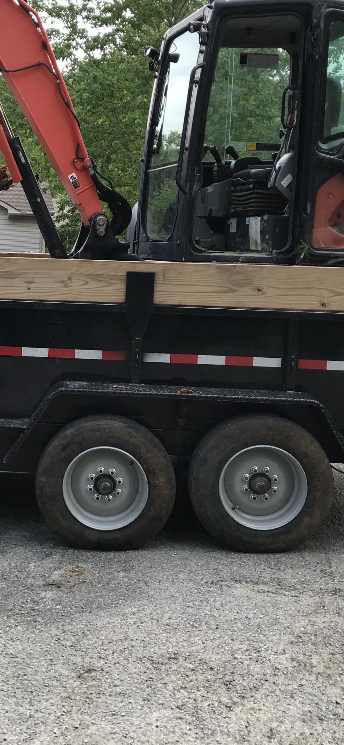

I'm shopping 16k trailers and I found a company making one with an advertised 14500 payload. It has dual 7k axles and weighs 3100lbs. How is this possible? Seems like it would have to have 8k axles and only weigh 1500lbs to make this happen. What am I missing?
Something doesn’t add up with the trailer specs..Error I hope?
I own multiple trailers, 7000, 10000 GVW rated and the 7k has 3500 lb axles and the 10k has 5200 lb axles.
Never seen a trailer rated lIke this.
All this on 15” tires? Max tire rating on this tire is 6100 lbs with 7000 lb axles?
A trailer this size usually has standard 16“ tires. I would never buy a trailer this size with 15” tires and it will pull hard.
None of this adds up.
Would compare these specs to other makes for sure.
