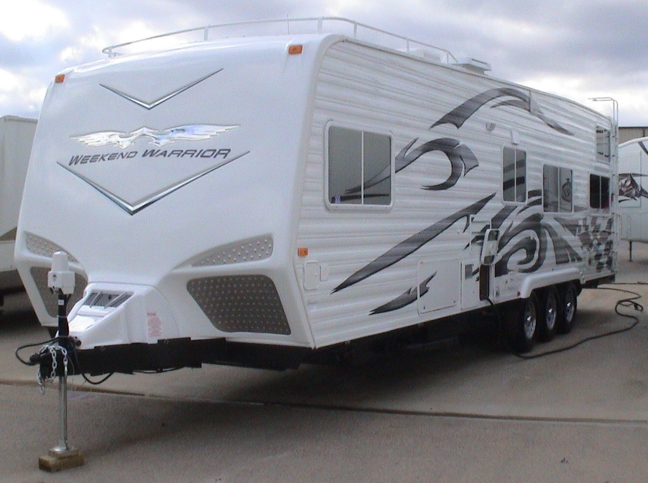

Makes me wonder what the actual profit margins are for the cardboard and staples that passes for an RV these days
Lots lots lots. LOL
I used to haul brand new RV trailers from the factories back in 2008. So I got to see all the paperwork.
Back then even with the $80,000 trailers there were none that were over $25,000.
I'd say that is a pretty good markup.
In 2005 I bought a 27 footer to tow behind the dump truck in my avatar when I worked out of town. It was $31,000 on the lot. dealer "gave" it to me for $24,000. I thought wow, what an awesome dealer! Until I started hauling them to dealers with my highway truck and found out it was a $15,000 trailer, LOL
