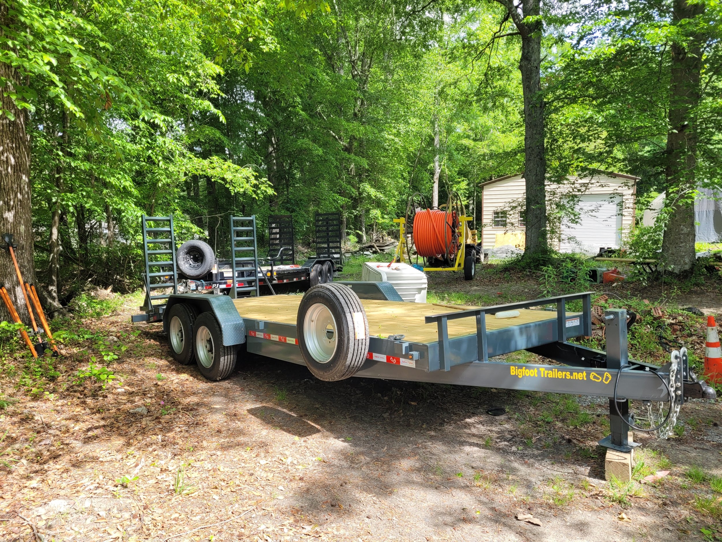

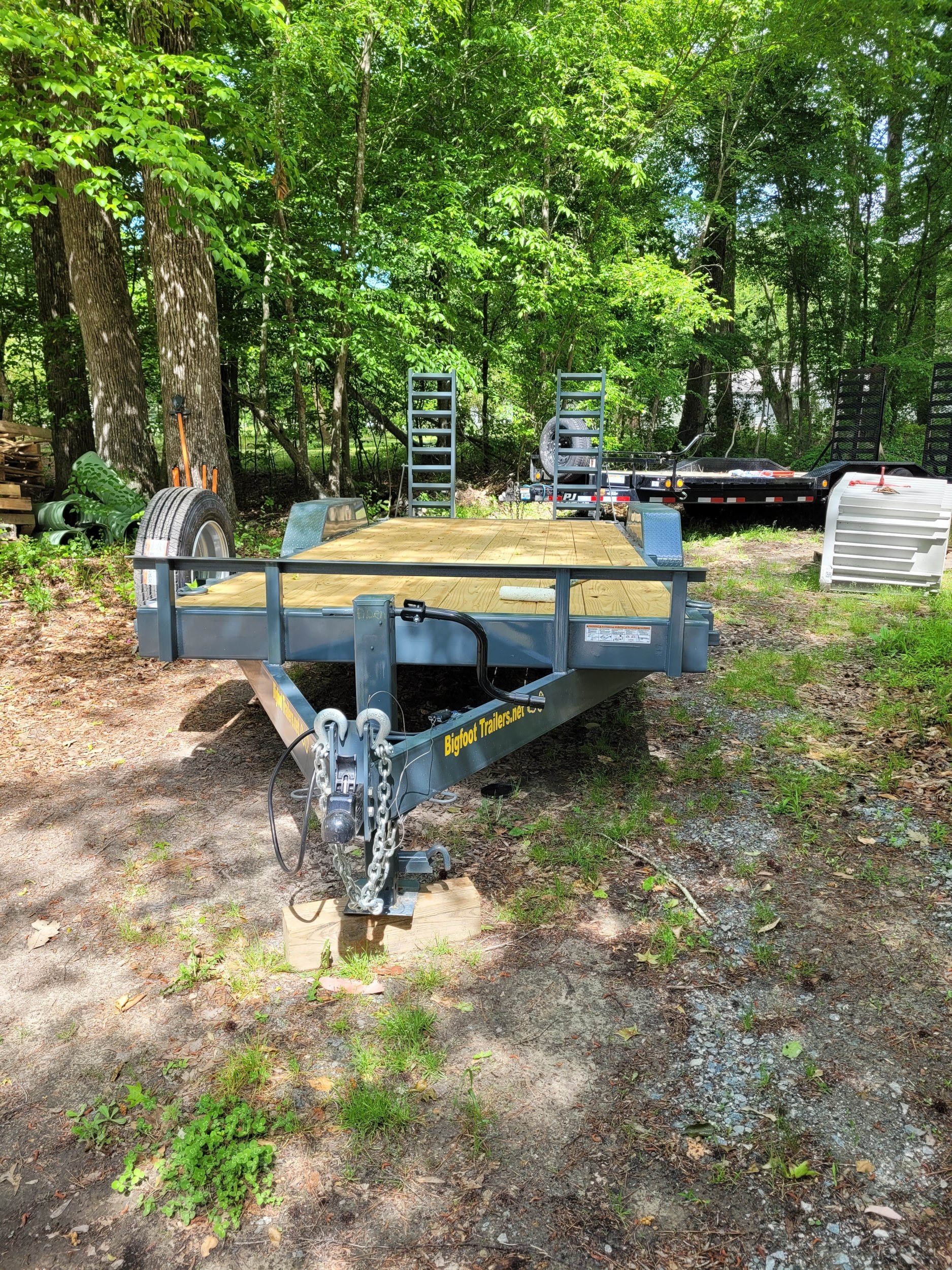

Yep! that's why you have to know more than them and order one built correctly despite them saying the same trailer with tandem axles and 15" tires on the lot will "work just fine". :rolleyes:
View attachment 796474View attachment 796475
Triple 6K axles, 16" tires Load range E.
Check the Age of tires too.
4 digits- eg: 1223 = 12 week of 2023.
New trailers should be no older than 2022 unless irs a price reflecting tires.
When I bought mine in 2004 it had already cracked tires round and round for abit then the dealer swapped them off mine to another one.
I'm happy hope the other person was WISE enough to catch it.
My opinion on new trailer would be to step up the axles rating would not pass the commercial law enforcers up here and an out of service could ruin Your day/week.
Buy what YOU can afford to do the job plus.
Its like building a pole barn bigger is better
