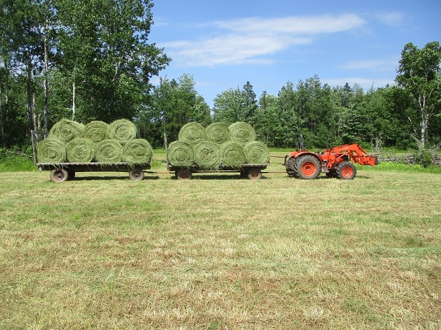

Don't apply to me at all simply because I use my modified rear hay spear with a GN ball welded on the top and the 3PH is always at full elevation when pulling the GN loaded. I rarely use the drawbar for pulling anything other than drawbar pulled implements like round balers and disc mowers. Even my Kuhn Gyro-rake is 3 point mounted which I much prefer because I can lift it at the end of a windrow and not leave a curved tail of forage that I have to 'chase' with the baler.
I like to keep my windrows straight always. Makes for easier round bailing.
I have used a considerable number and types of drawbar pulled implements over the time I've been operating a tractor, as well as some 3 point mounted implements and even a fair number of what are termed semi-mounted ( they just use the lift arms, and not the top link) plows and hydra-swing haybines being the most common for me.
I also move trailers and such around with a 3 point mounted hitch, actually have one over at the farm which is mainly used for the log trailer.
Now maybe YOUR Kubotas are different from every other tractor that I have been around that I worked with or on the 3 points because none of them had physical limiters to protect the tractor or implement from rising higher then designed too.
Best use I've had for a quick hitch.
Then my other 3 point to trailer hitch;
then this picture shows clearly the chain that I use to make sure that they don't rear up too high while being used or loaded,
as I have had them try and lift higher then the lift arms are powered up.
