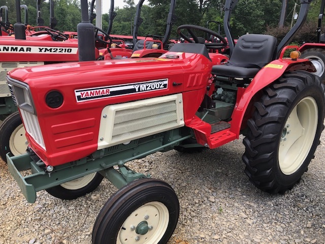

YM2002 continued
Speaking of family models, the YM1802 is extremely matched with this model as a direct sibling. Thus, the attached document will show this.
Let's now look more into the machine itself. 🤠

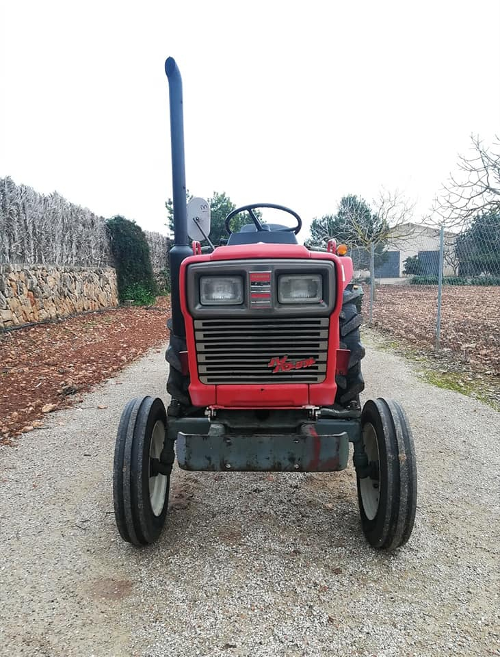

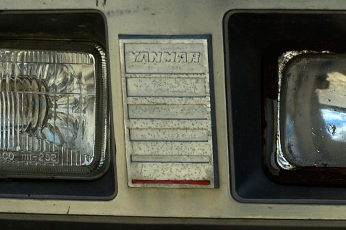

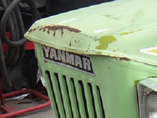

This machine doesn't have the Yanmar Red emblem. Instead, it's a fine text of Yanmar on one line and stacked among red and chrome horizontal bars between the eyes. A loose translation is the emblem of a burning man or man of hot strong power. One that can project flames outwards. A man-dragon?

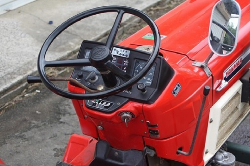

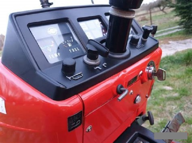

The open cab with the double level deck. Notice the PowerShift with high and low selections.
The dash controls are very plush and many in English.
The engine ID name plate isn't the typical design. Notice the plumbed in
ThermoStart. This type is not a manual fill either.
Some engines did receive the normal engine ID plate.

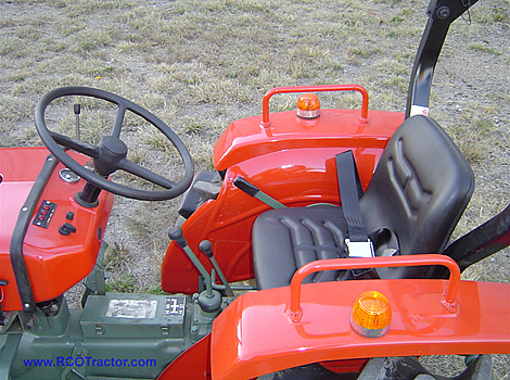

The rear fenders have the tail markers. These are common on the upgraded tractors made by Yanmar. This makes the tractor street legal right from the factory.
From another YM2002 that had seen heavy use. This shows the tiller associated with the machine.
A beautiful UTDA fully restored YM2002

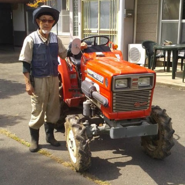

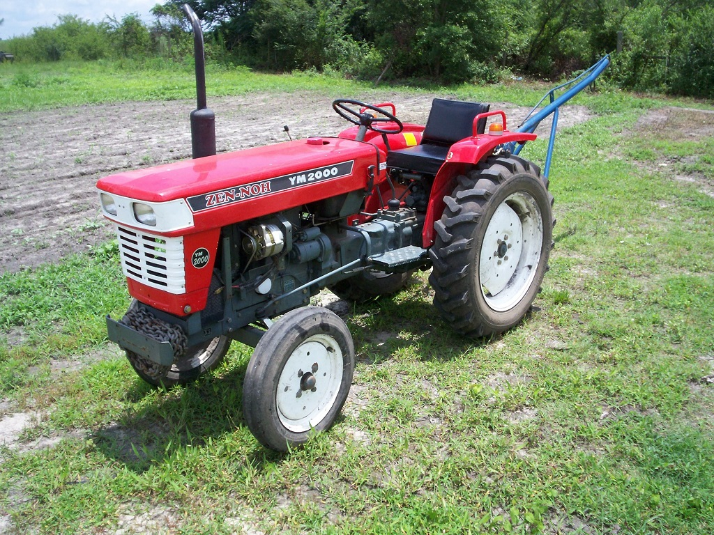

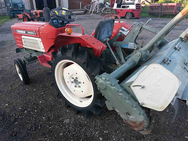

Here's our lil YM2000A-A.]
/ Yanmar - Model Cover Pages #51
Grandson loves tractors

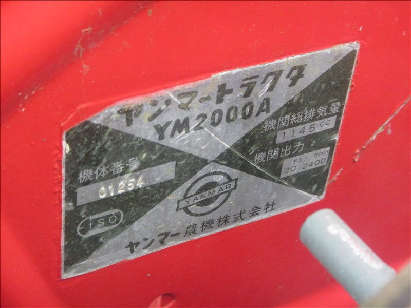

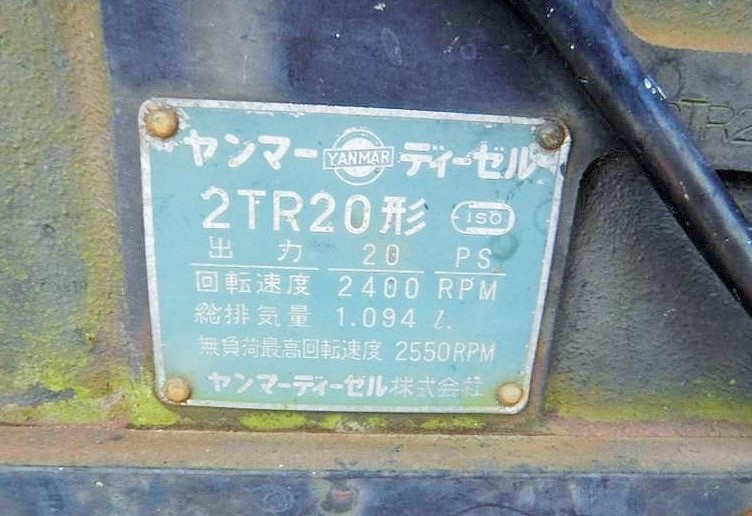

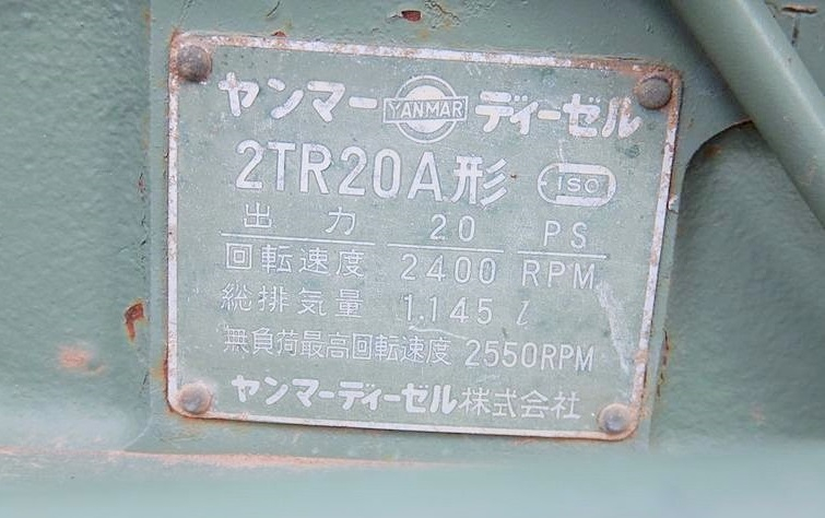

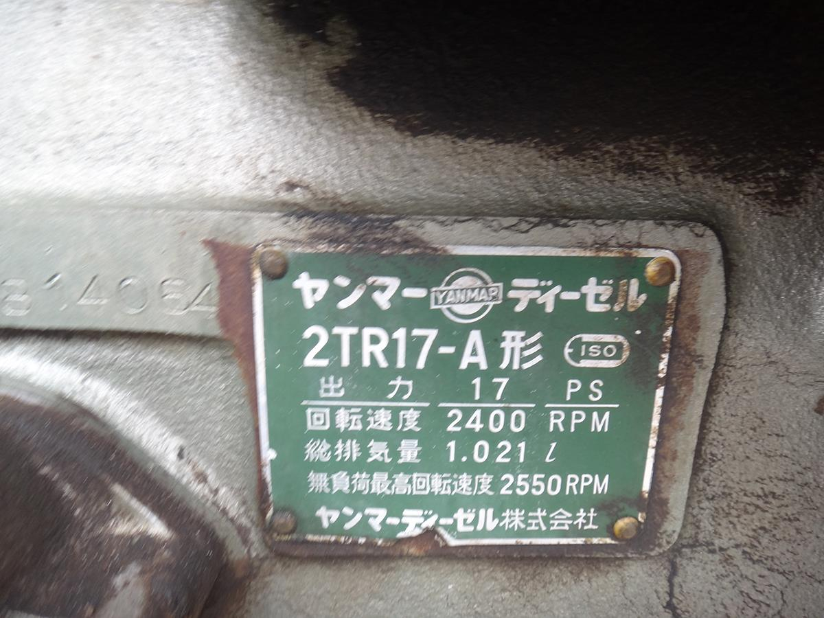

What's the break down on the engine plate? HP, RPM etc..
#53
Before this thread gets totally hi-jacked from it's intent ... :p
The engine plate tells the Engine model, the max engine RPMs, engine size in L, the ideal RPMs to the peak power curve and the Hp to JIS standards (not SAE).
In the Yandex OCR image translator from Japanese to English your engine plate posted reads:
Yanmar Diesel Engine
2TR20A-A MODEL (ISO)
Output Hp 20 PS
Total Engine size 1.145L
Maximum Engine Load Speed 2550RPM
Yanmar Diesel Co., LTD

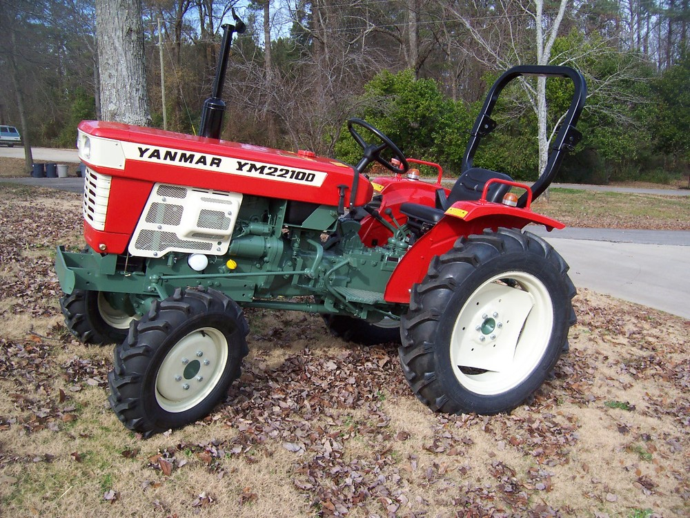

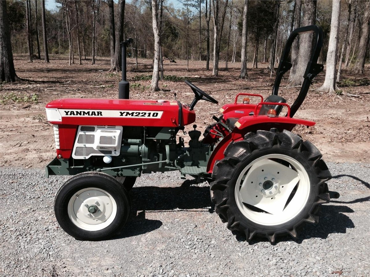

YM2210
Yanmar has made many 1st in the tractor Ag industry and machinery. here is another ...
In order to facilitate operation and improve maneuverability, a clutch free variable speed power shift mechanism was adopted for the transmission of compact tractors. At that time it is the world's first innovative technology that brings together the technologies of Yanmar, the world's leading manufacture of high-performance. (translated)
UTDA fully restored

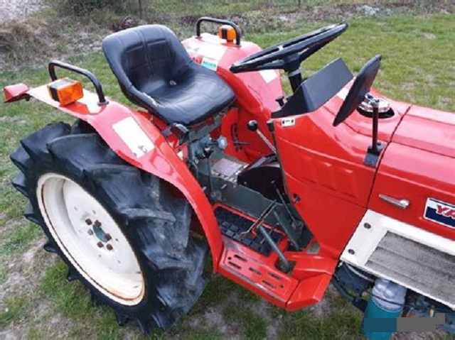

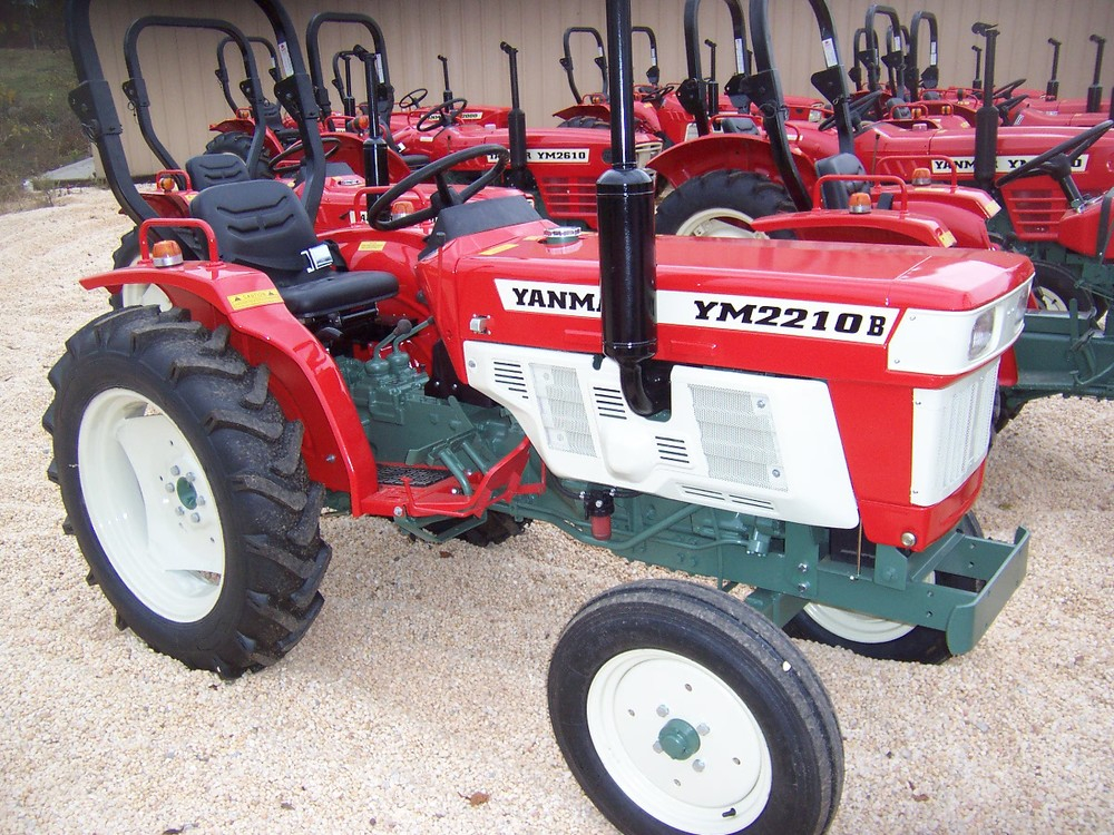

YM2210B
The B-Model. This model tends to be more of the dressed up type. The eyes wear a mask like Zoro. The engine has cover panels complete on each side. This model is more plush over it's earlier version.
Unlike the other models moving from a base model to a B model, the engine remained the same, the second largest 2-cylinder Yanmar made in the YM series, the 2T90. The 2T90LE is the industrial and generator engine. Thus, parts for the engine are not too rare.
UTDA total restored model

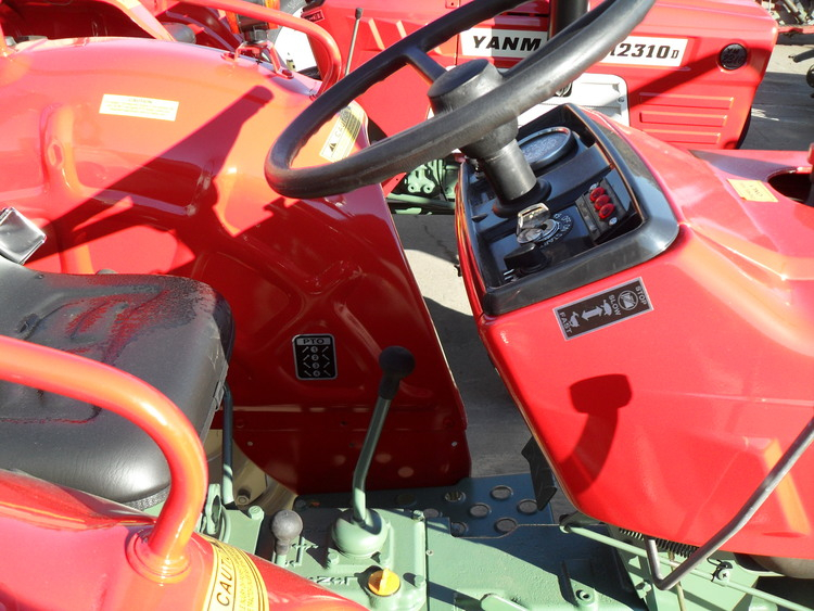

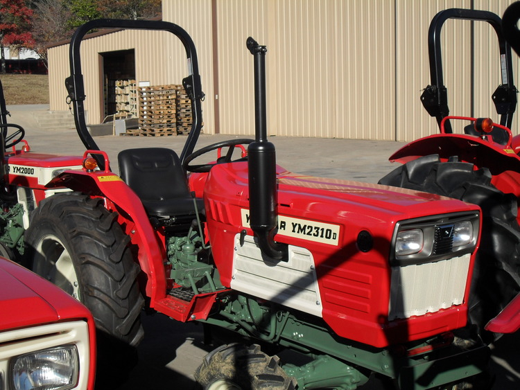

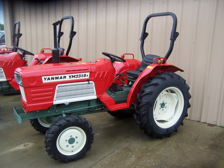

YM2310
The model with the power and the extra perk options. :)
Per the parts manual, as with most of the models in this thread attached to each posting, one will notice the
seat mounting frame. This frame is ideal for the swivel seat device upgrade. Wise makes a really nice Marine
swivel seat mount that can be easily retro-fitted to these models. Or, one can fabricate a seat frame like these
models for their own YM should room allow.
UTDA restored to new condition with all the modern safety hardware. I show these images because it's so hard
to find YM machines in mint condition from that era.
Like many of the YM2000 machines and higher in model numbers, Yanmar keeps plenty of the upgrades as standard
equipment over the earlier years before the 2000 was reached. Nice.
The chrome fascia plate around the eyes gives this a more modern look without being bulged out.
The PowerShift and controls.

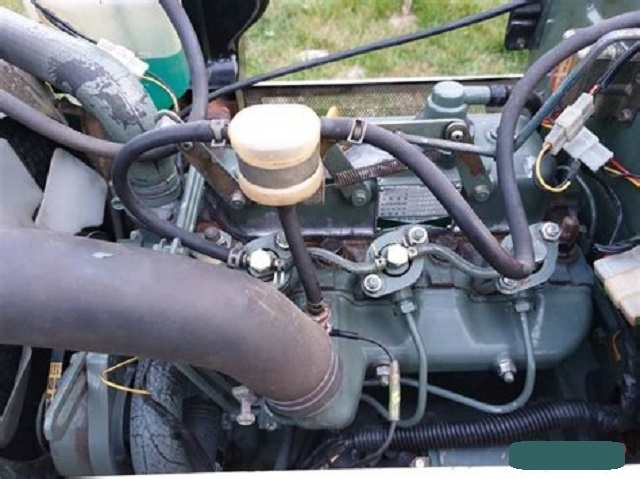

The 3T84H engine with ThermoStart

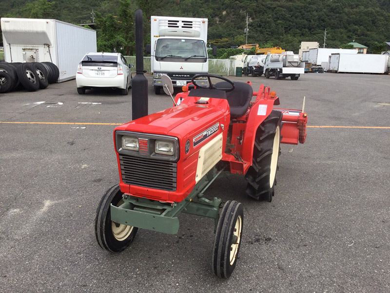

YM2500 the twin sibling of the John Deere 850. Just painted in red vs. green. And no, it's not a YanDeere. ;)
With this body frame size, the YM2500 is a good comparison to a Ford 8N, yet engine wise stronger.
A YM2500 owner in Japan

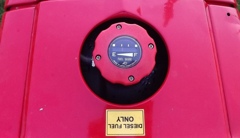

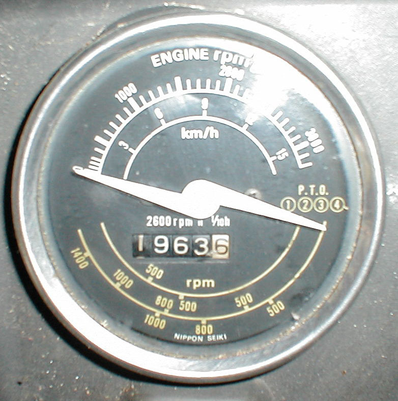

A new novel use item appears for the first time. A working fuel gauge for Yanmar and John Deere machines. This fits the known models:
YM140, YM147, YM180, YM186, YM187, YM226, YM330, YM336, YM2210, YM2500, YM2610, YM3000, YM3810, JD650, JD850, JD900HC, JD950, JD1050

The YM2500 breaks the trend in the Yanmar YM model code. Models ending in -00 are 2-cylinders. The YM2700 returns to the 2-cylinder, but becomes the last -00 having one.
The YM2500 has the 3T80-D engine. There are many variations of this engine other than Yanmar and John Deere tractors. It's used in many places. The 3T80LE engine back in it's era was the main staple for the Yanmar Industrial engine class for generators, boats and other heavy equipment. The engine shares many other parts with the 3T84 Series engine as well. The YM2500/YM3000 Parts Manual clearly shows this fact.
Like many of the YM Series Yanmar's the YM2500 came with a multi-speed PTO. Or one could say the ability to operate the PTO at 500-540 RPMs in different selections from a higher engine rpm down to a near idle RPM. Only a handful of Yanmars came with the proper gauges to monitor this ability. Likewise, once can operate the PTO at 500, 800, 1,000, or 1,400 rpms should there be a need.
Even though there is no rated tow capacity listed for the YM Series machines, the YM2500, JD850, YM2610 with the tow-tube can move loaded 10,000-lb trailers in gear setting-2 without trouble. This is from 5 years of personal experiences.
