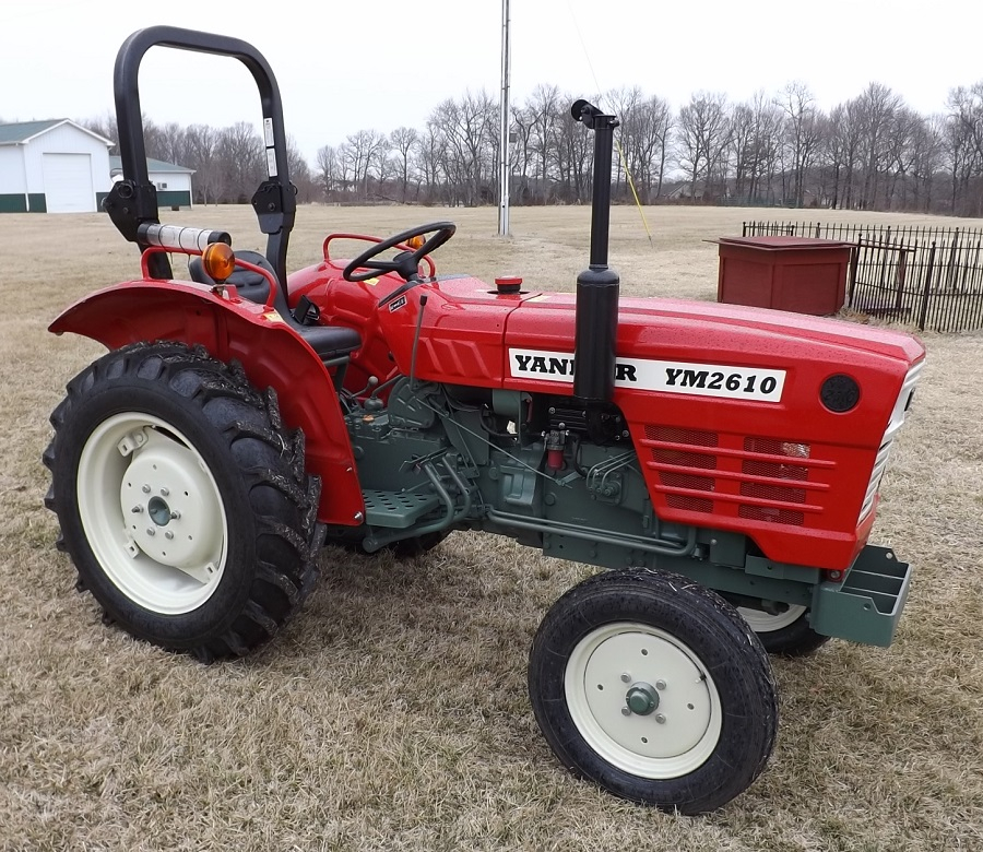

Here's a UTDA YM2610 on the lot.
Here's a UTDA YM2610 in my yard. (Wait, they are both the same machine. :giggle: )

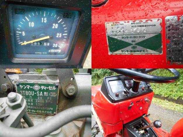

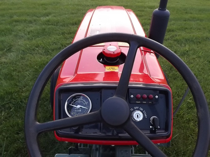

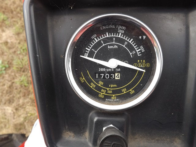

Like the YM2500, the Tach and PTO multi-speed gauge is very much the same.
The dash and controls are very basic.

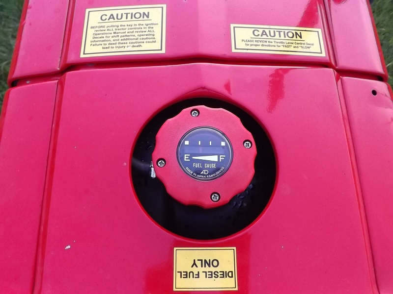

Like a few other YM models, both US import and gray market, the YM2610 can use the fuel gauge with cap arrangement.

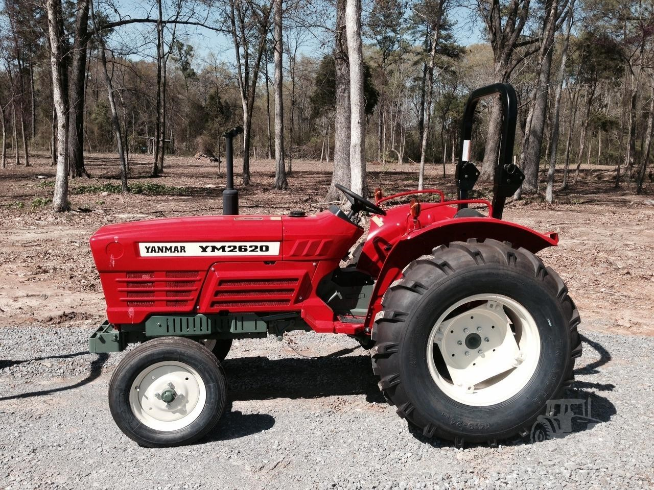

YM2620
It's a tad of an upgrade over the YM2610.
Models ending in -20 were often with a wet brake rear system. Adjusts were a bit easier unless moisture got into the drums and a bit of rust happens.
The YM2620 has one of the popular engine series, the 3T84. The 3T84-NC exactly.
This engine series is seen throughout the YM US & UK domestic machines and in the wonderful Gray Market machines. This offers more parts and options.

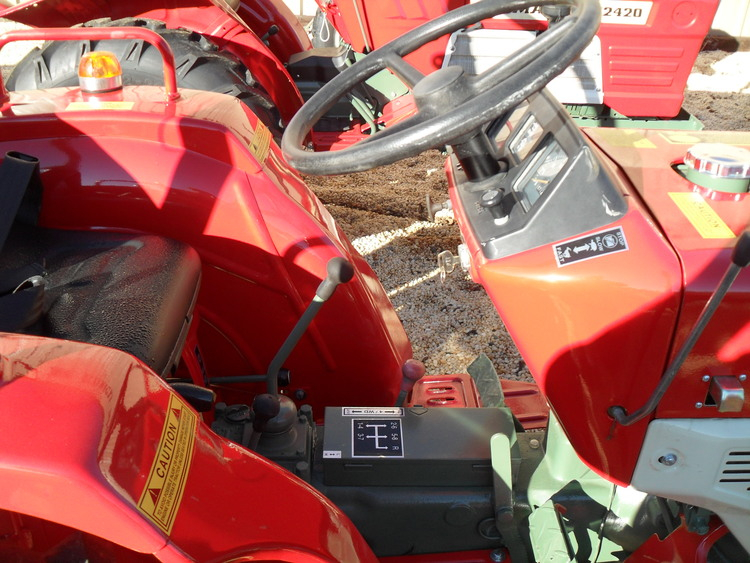

Like the YM2610, the YM2620 comes with the PowerShift. Likewise the -10 & -20 share the same engine panels, hood, fenders and other body parts. However, the grill is different, usually a black-charcoal gray and the floor boards are wider and broader in length.
From this stance, it's hard to notice if this is a YM2500, YM2610, YM2620 or a YM2820.
When the engine side panels are on, then it becomes a bit harder as with this UTDA restored model.
With the -20 models, the dash and gauges are more modern than the -00 and -10 models.
As made by Yanmar with all the panels even around the seating. Likewise, between the two images, it does have the same multi-speed PTO as the YM2610.
With the panels removed, it has the making of the YM2500 & YM2610.
It's hard to if this was a model with 'draft' control for 3PT attachments. I do see the lever next to the 3PT lift lever like the Yanmar made John Deere 50/55-Series.
Behind the seat is a rear wall. Great for a toolbox or ability to have an enclosed cab.

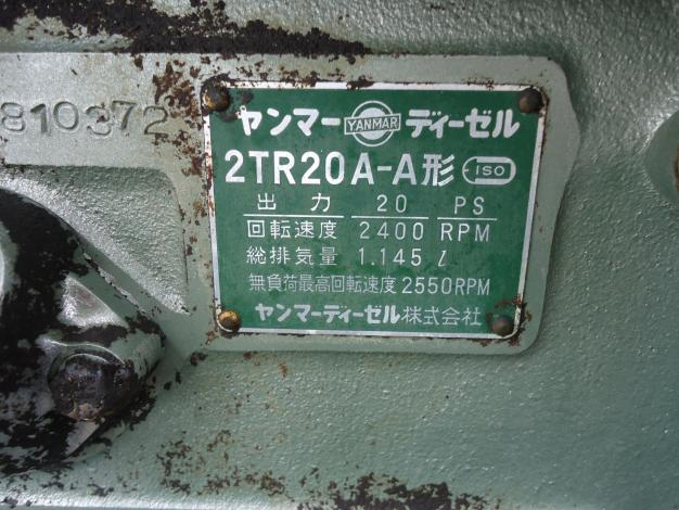

YM2200 ENGINE ID PLATE
YM2700I ENGINE ID PLATE

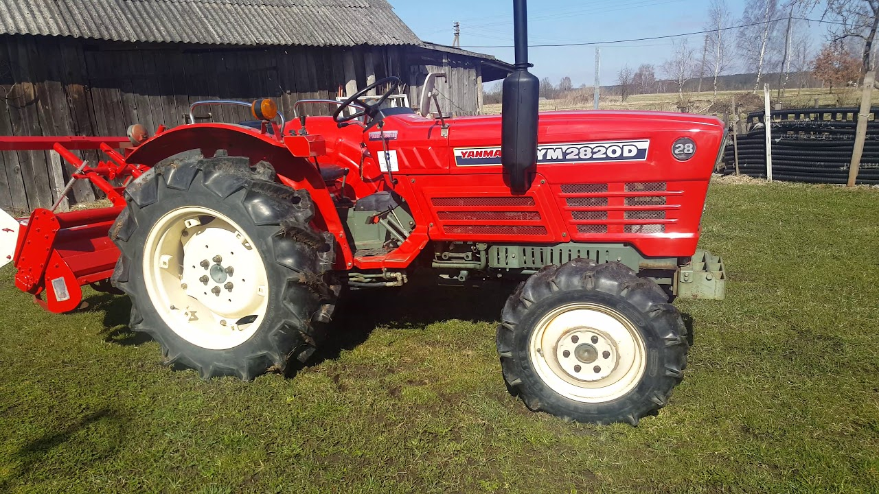

YM2820
Much like it's sibling, the YM2620, the YM2820 has a mere 2Hp more. No other models are to be had between these two numbers. Missing are models in the YM2801, YM2802, and YM2810. For some reasoning Yanmar just skips ahead with fewer offerings.
Fredrick's lists the YM2820 as a rare machine, being it's harder to find even in Japan. Low production run of this model with many neat features. The engine is the widely used 3T84 found also in the YM3000, YM3110 and YM3220. What is interesting with this engine, the YM3810 and the YM3000R has the same 3T84 engine with a turbo. Reading some of the tractor forums in Asia and the EU, people would slap on a turbo to their lower model Yanmars with the 3T84 engines.
Since the YM2820 is a rare machine, the body style relates to the YM2620 and the engine like the YM3000 without the turbo. Being rare, it's a bit of a challenge finding images of this certain model.
We'll start off with a very clean looking YM2820 as a UTDA restored machine.
A really nice one from the eastern EU with it's original tiller.

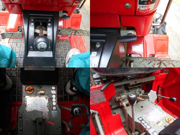

Floor controls are just a grab near your feet.
The dash is very plush with 6 symbol indicator lamps, temp gauge,
fuel gauge, and rpm gauge. The PowerShift is up on the column. This makes for an spacious open cab to walk thru either side.

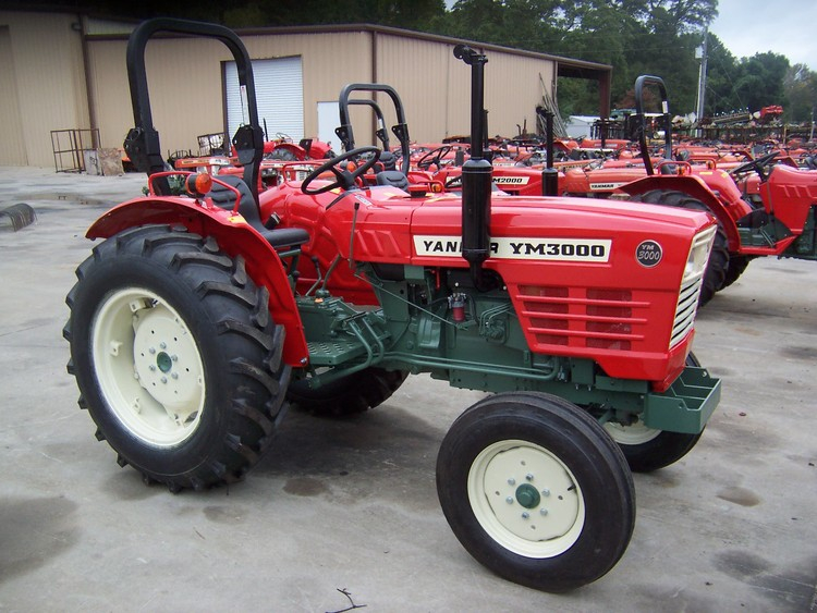

YM3000
This model breaks tradition in the Yanmar model number system. It's the second model ending in -00 to have a 3-cylinder engine, just like it's related YM2500.
What's so special about the 3T84 engine? Well, it has US domestic models with the same engine.
When did the YM3000 arrive on the scene? It was an early bird.
Here is a nice UTDA Fredricks restored model of how this machine looked in it's day.

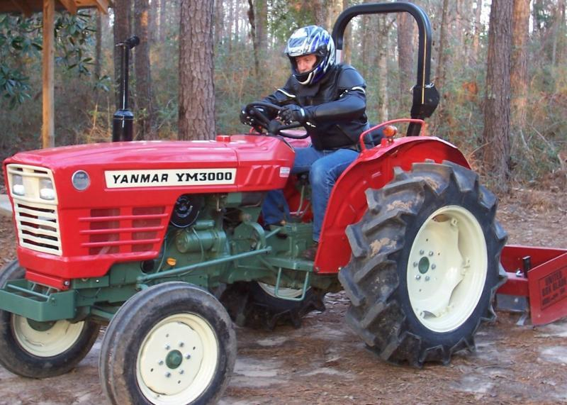

The YM3000 model is greatly admired in Vietnam. There are many instances of seeing these machines in action on video sharing sites.
A nice one out of Poland.

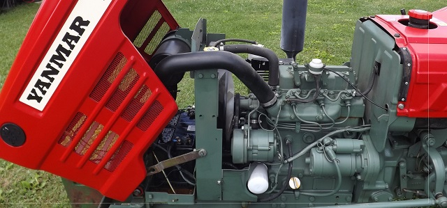

Continuing with the 3T84 engine with tweaks to the air intake and fuel system, the Hp will rise a tiny bit. It is surprising to notice the wide Hp range of this engine. With the many parts manuals, it would be easy to determine a low ended Hp machine to convert to a higher Hp machine. This engine later will reach the 42Hp range. The engine bay layout is identical to the YM2610 with the 3T80 engine.
The YM3110 seems to use the same frame and chassis as the JD950. It shares the same dash panel, gauges and controls like it's younger sibling the YM2610. Indeed it's a -10 Series model in the line up.

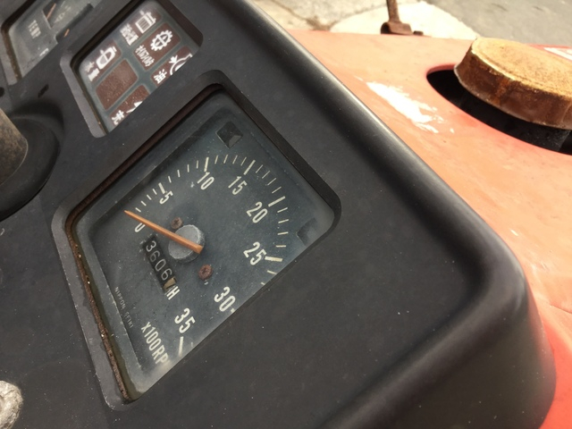

The hour-rpm gauge below operates the same way for PTO performance as the YM2610. See those comments in the prior posting. This makes the machine very attractive for owners who need flexibility.

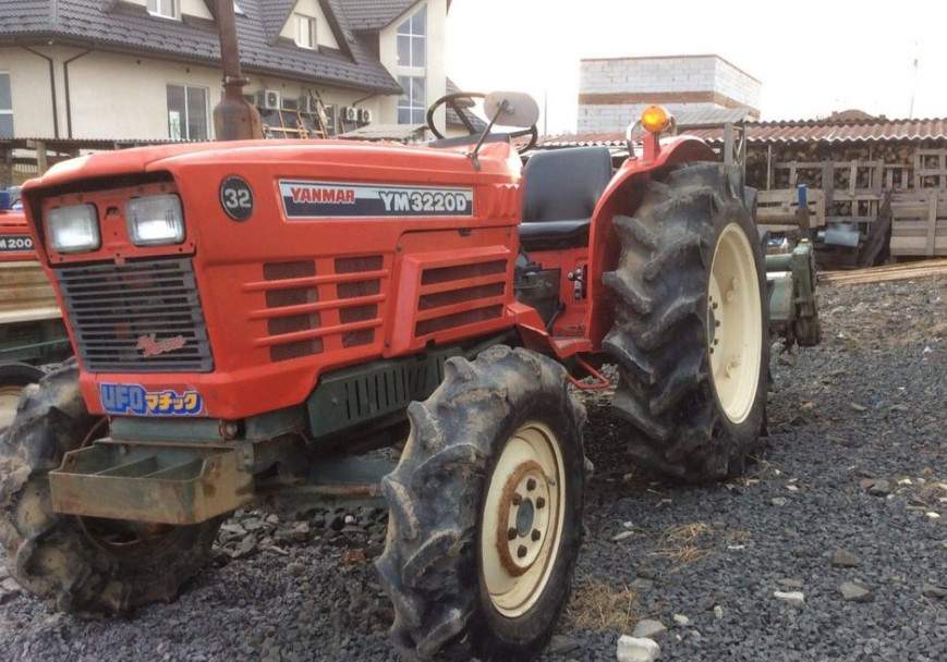

YM3220
In the normal Yanmar fashion, there should of been a YM3120 to compliment the YM3110. A YM3120 would of used the same engine as the YM3110, but had the -20 options. The YM3120 never made it. Yet here we are with a YM3220 with no sibling called the YM3210. One could say the YM3110 and the YM3220 are their own siblings, just a tad out of sequence. Both use the 3T84 engine. Indeed a mystery why Yanmar went this route. It's not like 1Hp would of made all that difference either.
Finding the engine ID plate was not an easy task. This image had to be enhanced just to read it.
The best images of the YM3220 came from a person who bought it from a UTDA dealer down south in the USA. Take note the side engine skirts are painted tractor red like the other panels. This aligns to the factory intent as well and not a mistake. Prior models typically had those engine skirts painted Yanmar off-white.
Additionally, this model has the JD950 looking rear fenders and the original Yanmar step up that John Deere then included in their larger 50 Series machines, then the 55 Series and 90 Series Yanmar had made as well. This is really a bent 19mm [3/4-inch] solid bar with the ends flattend and two mounting holes for large bolts to mount.
Here's the same YM3220 still in Japan untouched by any refurb or restoration facilities in North America. Note the UFO at the bottom from the front grill. This is very important.
The UFO becomes a very popular selling point on the FX FORTE series machines and the most sought after in Japan from any manufacture of tractors. UFO is a computerized link-up to the Yanmar tiller on the 3PT. It's much more than draft control, it handles tine rotation forwards or backward within certain tiller tine groupings, adjusts tiller tine speeds (not the PTO output), allows the tiller to curl towards the tractor or away (similar to a top-link with hydraulics) and much more.
The UFO function here is an early version. Possible less functions than the FX Series. Yet, incredible to see it here on this model.
The best image found at the time showing the UFO controls on the top rear fender.

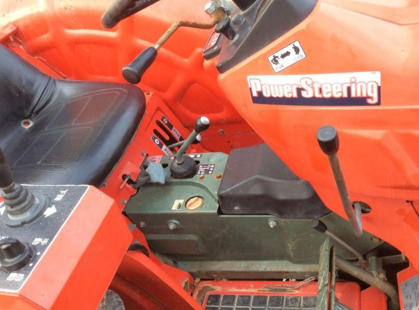

Sorry it's just a glimpse. And notice the factory PowerSteering decal on this model.
Like most of the -20 models comes the push dash with all the fancy gauges and controls.
This image is a rare one as it shows a clear view of the center console. Most of the time images are taken with the steering wheel in the way.
The other dash gauges. Shift is on the column too.

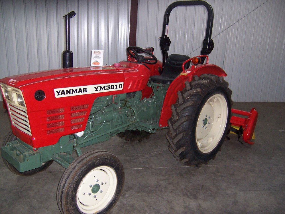

YM3810 intro
This model is the last of the YM--10 in Series. If a person reviews the YM2610 mentioned earlier, there are many traits carried over to this machine with one single difference, the engine is the 3T84T.

YM3810
There are no images on the web at this time showing the 3T84T engine. I had spend a few hours hunting. It would be great to see it from a few positions.
nice machine in Japan.
The machine looks great, the tiller has seen better days.
The layout is like the YM2610 in every way.
Same gauge as the YM2500, YM2610 and other higher Hp YM machines.
Same PowerShift, Gear selections with creeper, brake pedals, accelerator bar, and diff-lock.
Same Multi-speed or Multi-select PTO. See YM2610 for details of hand operation.
Here's looking at you!
A super nice UTDA restored YM3810

Power steering on this one.
