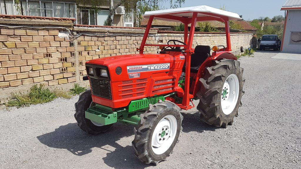

Like the last few machines mentioned, this model uses the 3T84T as in TURBO to provide the 42Hp at the PTO.
On the front grill, the translations says, Hi-Power. It's their way in Japan of saying TURBO.

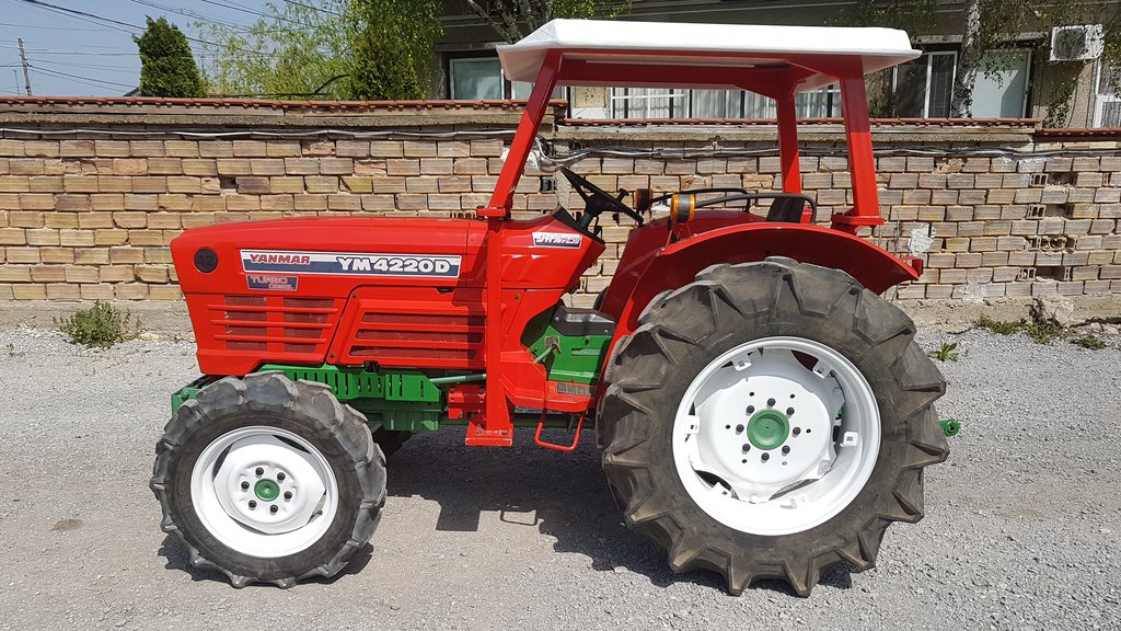

The YM4220 is often seen in Japan with it's sun canopy. Sadly, the Gray Market exports rarely sent the machines over with the canopy due to space in the sea containers for shipments.
There are many good looking YM4220 machines as these were mid to later 80s models. The machine is the Lexus loaded -20 model, those who had them in Japan treated them nicely.

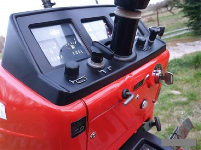

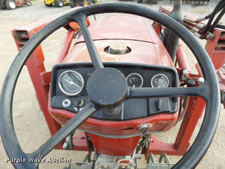

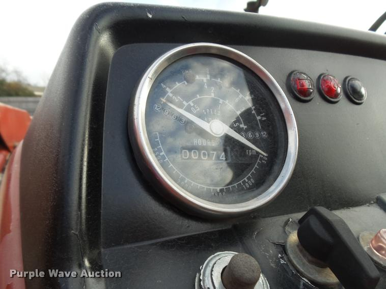

As one would expect of a YM -20 model, the dash and gauges are the plush modern type.
This is the last model to show the Yanmar rising flame between the eyes like many of the YM -20 models signify.

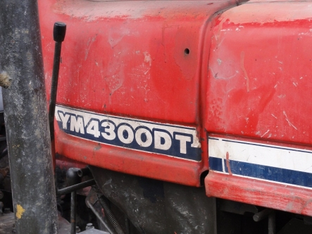

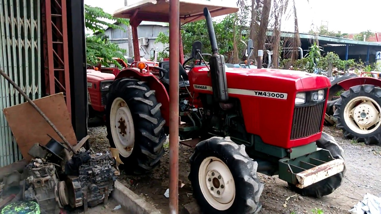

YM4300 aka JD1050
In the Yanmar YM Series two machines are basically direct twins to the JD 50 Series.
YM2500 aka JD850
YM4300 aka JD950 non-turbo
YM4300 aka JD1050 with turbo
The engine is the famous 3T90T or the 3T90 non-turbo.
Why did the YM4300 come with and with turbo? Was it the JD950 without one and the JD1050 with one? Here we can see the original decal on a machine in Japan.
And here we see it without the T designation in Japan.

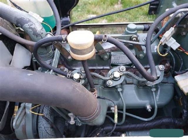

The 3T90T engine.
The turbo and exhaust side.
A great view of the turbo and it's interface to the intake, engine and exhaust. You can read the OE IHI turbo brand in the image.
There are all kinds of controls around the seat and the floor. Looks to have 'draft control' option like the JD1050, 950 & 850 as shown in the TM1192 Deere Service Manual.
Behind the seat is vastly different than other YM models.
The front fascia for the grill is not displaying the HI-Power logo typically found on the Turbo model YM machines. I've looked at many YM4300 Turbo machines on Japan export sites all looking the same.
Many of the YM4300 machines came with the OE Yanmar ROPS and canopy. Likewise the JD950 and JD1050 machines offered this option as well.
The JD1050 has a canopy distinction. The two amber working lights. A Deere trademark in a way of speaking. If you look closely, those seat controls are all there as well.
More to follow in the next posting on the YM4300 aka JD1050 Yanmar machines.

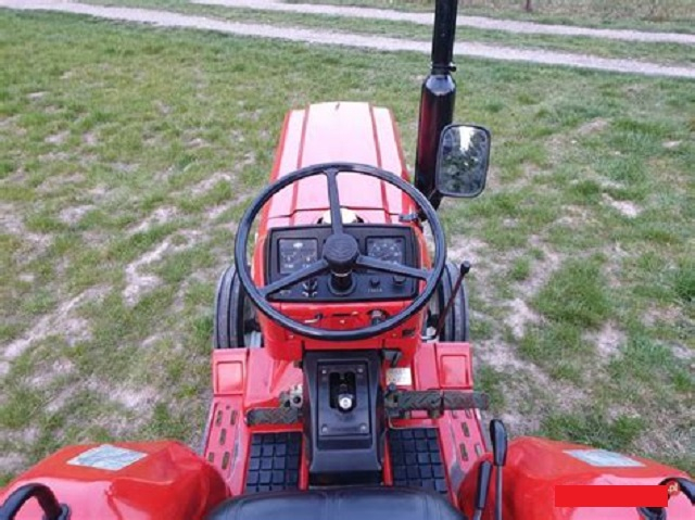

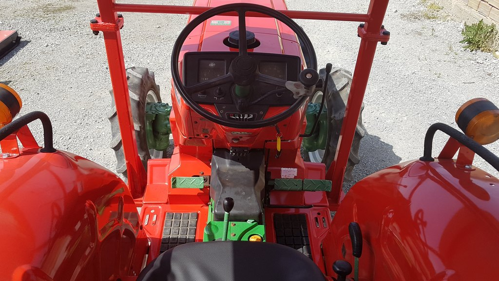

The dash controls on the machine is a bit of lack-luster. It's the common YMxx00 layout.
Another behind the seat images to share. The silver box is really a light. There is a rear port for the tiller UFO connection.
The lever to the right works with the 'draft control'.
Looking just under the dash at the feet are two extra levers. Somehow these are tied into the hydraulics for some function.

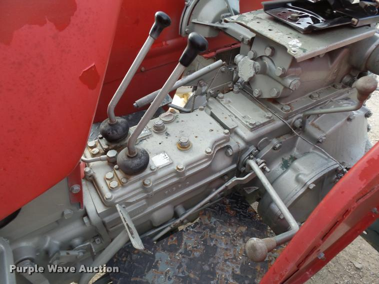

The YM4300 is a typical gear machine. Just like the John Deere 50 Series uses.
4 selections forwards and 1 reverse. And it has a High and Low for both. There is a N designation as well. Would this offer the sense of a 'live' PTO on a geared tractor?

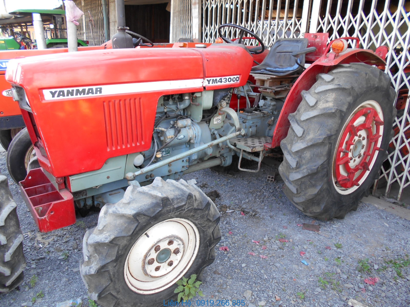

@bmaverick what is the red ring gizmo on the rear wheel i first photo of the YM4300D, in front of the shop in post #86?
Just curious...
All the best,
Peter
/ Yanmar - Model Cover Pages #89

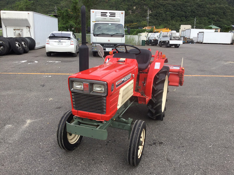

@bmaverick what is the red ring gizmo on the rear wheel in first photo of the YM4300D
Likely the attachment point for rice paddy paddle wheels. I copied this photo off Yanmar-Japan's official website long ago, in 2004.
Considering the other photos in that section, I think that section showed how their export models are used. This might be in VN.
