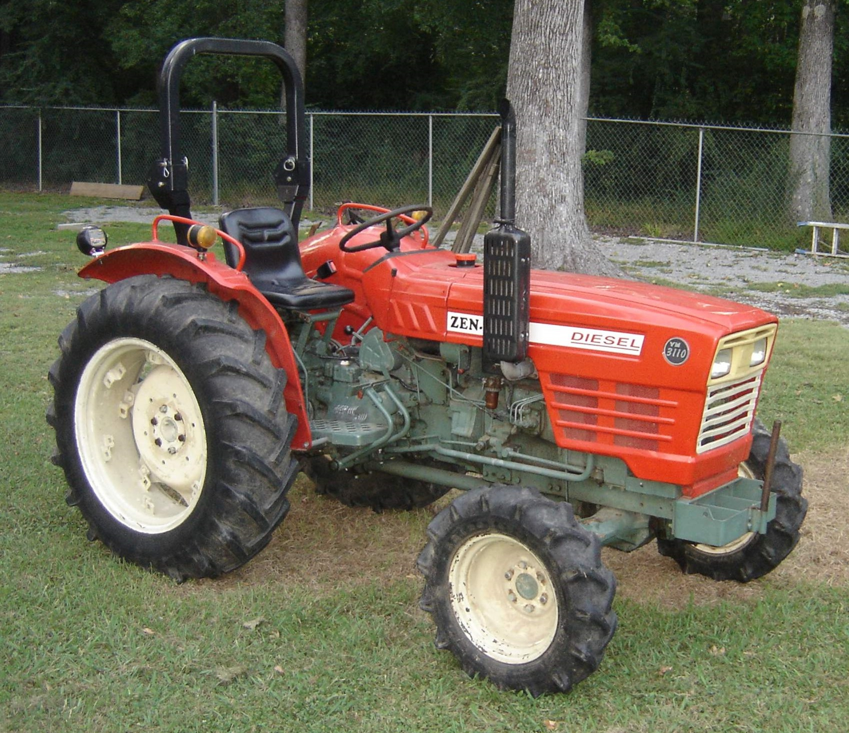

This Gray Market import came from California and refurbished with safety hardware. It's been badge as a Zen-Noh to keep it off the Gray Market import radar. There is a long detailed history on the web with Mr. Mike Wallace and importing a huge number of Gray Market machines to North America. Wallace International Trading incorporated in 1984.

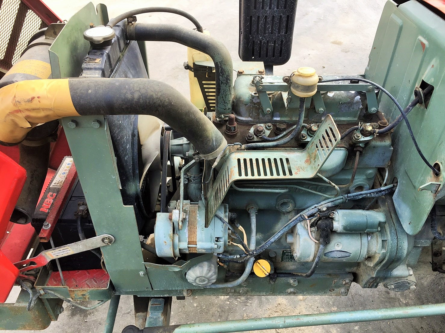

Continuing with the 3T84 engine with tweaks to the air intake and fuel system, the Hp will rise a tiny bit. It is surprising to notice the wide Hp range of this engine. With the many parts manuals, it would be easy to determine a low ended Hp machine to convert to a higher Hp machine. This engine later will reach the 42Hp range. The engine bay layout is identical to the YM2610 with the 3T80 engine.

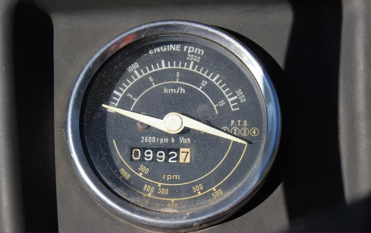

The hour-rpm gauge below operates the same way for PTO performance as the YM2610. See those comments in the prior posting. This makes the machine very attractive for owners who need flexibility.

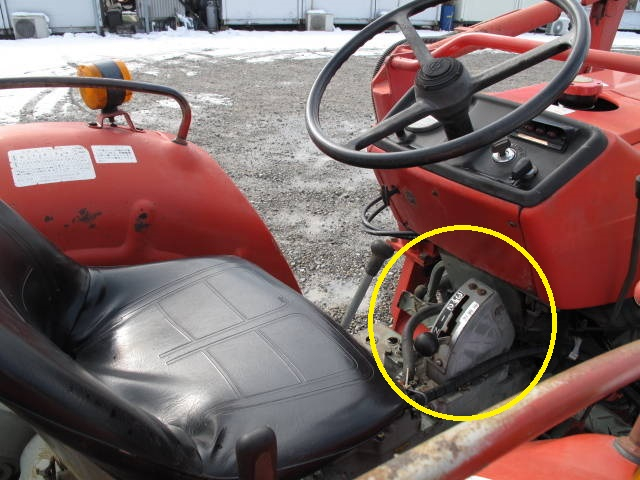

The -10 models with PowerShift are typically on the floor, in a raised housing. Much like the YM2610.

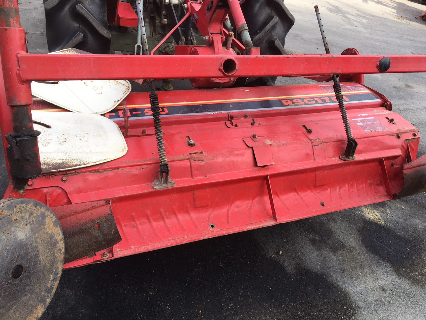

The RSC1701 is a common tiller for this model.

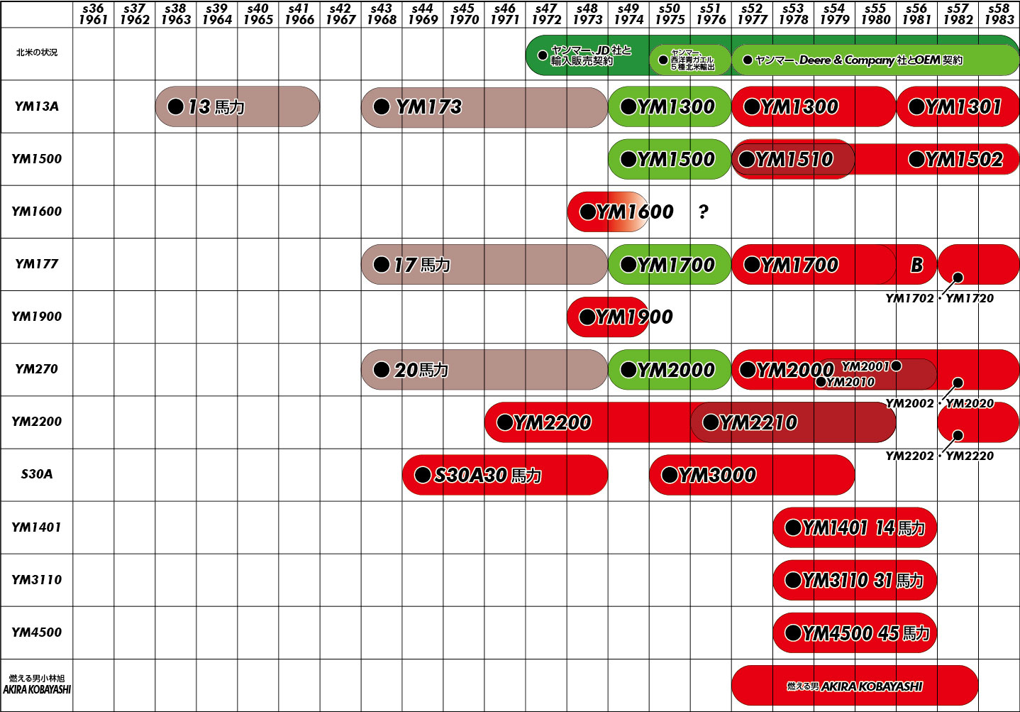

From the Japan history Ag blogger website, the following chart for the YM3110 is listed.
1978(昭和53)年生まれの同期。YM1410/YM3110/YM4500『年表マニアの妄想年表』 | 水戸市大場町・島地区農地・水・環境保全会便り :)

The ending T in the engine ID represents TURBO. It's the IHI RHB6.
Yanmar p/n 121252-18010 for our era and 6T-515 for the current era of this posting.
The manufacture of these turbos is IHI. And the turbo back then is still in production today because it's just too awesome to retire. IHI has a strong American presence, thus getting a replacement is really easy. A bit of the company history here:
The IHI RHB6 is generally found on the Yanmar 3T84T, 3T84T-N, 3T84TJ, 3T84-T, 3T90-TJ engines. People have taken the turbo and applied it in the same manner to the 3T80 with great success.
Note; all the engines mentioned here are of the sleeve cylinder types and not the earlier non-sleeved versions of those engines. The sleeved engines can take the additional increase in pressure and generated heat.
The ID plate and air side intake.
This shows the typical Yanmar 4-bolt exhaust mounting.
(Nearly an easy plug-n-play)

The machine looks great, the tiller has seen better days.
The layout is like the YM2610 in every way.
Same gauge as the YM2500, YM2610 and other higher Hp YM machines.
Same PowerShift, Gear selections with creeper, brake pedals, accelerator bar, and diff-lock.
Same Multi-speed or Multi-select PTO. See YM2610 for details of hand operation.

A super nice UTDA restored YM3810
