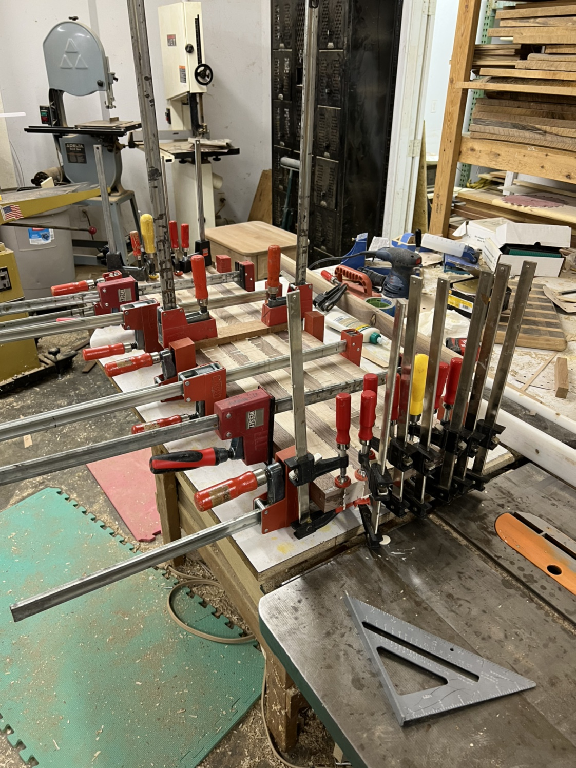

What are you trying to hold? That looks like a gimmick IMO.View attachment 735910
4570, should have started this woodworking earlier, maybe could have just come over to your place and outsourced everything. you have quite a collection of clamps there. We just moved from Franklin TN back Hou Tx...really a beautiful state w all 4 seasons...Middle Tn is really nice.
I'm in the process of trying to design a coffee table w about a 5ft L, 18-22" W and 24" H. I have no clamps right now, but would like to have two 5 Ft Clamps that can ratchet down to 2 ft. Is there such an animal or do 5ft [or the larger clamps] go to only a certain size, and if you need to go to 2 ft, you just use a smaller clamp? thank you

Either pipe clamps or bar clamps are infinitely adjustable. A 5 foot long one will go all the way down to nothing. It’s kinda aggregating to use a long clamp for short clamp work though.

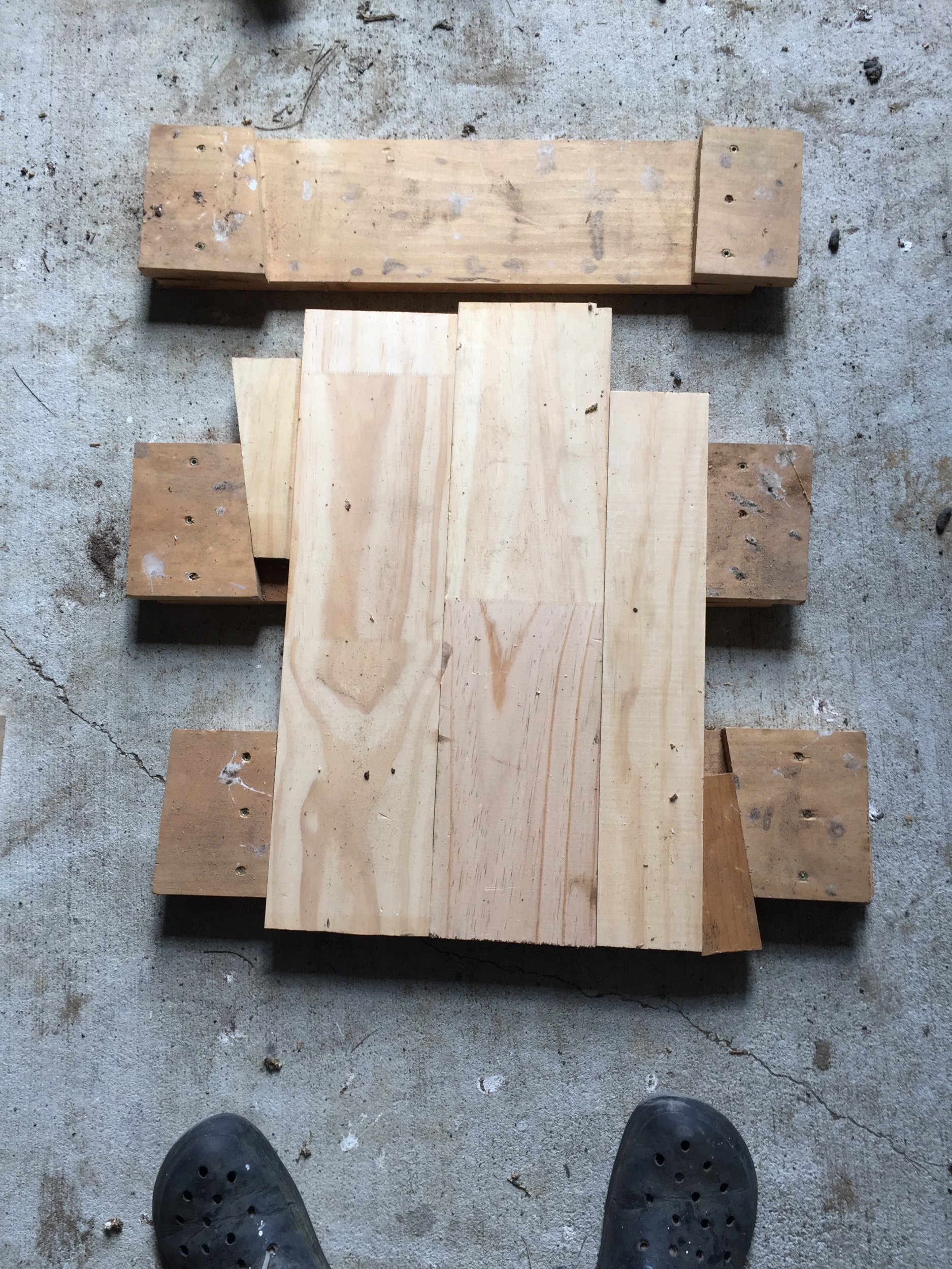

I have never bothered with shop bought clamps I just make a board and wedges as required I have several different sizes put away now that will do most things if I add a packer if not easy to make another set below is not an actual job I just chucked a few offcuts in to demonstrate the principle

I agree with the bar and pipe clamps. With the pipe clamps you buy the end pieces, then go to the big box store for a pipe of whatever length you need. (I have ones from 2' up to 10' - length of pipe is the only limit and pipe sections can be connected together) Jest keep in mind the weight of the pipe and the twisting action and weight of the tail of the clamp. Also, the longer the clamp the more it will flex which may or may not affect your clamping - (usually not) the end pads contacting your wood will rotate some and you won't have even pressure on the pads and you could end up with indents. The way around that is to use a small block of wood between your work and the clamp pad.
Note: the wedges in post #17 work really really well, especially for flat pieces. For furniture, you'll still need clamps. There are specialty clamps for all kinds of things as well.
Thank you. very creative...if you are using really expensive wood or wood that already has a finished surface, how do you prevent from scratching the surface? Have you ever tried gluing felt or something else to the straight edge of the wedge?
