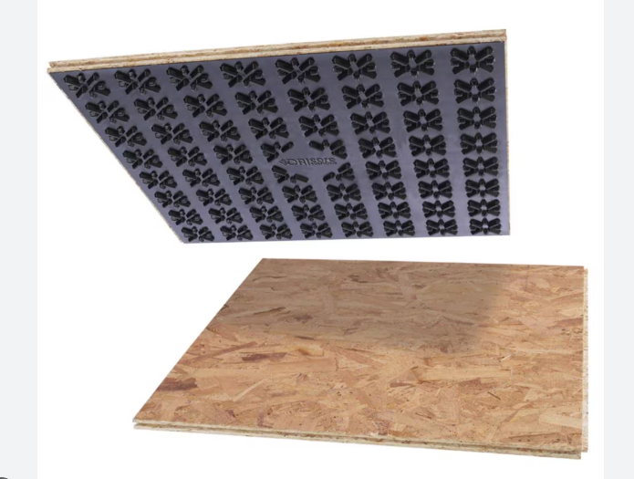

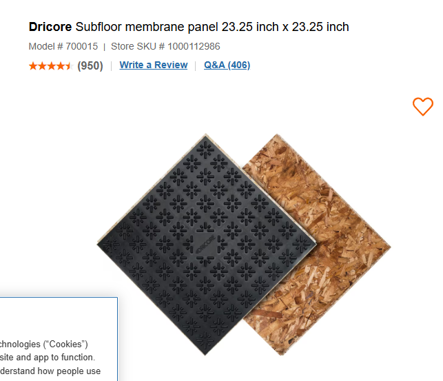

Dricore subfloor panels is an option. Put them down, then flooring on them.
[URLdricore.com/products/dricore_subfloor][/URL]

You need to verify the concrete is dry by laying down some plastic, waiting a while and seeing if there is any moisture coming through the concrete. In any event, I think you will want some type of insulation to keep the floor from being cold and having a lot of temperature cycles. I've used dricore and it's great but you'll get into a lot of cost to do a large area. I think a basement would be better with engineered hardwood or vinyl than maple. I have bamboo (which is an engineered product) in my basement over an insulating pad and it's worked very well for the last 15 years or so.

If you want real wood, the dricore is the way to go with wood over top of it. Keep in mind, you need to keep it somewhat climate controlled, or you will have expansion problems.

I would lay these first that's what they are for, they are no cheep but they cut humidity right out plus if there's minor leak water doesn't touch any wood surface.

I used DriCore panels over a decade ago--never any problem. They allow air flow under the floor, don't wick moisture (if any), and insulate. Plus, they are a DIY project. All you need is a circular saw, a. large square, a tape and a pencil. I put carpet over mine. Highly recommend!!

Dricore is great for carpet or tile, but if you are planning to put solid wood, nailed down, there isn't enough meat to hold it. JMO.
