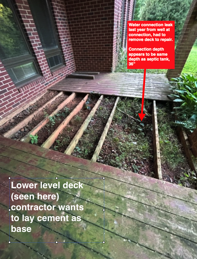

After finding out exactly where my septic tank was last month, ready to have our read deck replaced. It's actually 3 decks off the back of the house, one on the ground outside the basement, one outside of the first floor, and a third one off the 3 rd floor master bedroom.
It's the basement deck that concearns me...

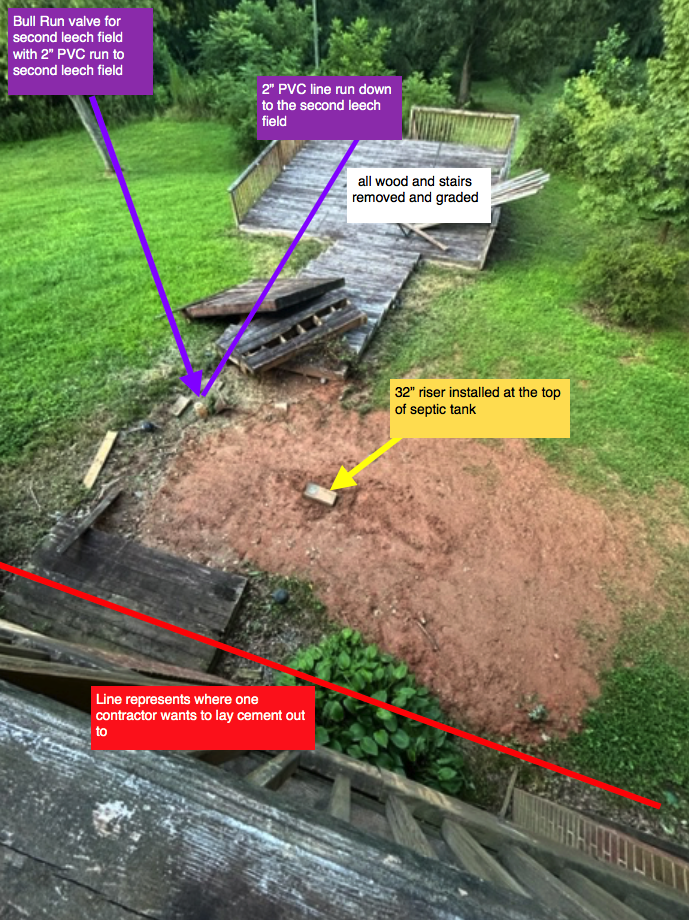

Below looking off the second floor deck. The stairs going down to the hill and the larger deck will all be removed first with some earth work and planting grass.
I got 5 quotes, and two guys came in and wanted to replace the wood at the basement level with cement. You can see in the pic below per the red line, and this is where the one guy I want to go with said he would run cement out to.
Below is my concern with cement vs wood...
Last year, we had a water leak we had to find. It was the well water line coming into the house and we had to remove the decking to get to the connection that needed to be repaired at the connection coming into the house
Two of the contractors who I considered the better guys said they would never laywood in the ground like you see. They both reccomended laying cement to replace the wood.
The concern is if there is ever another leak, how do you deal with accessing any pipes with dealing with cement? Reality is after thinking about it, not certain why the water and plumbing connections coming into the house comes directly behind the house where you'd put a deck, but that's kind of a moot point now because they are laid under slab in the basement anyways.
The basement deck is 11' x 30'.

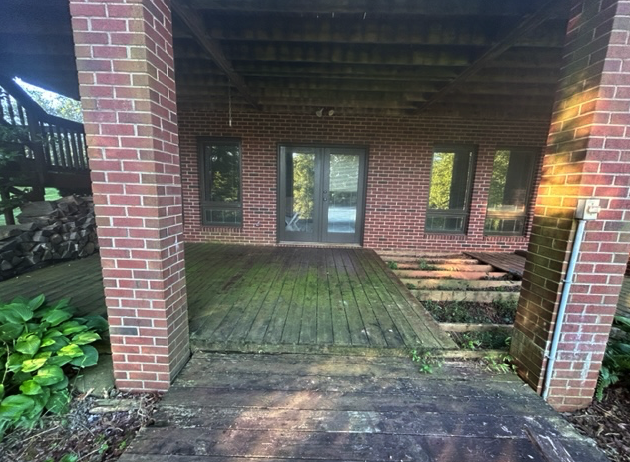

The guy I'm going with came from a reccomendation from a friend in the HVAC field as we were talking about pricing and what some companies are doing out there, and this guys name came out. He came out, looked at everything, and gave me a price that was within 5% of the "second best" company that came out and everyone else had to take a week to get me some numbers back. About 15 years ago I replaced the second and 3rd story deck with a guy that I hired as the brains for woodworking and me helping him labor wise, and a very long story, I'm not going down that road again (you don't want me putting lumber together by myself assuming it will hold, believe me LOL).
Below a better idea of what the basment deck looks like coming out of the basement.
So, would our concerns be justified laying cement? A couple of other companies didn't seem to have an issue with replacing wood at the basement level, and one in particular seems to good local work.

One way of keeping the water line accessible is to install pavers over it. There would be more labor cost, but if there was a leak, they could be removed without having to jack hammer everything.
You could do a design that uses concrete for the areas that you don't need access and use pavers for the area where you need access.
They need to be careful to pitch this away from your house to carry water away from it.

Hmmm. Having water and septic lines in poorly accessible locations isn't exactly a design goal of mine. I wouldn't put concrete there.
Personally, I am not a fan of wood on grade, and I like to see ventilation under a deck to help keep it drier and last longer. I like @2manyrocks thought of using pavers. It would be much easier to get under them if you ever needed to. Get the right slope on the area, compact it, put landscape fabric / geotextile down, add 4-6" of fine stone (1/4" minus or sand), compacted well, and you can lay pavers pretty quickly.
If you go the wood deck route, I would think about some footings to keep the wood off the ground, and design the joists and deck such that it would be straight forward to cut into the deck if you ever need a repair.

Thanks guys. All of your comments I thought about.
When first "pitched" on concrete idea, and it was something we didn't considered and really liked the idea.
After giving it more thought, it seems that concrete raises more potential issues than wood given if anything needs to be accessed under the "deck".
We've been here going on 19 years now and only had the one issue, but if another issue comes up, that's the rub.

That space under your deck doesn't look like it gets used much, but I could see it being a very nice outdoor space.
I wouldn't use rectangular red brick pavers for the entire area because that would be too much of the same relative to the brick on your house. It could also tend to be overwhelming if the pavers were laid out in a strictly rectangular layout. I think you'd want to vary the lay out for visual appeal. You might consider larger pavers or perhaps pavers that mimic the style of grey cobblestone perhaps laid out in a running bond pattern. There might be some kind of visualization tool that you could try out different styles and colors to help you pick what looks the best.
You could also concrete the area where there is no need for access, but use pavers over the area where you need to retain access.
If you don't intend to use this as outdoor space and only want something under the deck to deal with the grass not growing there, you could put down heavy landscape fabric and use pea gravel as a ground cover. It would be a pain to remove later if you decided that you really wanted to use this area as outdoor space and then put down a solid surface. It also tends to spill out unless you have a good way of retaining it so it doesn't do that.
Why did the concrete guys want to extend the concrete past the existing deck line? That would seem to be totally unuseable space?

I would never install wood in contact with the ground. A few ideas, some of which have already been mentioned:
1) pavers
2) a solid edge border and tamped/packed crusher fines on top of weed barrier fabric.
3 a deck resting on low concrete pillars and treated wood joints, decked with plastic wood
4) plant grass and build a deck elsewhere

I think I would grade that area away from the house for drainage, lay some pretty stone (gravel), and do pavers as a path between the back yard and door.
/ Question on deck build sitting on ground #15
The moisture, mold, critter, replacement work etc is why I would do the gravel.
PS...I would never build a deck on the ground like that.

I think that if it was me, I would pour concrete. In my experience, it's not too hard to cut out a section of concrete to get a water line, then pour concrete back into the hole.
What happens most of the time when there is a leak under the slab of a house, they just cut the line going to the house, dig a new trench to where they can bring it into the house, run it up through a wall and into the attic, or the ceiling of the first story. It's pretty quick. Then the home owner calls me to come fix all the sheetrock.
