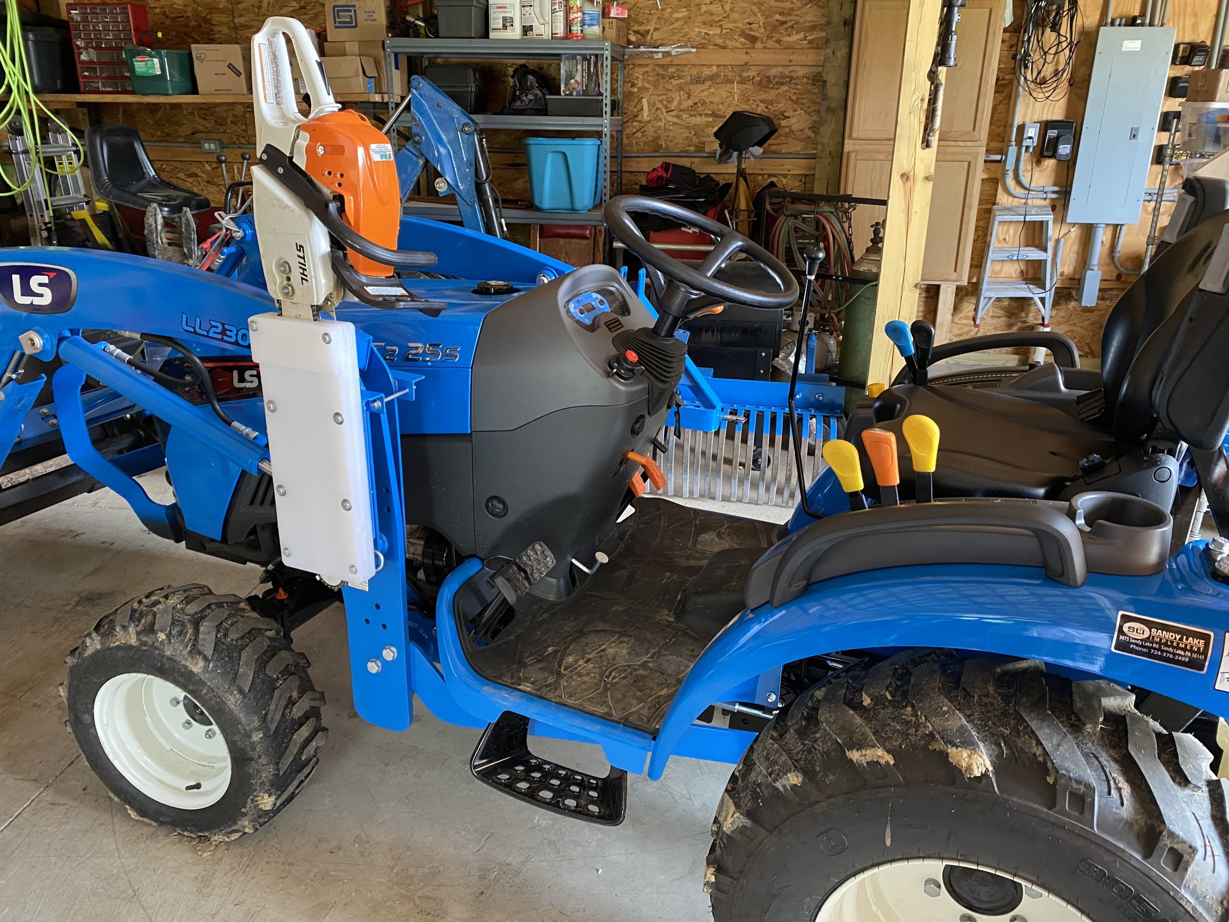

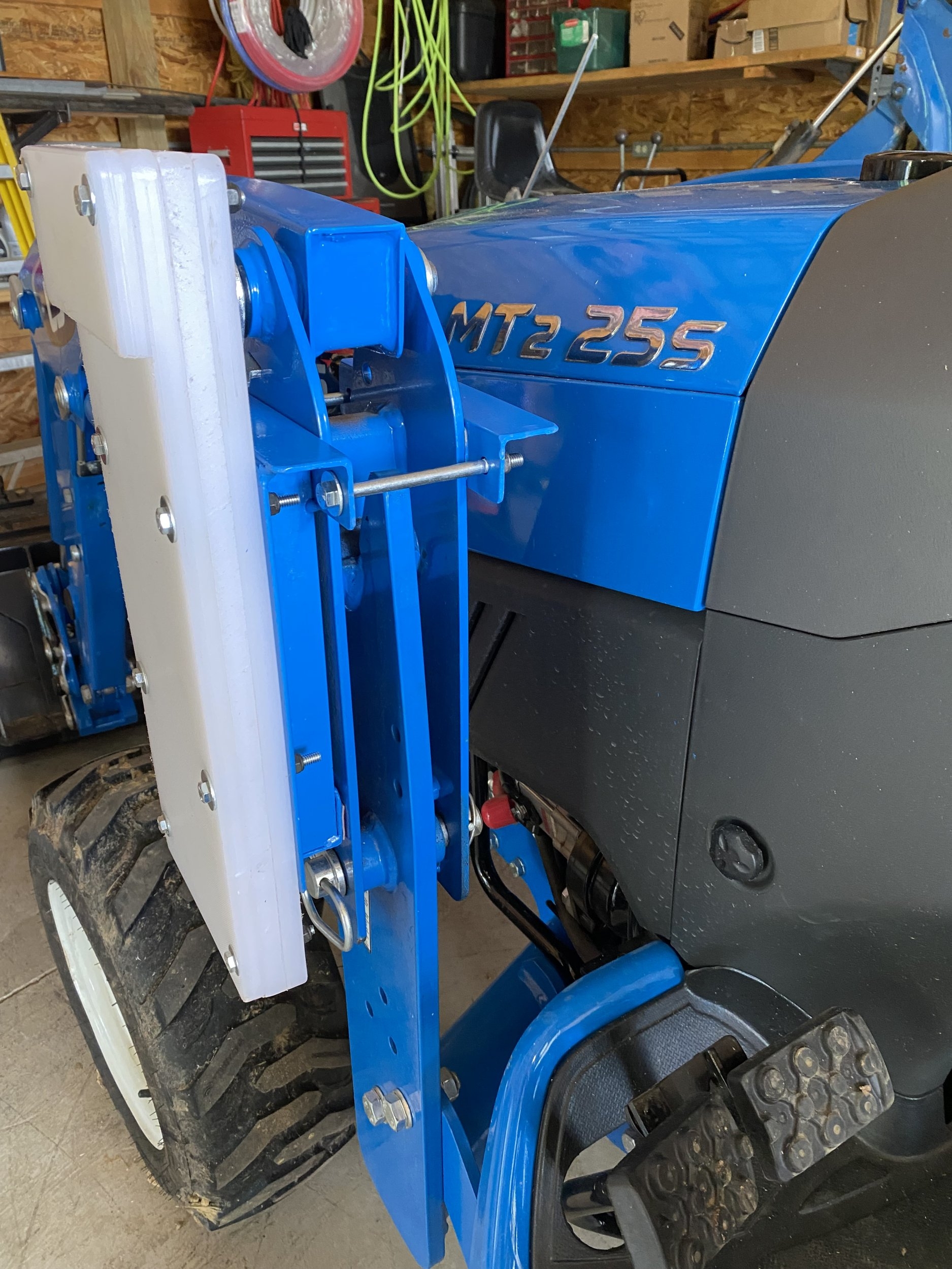

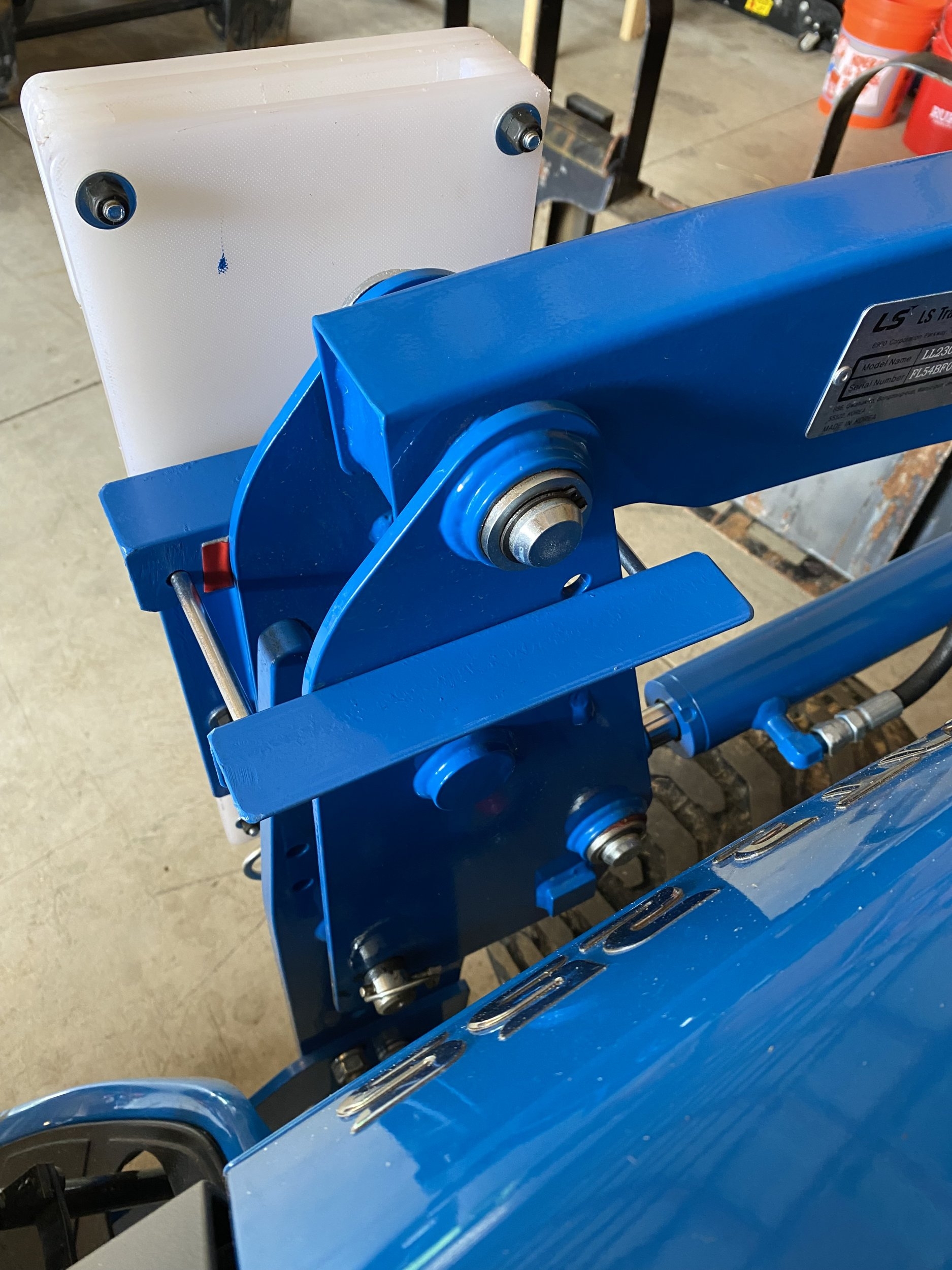

While cleaning up my log pile this week, I decided to build a chainsaw scabbard for the new little tractor. I used an HDPE cutting board half inch thick for the scabbard section and 1/8" x 1.5" angle iron for the bolt on frame. It's a clamp style fit so I didn't drill or weld on the Loader mounts or frame. My saw is a Stihl 291 with 20" bar. I used 1/4" bolts on the scabbard and 5/16" x 5.5" long bolts for mounting the steel frame. I have less than $25 invested.

Looks like with your loader arms all the way up it may hit your saw.
/ LS MT225S - Chainsaw scabbard
With the saw engine on the tractor side there is interference with the loader arms above the 5 foot high mark. With the saw engine placed on the left outside as shown, there is no interference at all. The extra top HDPE strip is for the tooth bar for outside engine orientation. Great observation! Thanks.

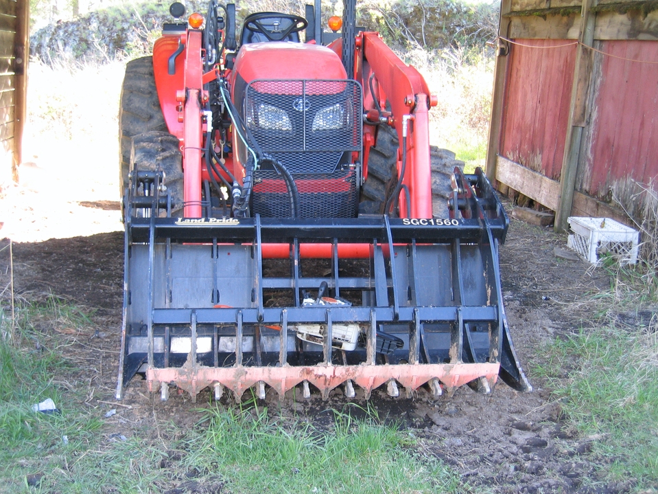

Thats great. Ive lost a lot of chains forgetting they were in my loader bucket.

that's great if you never use your grapple while your cutting.

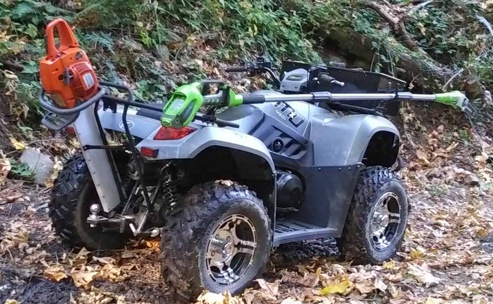

I used the same HDPE plastic for my ATV scabbard, but I salvaged it from a burst water tank. Would love to see pix of what can be done with custom-formed PVC pipe.

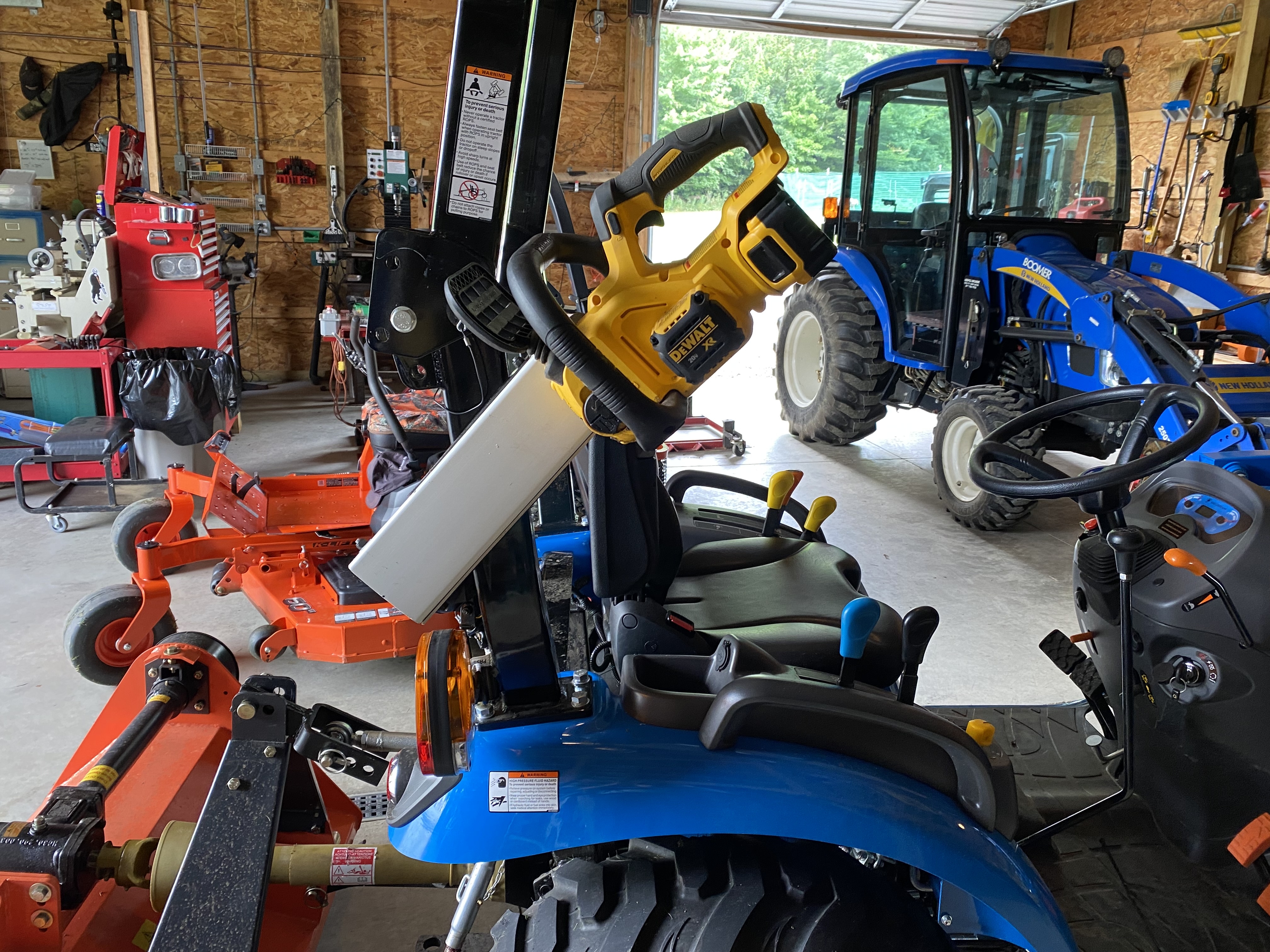

Not the perfect spot for a chainsaw but I use the ROPS for my small electric saw.
