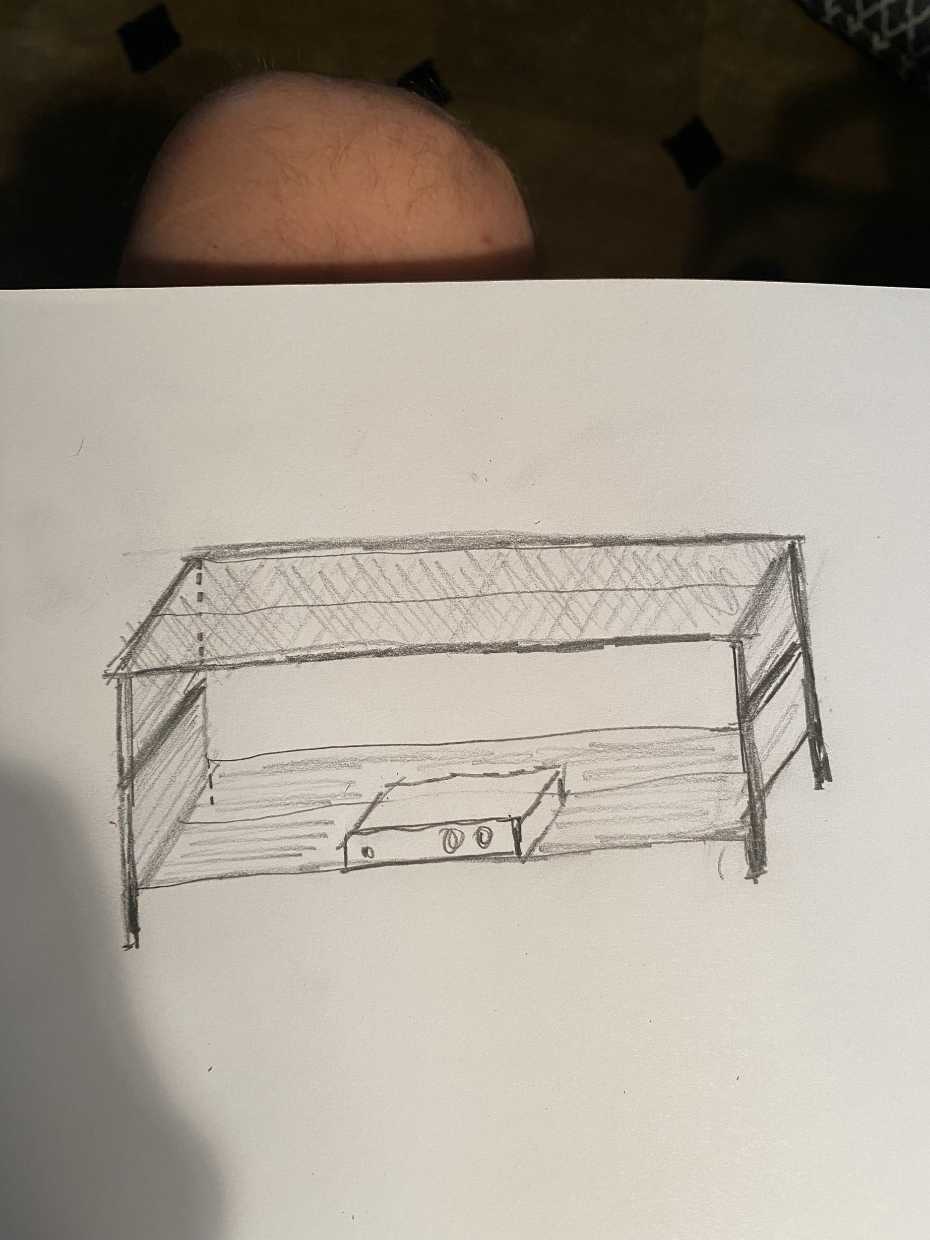

Finally, I would really appreciate all of your input on the coffee table design. Should I start a new thread for that? If shop shelves I made, they were all screwed together; for this project, I'm going to obviously have to make dado/rabbeting cuts and I rather be corrected on paper now than have to redo the table.
Thanks a million and pls advise.

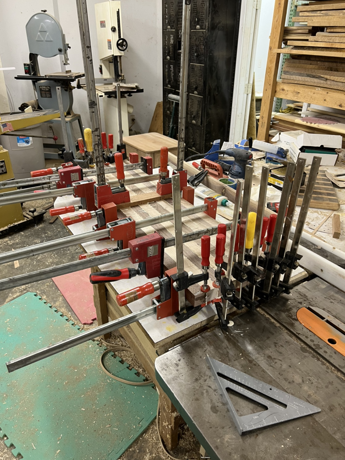

If the OP is new to woodwork he should go to the internet. Lots of descriptions on glueing jigs and building your own clamps. Building your own is quite easy and you can make them stiffer than a pipe Clamp. Also much cheaper and can be sized to fit.
Keep in mind cauls for flat board glue ups. Saran Wrap use can aid in cleanup.

what kind of clamps work best depends on what you're making. I make a lot of cabinetry type projects so I have a bunch of Bessey Kbody clamps, they work well every time, but aren't cheap (I purchased most of mine at various clearances over the years). good quality f-style clamps are also useful. Jorgensen at Lowes, Bessey at HD are good. Corner clamps I often use the Bessey corner clamps. but if you just need to hold something square, there are lots of jigs on youtube on how to make your own along with a couple of clamps....something like this
(there are bunches of variations on this)

I use only bar clamps for edge gluing panels and Wooden Handscrew clamps for surface gluing. Always worth the investment.

I love this picture.
It does beg the question “Can one have too many clamps”?
Of course the answer to that question is “NO”
only when I'm tripping over them because I don't have room to store them all...
