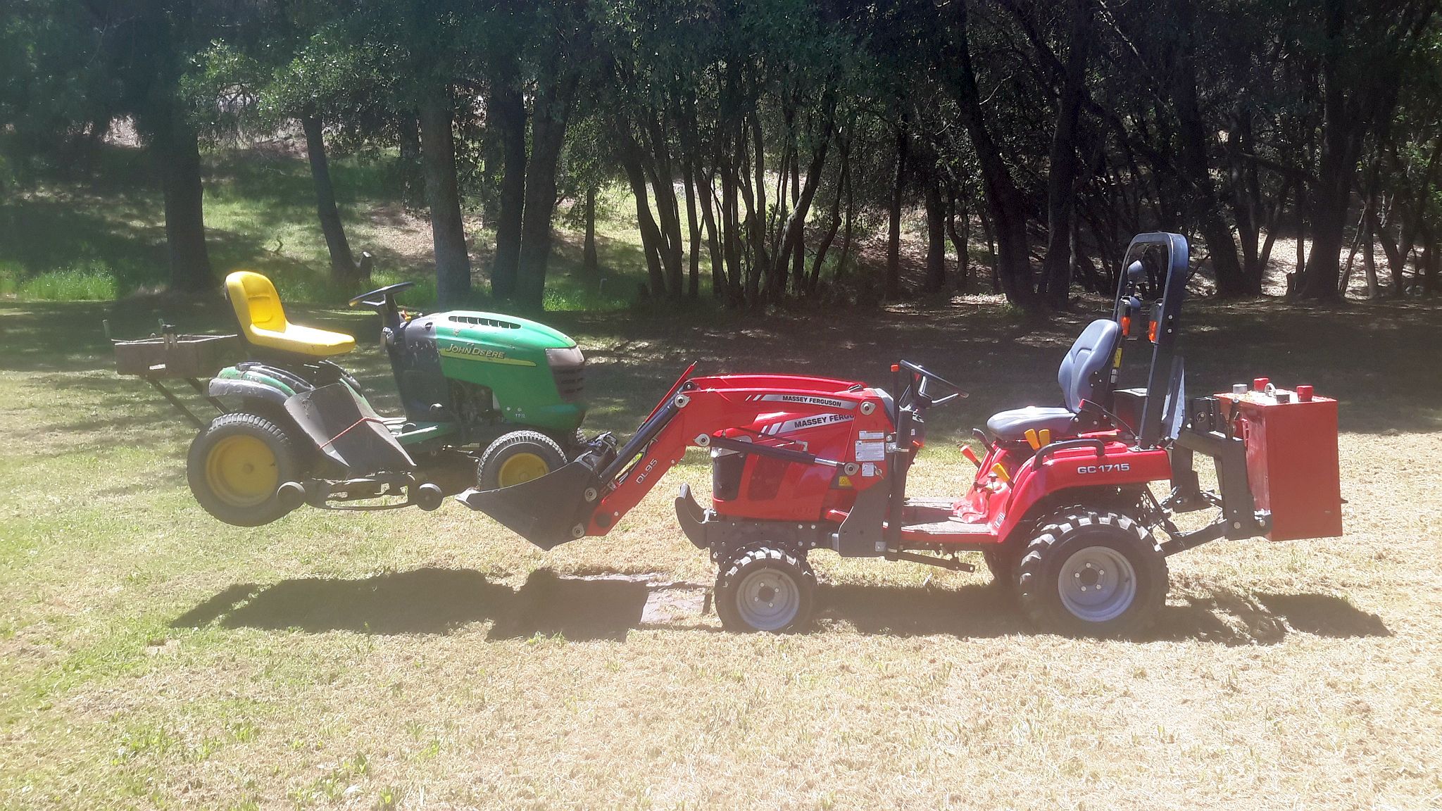

My itty bitty SCUT will lift 800 pounds at the FEL..... Think your tractor might have a problem that even a SSQA is not going to help....
(before everyone gets their panties in a twist, this was staged [under controlled conditions] as an example for need of ballast box)
520 pound (by JD manual) mower..... Need to have rear ballast box to do it though....
