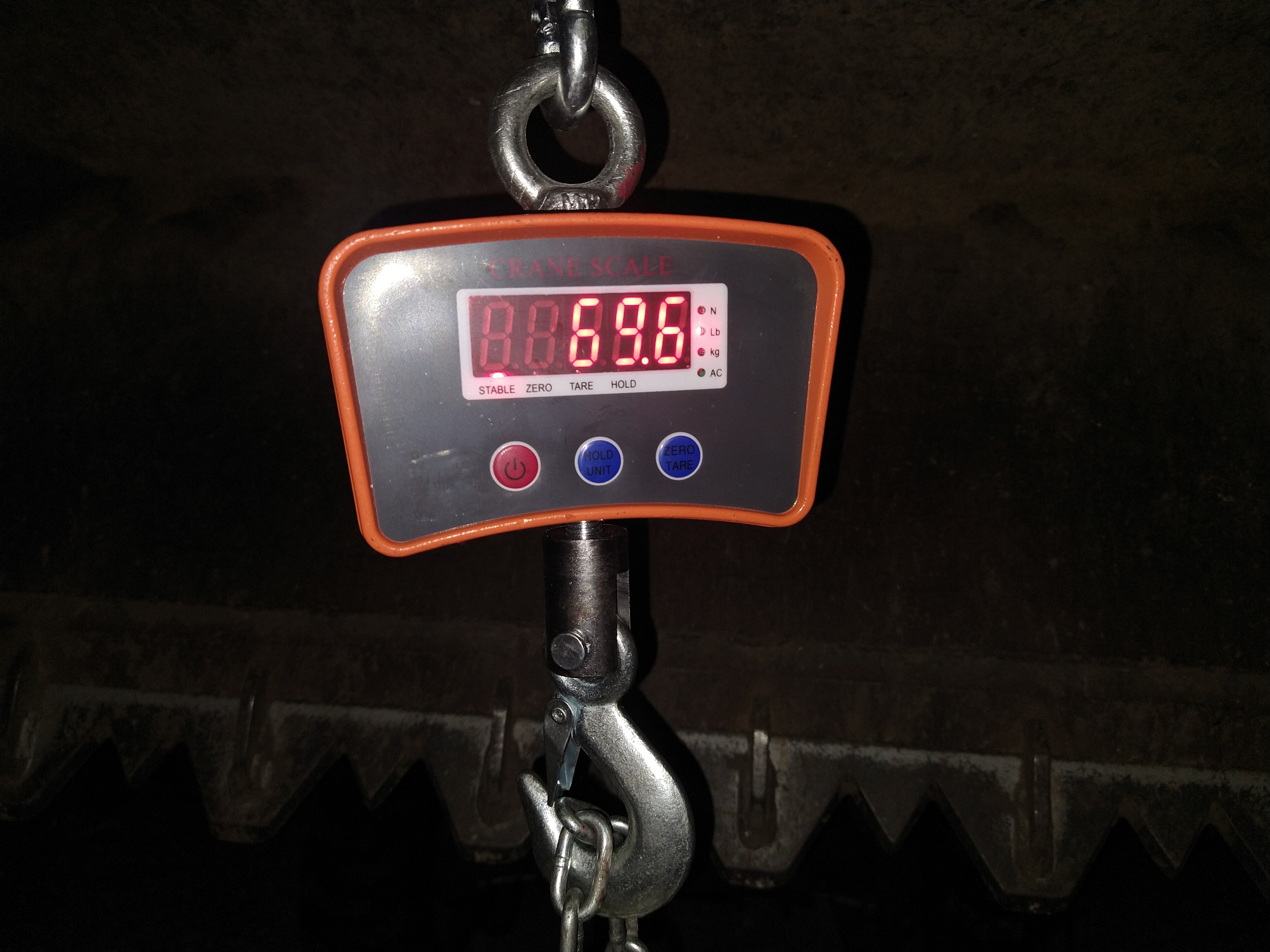

Then I weighed my newly built ballast box for my SCUT ... I had to take off the bucket as it couldn't lift it otherwise ... 707.0 Lbs.
Then I weighed the factory 48" bucket which I had added a Bxpanded Piranha Tooth Bar too, plus two of @kennyd Bolt On Hooks and a receiver hitch ... 189.0 Lbs

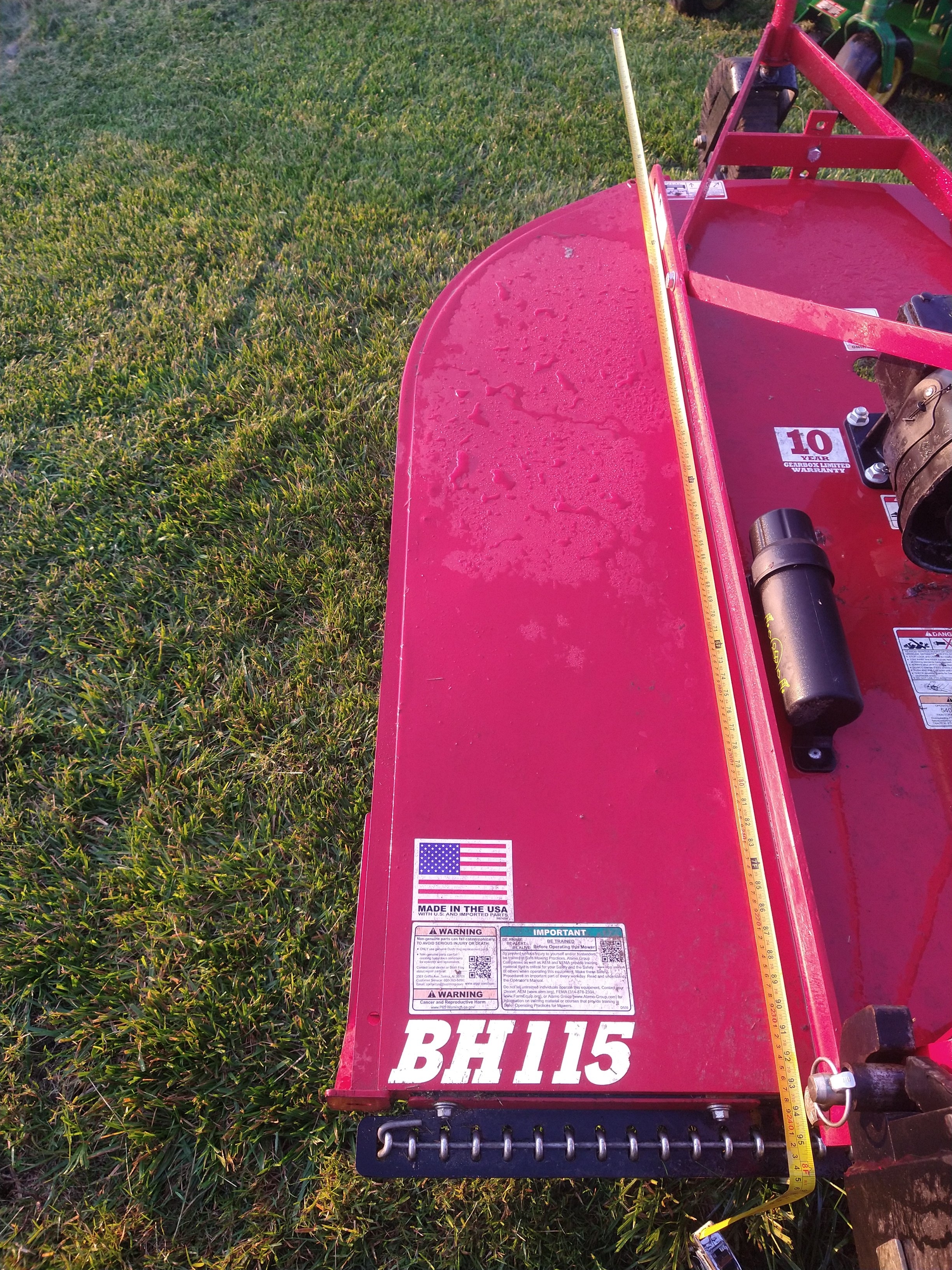

No pictures of my Bush Hog BH115 5' rotary cutter, but it weighs 518.4 Lbs.

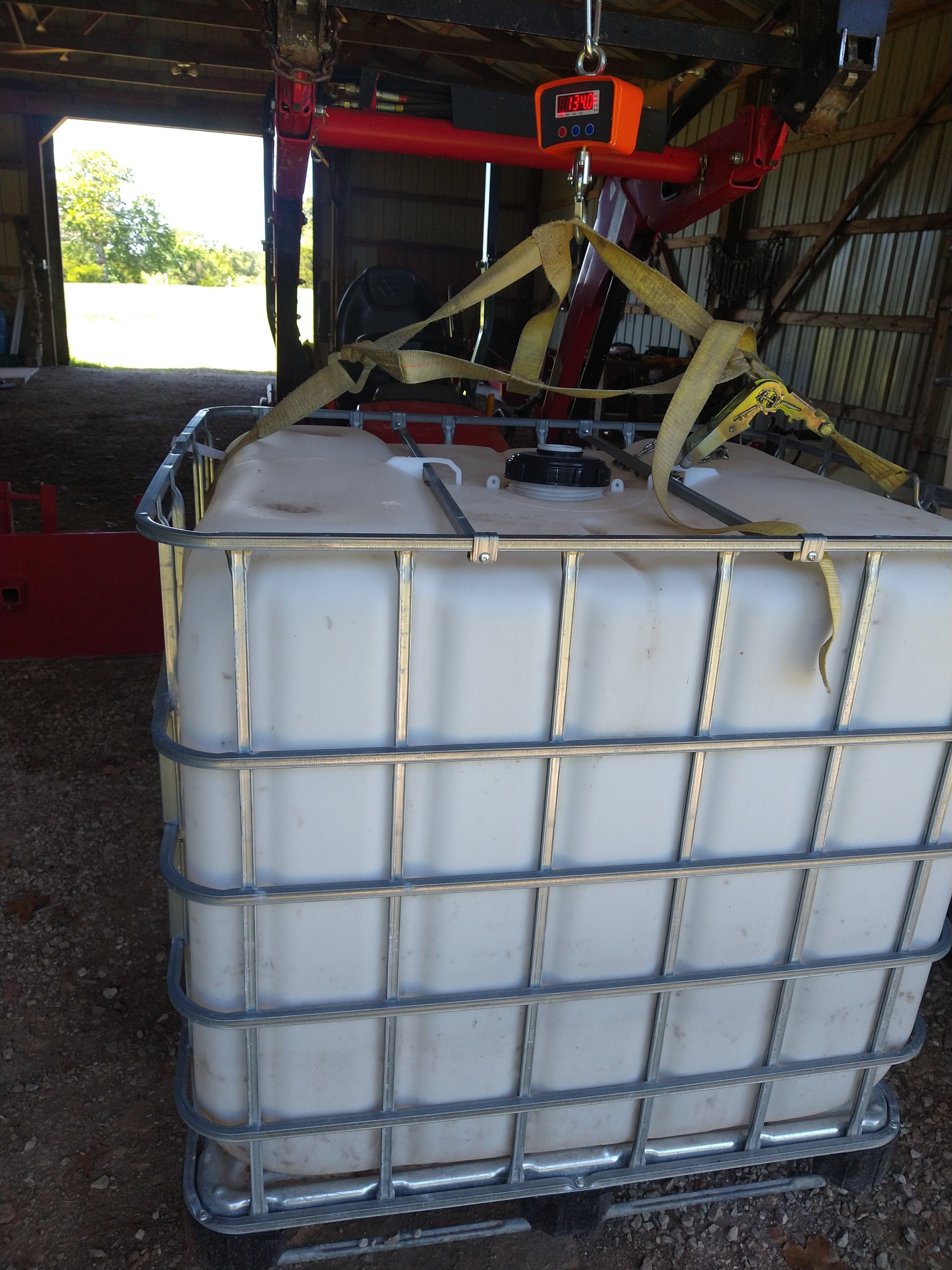

A 275 gallon tote 134.0 Lbs.

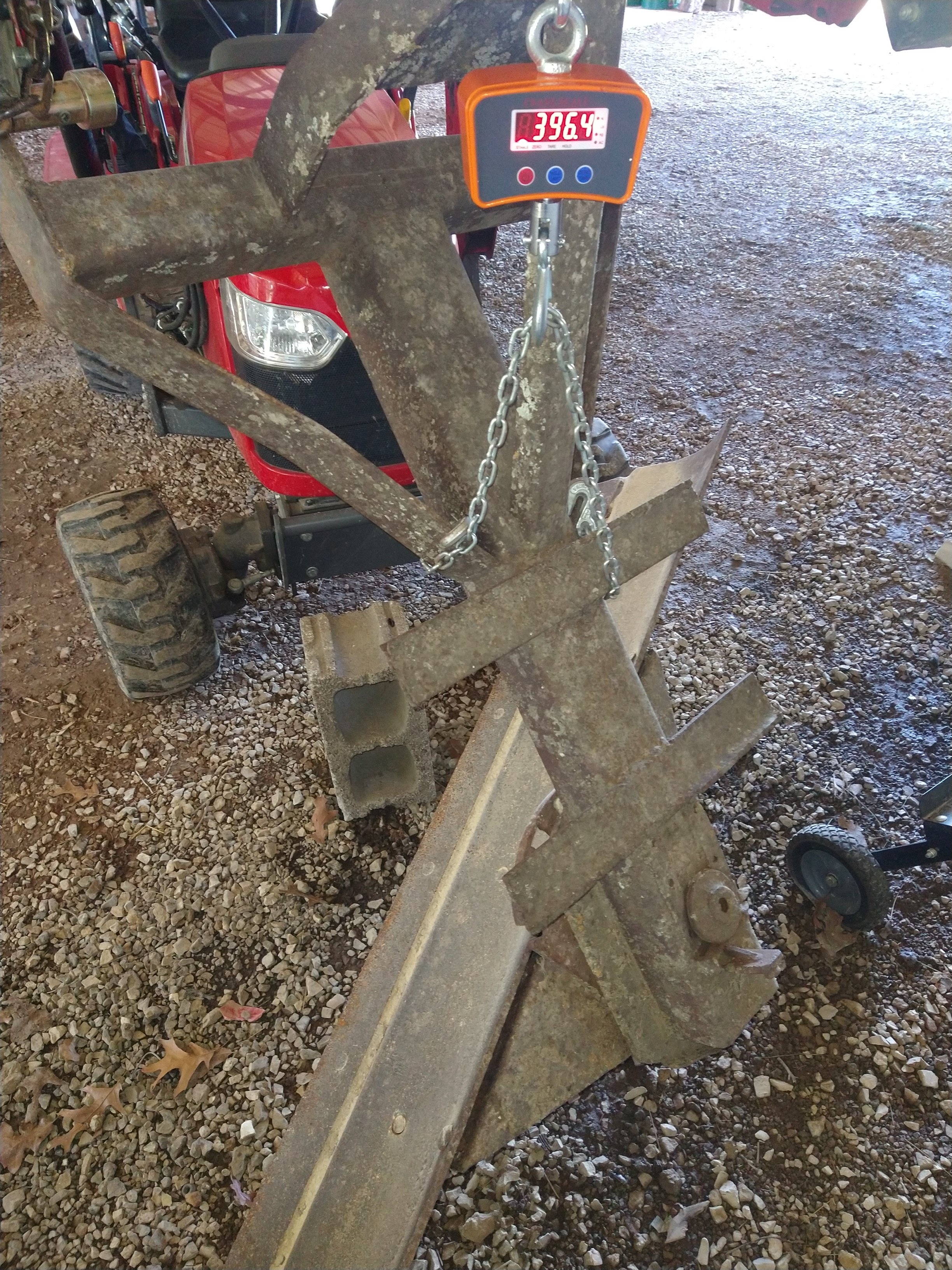

An old CAT 1/2 72" rear blade that I found out in the weeds and puckerbrush when I bought this place ... 396.4 Lbs.

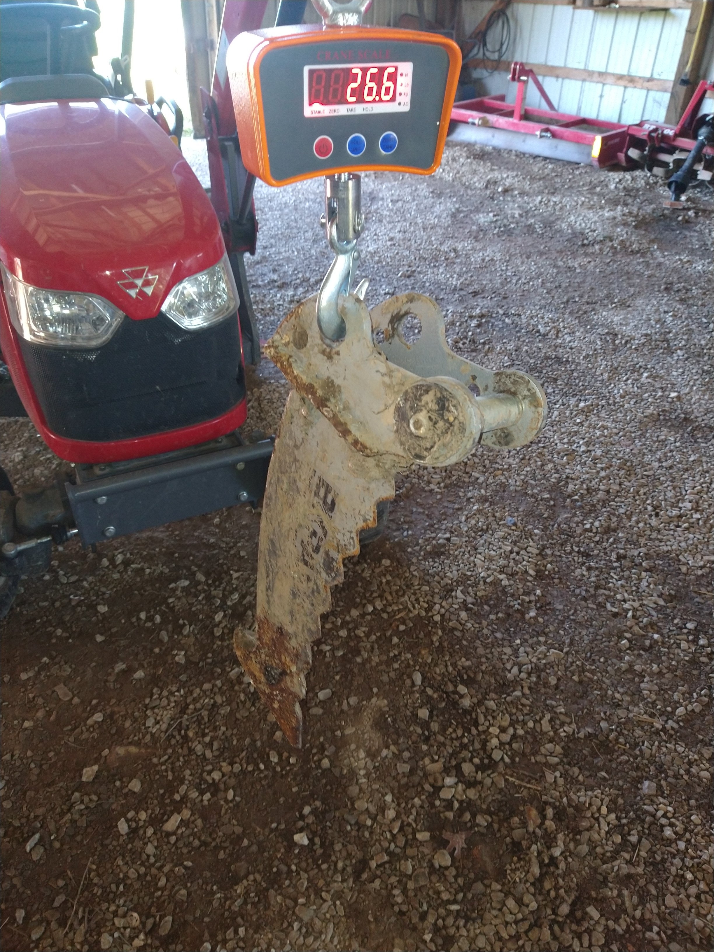

Bxpanded ripper tooth for my BH 26.6 Lbs

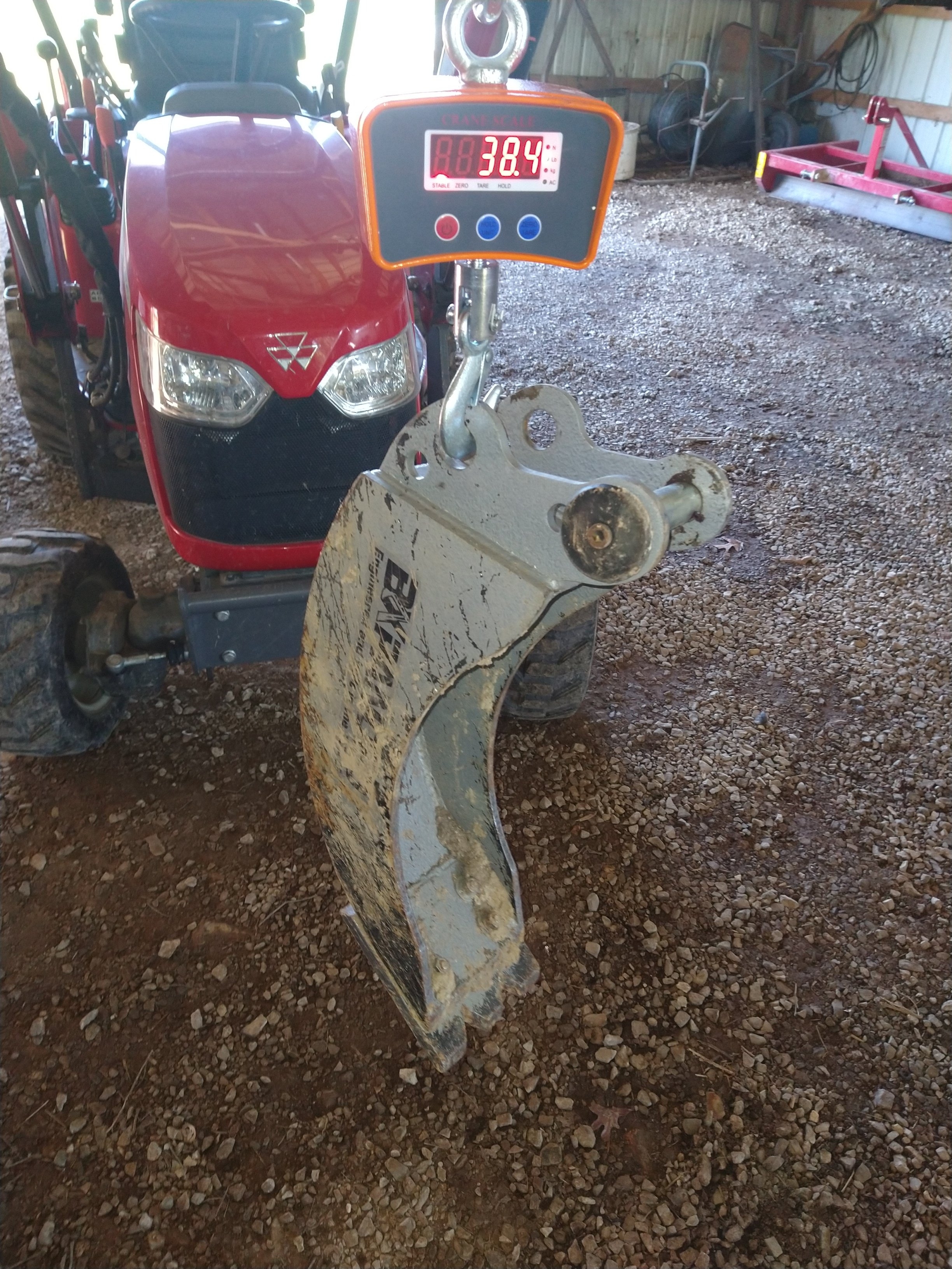

Bxpanded 6" trenching bucket for my BH 38.4 Lbs.

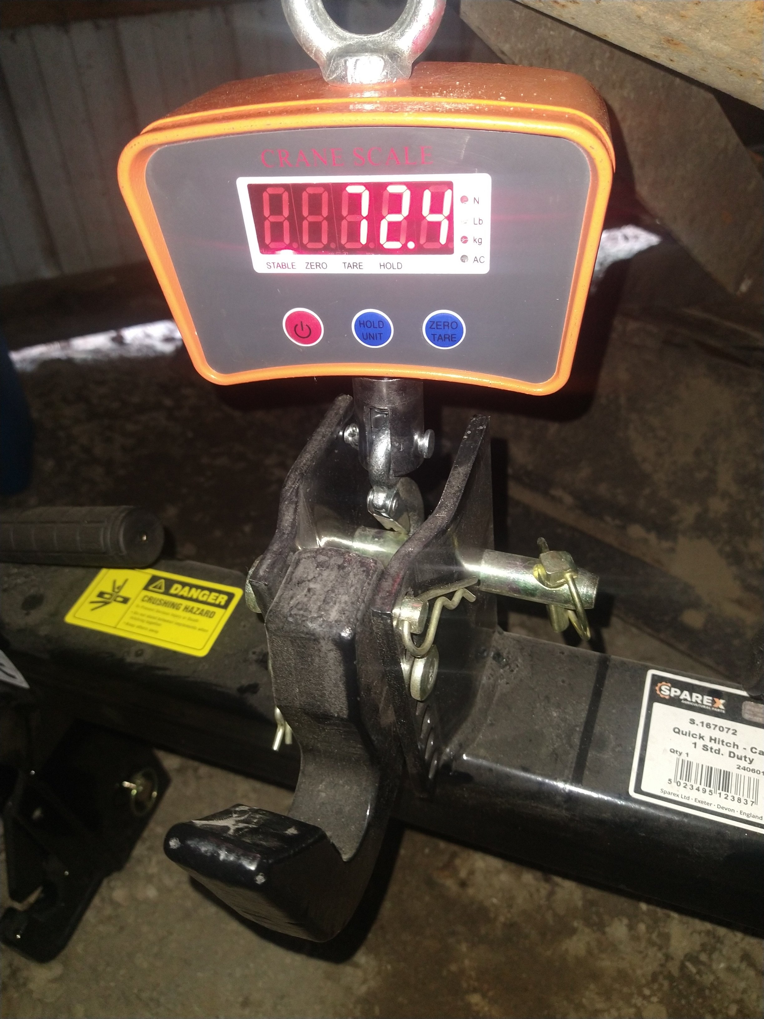

It was tough with the back lighting to get the AgSMArt CAT 1 quick hitch, but it weighs 69.6
I got another quick hitch for my Kubota, also CAT 1 ... This a tad heavier at 72.4 Lbs.

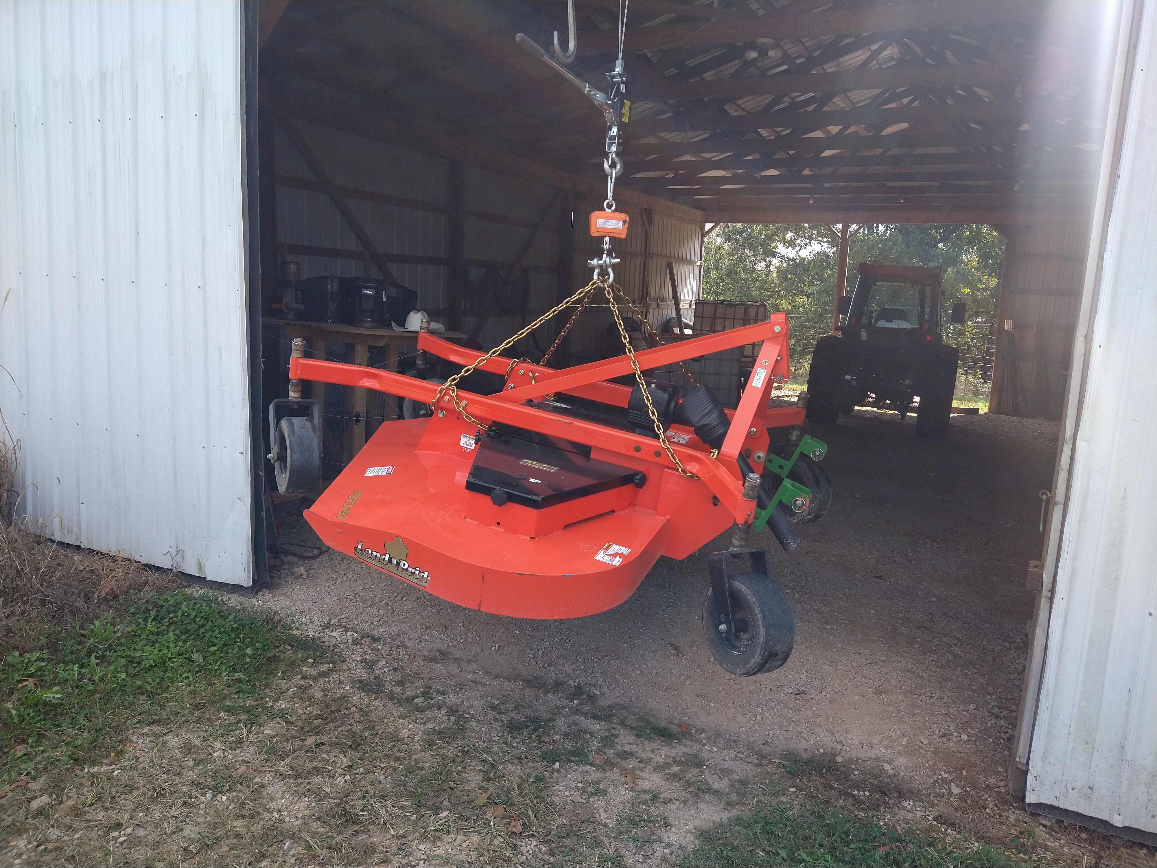

A Land Pride FDR3690 a 90" rear finish mower, hard to get the numbers to show up in the lighting ... 1102.0 Lbs.

When weighing the finish mower, I did it on conjunction with lifting it up off my trailer when I brought it home ... As my little SCUT wasn't up to the task ...
To run the come along to lower it, as it was quite a ways off the ground, I decided to brace one side of the deck with the forks, and stand on the deck ... The scale is rated for 500 KG, and that's what it said it weighed, but when I stepped my 200 Lbs on the deck ... "We got a problem Houston"!
The supplied aluminum carabineer started to stretch! I quickly grabbed a little chain and bypassed the scale!
By the time I got it on the ground, and the chain had tightened up, it was worse!
I guess it was just barely rated for the 500 KG - 1102 Lbs, but no safety margin!
I have since bought a steel screw style rated for 3600 Lbs!
