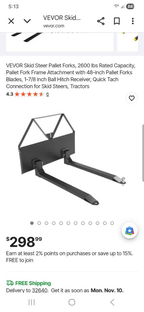

When the FEL forks won't lift a heavy pallet, I put the forks on the 3pt hitch with this adapter:
The 3pt will lift 1000# more than the FEL on my L6060. Not of any use for stacking pallets, but great for moving them around.
Also makes it easy to add or remove rear ballast when necessary. I leave the forks on the 3pt when not using an implement. That way, I can use it to carry a tote, a portable workbench, or palletized implements like a sprayer or generator.

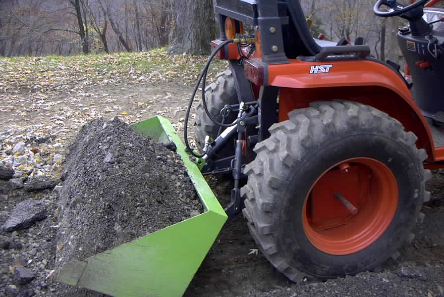

With my hydraulic top link, I can even carry the FEL bucket on the 3pt and use it as a scoop.

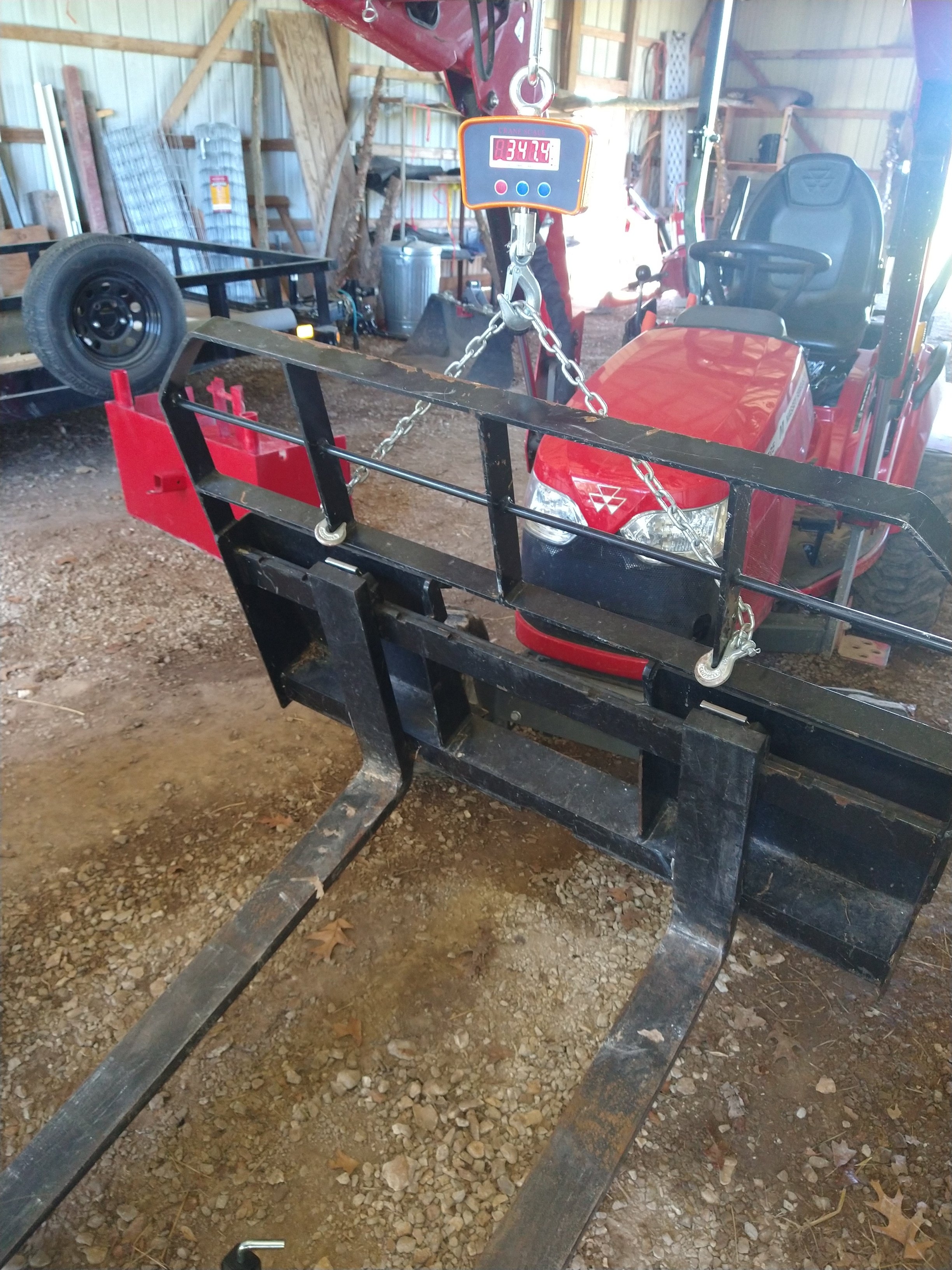

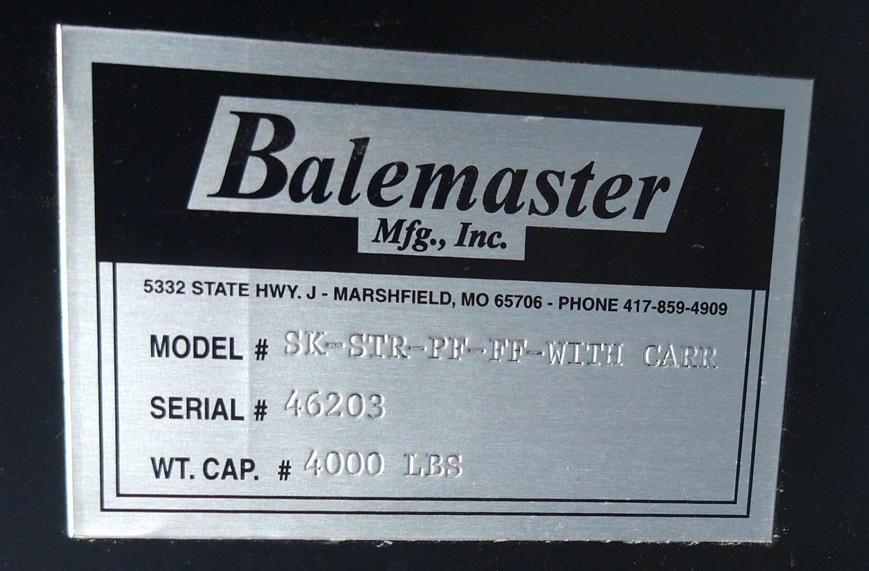

Those forks are rated for 4,000 Lbs, 42" and weigh 347.4 Lbs ... Way over rated for my little SCUT, but all my dealer could source for me back in March of 2022 during the supply chain shortage of stuff ... They are actually a local company that makes them ...
Another thing to keep in mind when using a CUT, and especially SCUT sized tractors and forks, is the farther out on the forks the load is, the less you can pickup! This is where the "pin" is that most manufacturers list as the pickup point ... See how much farther out the load is?

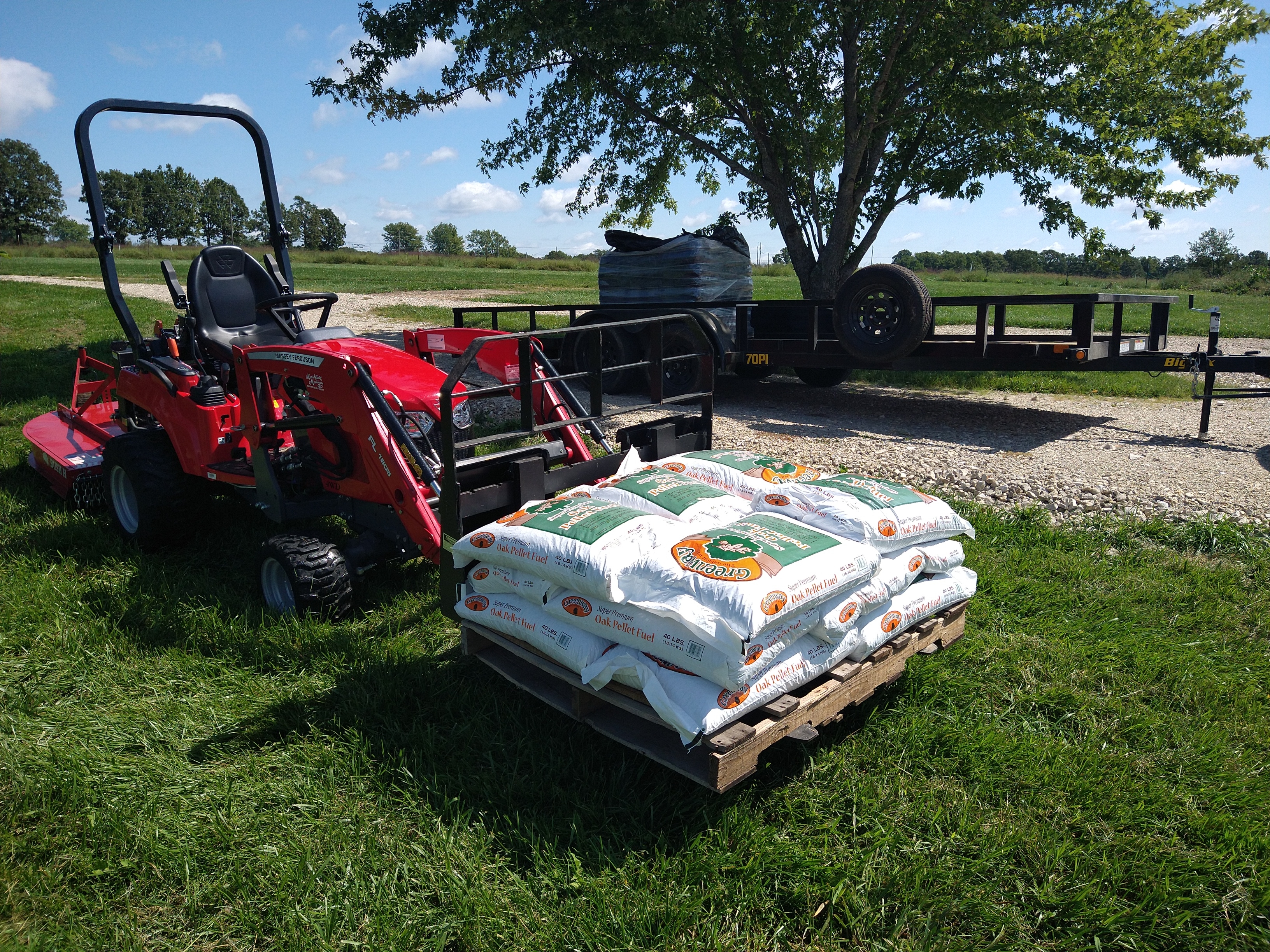

Here I have 15 - 40 Lb bags of wood heating pellets on a roughly 50 Lb wood 40"X48" pallet ... My SCUT has a manufacturer listed lift capacity "at the pins, to full height" of 992 Lbs ... But this is as high as my Little Baby Fergie can lift it! 347+600+50= 997 Lbs ... But it's not "at the pins"!
Next load I stacked it different, and got an additional bag on, but couldn't lift it any higher ...

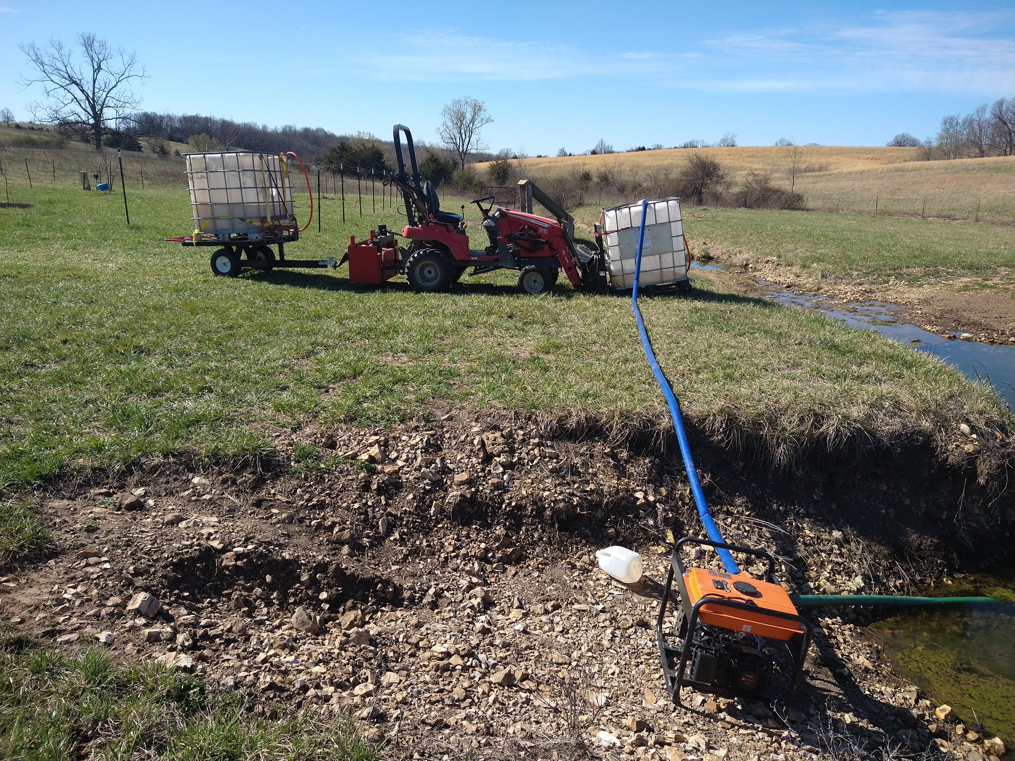

Here you can see that the forks are tipped back, so the water is closer to the pins, I set a block under the front of the empty 134 Lb tote and put 50-60 gallons of water in it, it wouldn't lift it off the ground if it's flat, but by keeping the water closer to the pins it will lift it!

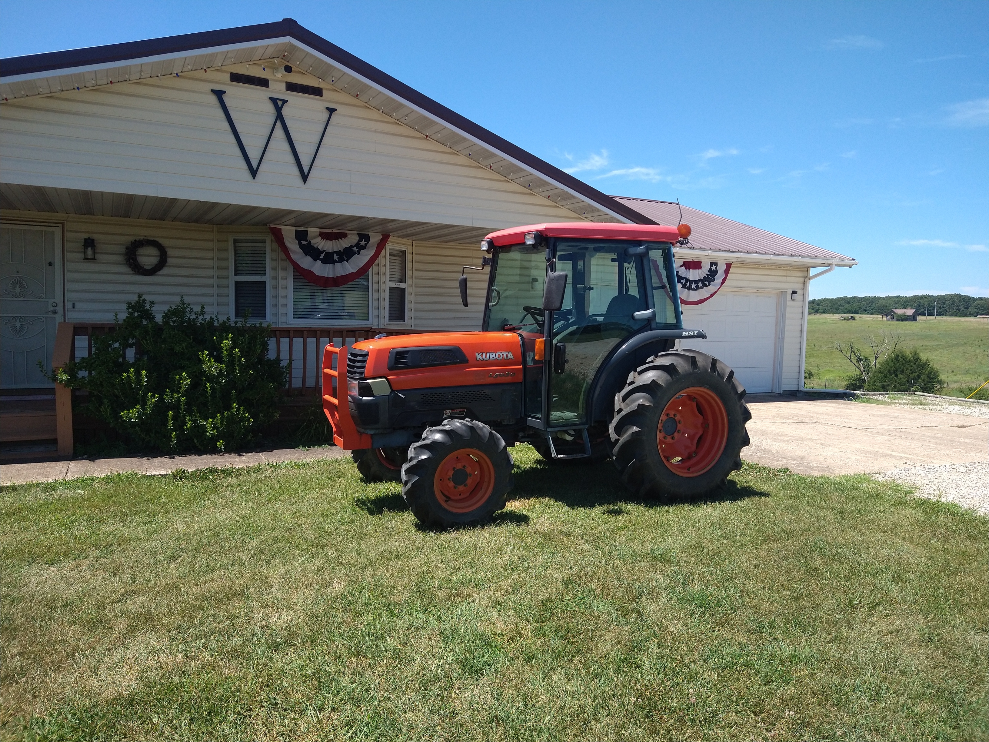

Since I do have these heavy duty forks, and I recently got a bigger tractor, while it doesn't have a loader on it the three point is rated for almost 3900 Lbs!
I asked my local dealer to see if he can get me either a three point with the SSQA so I can put these forks on it, or get a 3 point fork frame that I can put these forks on the frame, and use my bigger tractor to carry a full tote of water, and reduce the wear and tear on my little SCUT ... He is supposed to call me back on Monday ...
I have a rear remote on this tractor, and a hydraulic top link on the QH, so I should be able to scoop up the tote, and keep it level when I pick it up ...
