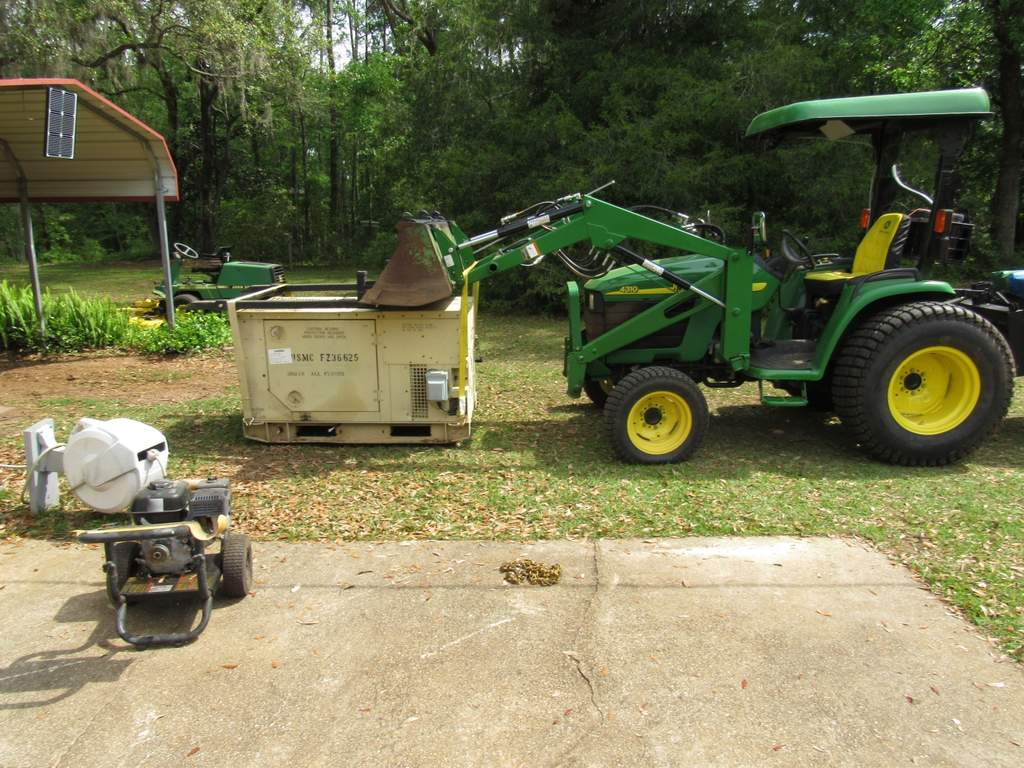

This is the last time I used mine. They went over instead of under but i needed a little more reach to move my generator. I had my 1200 lb ballast on the 3pt and kept the load a few inches off the ground. :)
I have my back hoe for counterweight ....

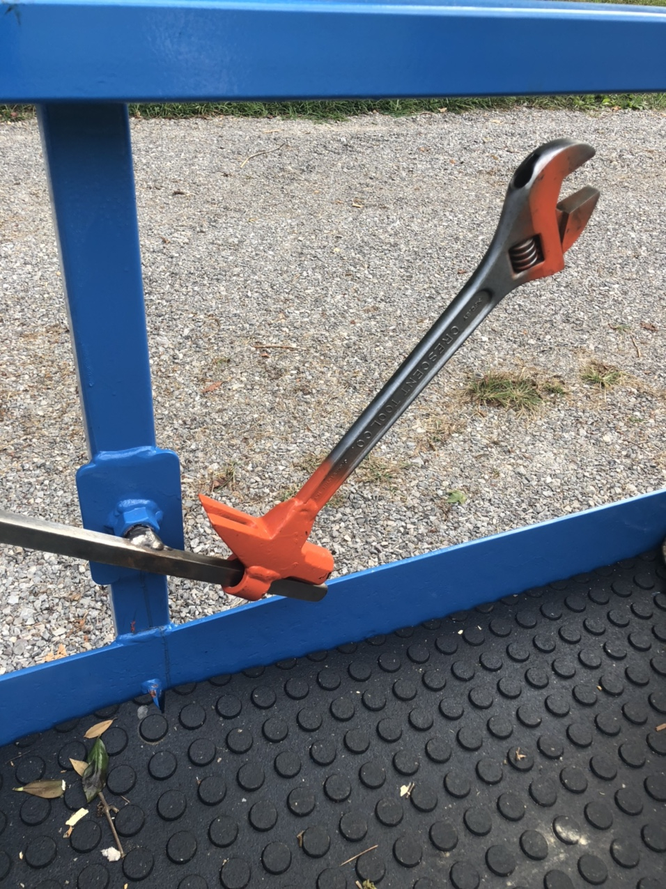

Tool for tightening L and T handle bolts like on some clamp on forks. Heavy wall tubing welded on top of hammer. Since it can rotate gives good angle for lever inside a bucket.
