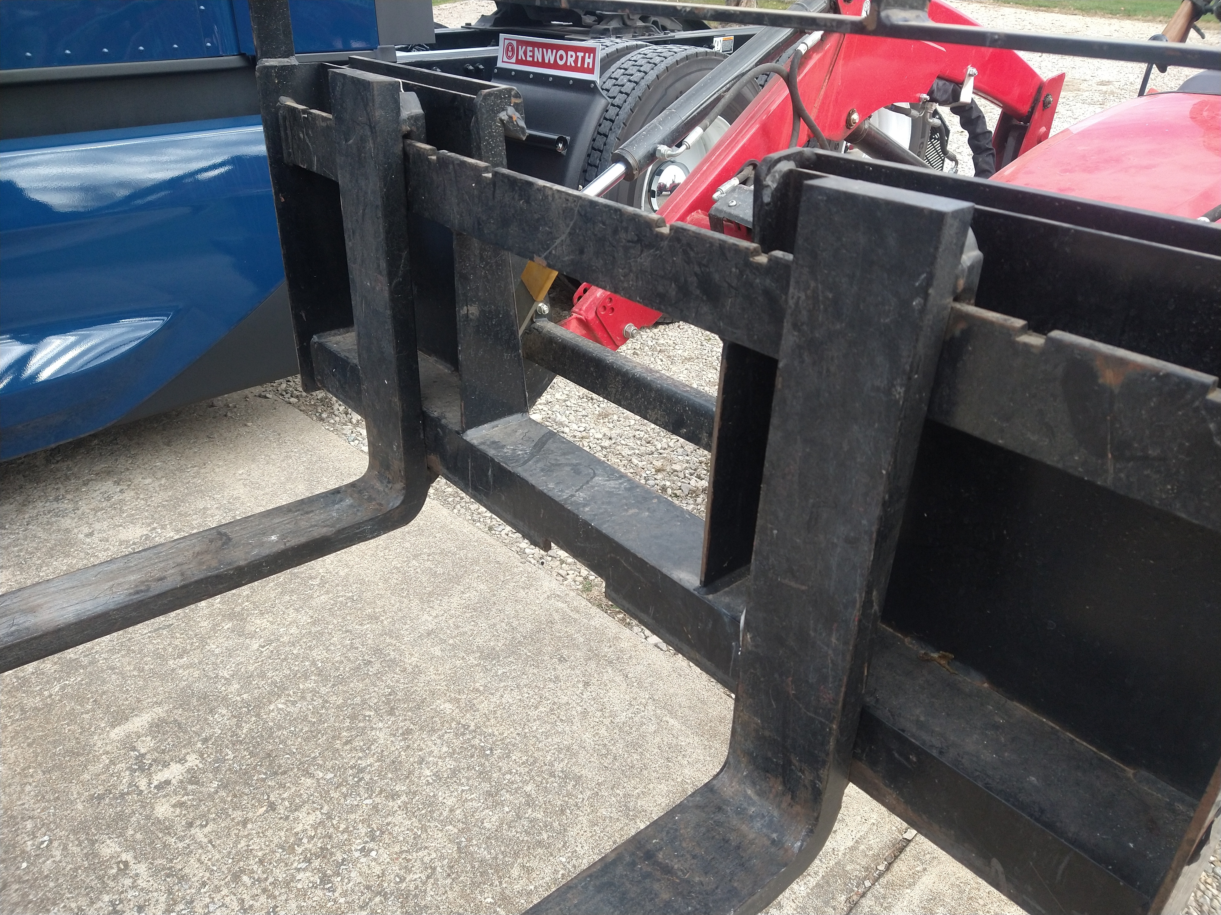

Yes, I hadn't thought that he was asking about the forks themselves, but the whole frame, so my answer was different ...
This is my forks, on a frame ... You can see the center notch in the bottom rail, if you wanted to take them off ...

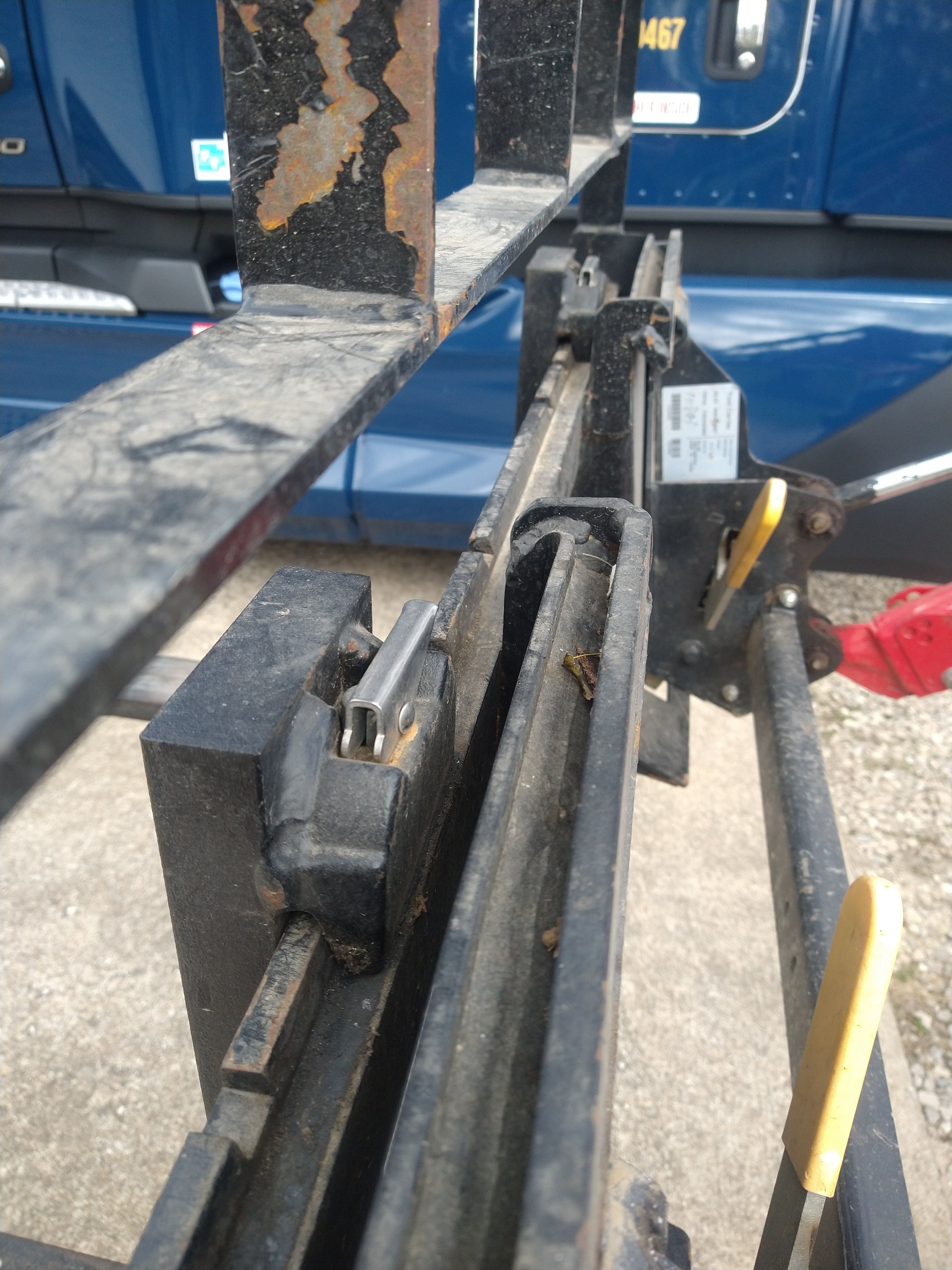

This shows how the top are captured behind the top rail, the bottom is just the reverse, except they don't have the locking latches to set the width ...

PERFECT! Thanks for the illustrative pics. I want to note that the situation I described re flex/bowing of the top rail would be very unlikely with the forks shown. Those have top to bottom rail bracing extending inward close enough to the center to prevent it. YAY - Y!
