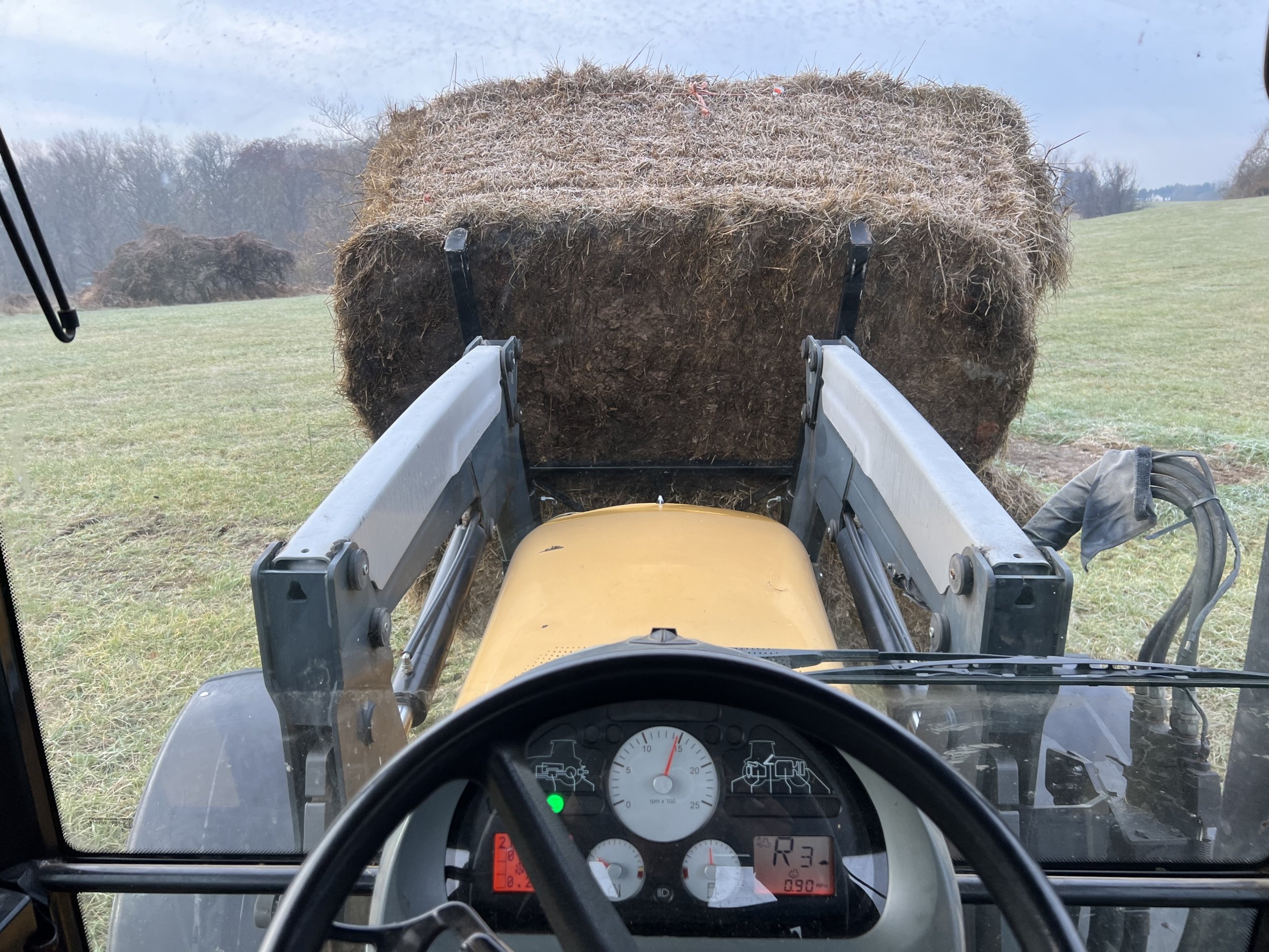

Not to say it will happen to everyone, but there have been more than one person stacking round bales with pallet forks and have the bale fall backwards, causing injuries and damaging the machine. The spear prevents this.

A bale clamp would help prevent an accident. A fork lift frame with a guard would help prevent an accident. Self leveling systems help prevent an accident when stacking. A bale spear does nothing special with regards to handling hay.
When stacking, pushing a bale off the far side can be disastrous for the help or bystanders too. Moving big stuff with big equipment requires attention and precautions.

What prevents bale roll back is a pair of masts.

When I first got into feeding round bales instead of small square bales, I tried using my pallet forks. In time I might of gotten better at it, but just driving down my driveway, I had trouble keeping it on there. I might of had better luck if I widened them. I only did it a couple of times before buying a hay spear.
The hay spear is night and day better. It stays on there no matter how fast you go, or how rough the ride is. You have total control over the bale, so you can stack them, put them side by side, or make as long a line as you want. You can unlade a trailer, or get one out of the back of your truck easily. They really are a must have attachment if you have round bales.
