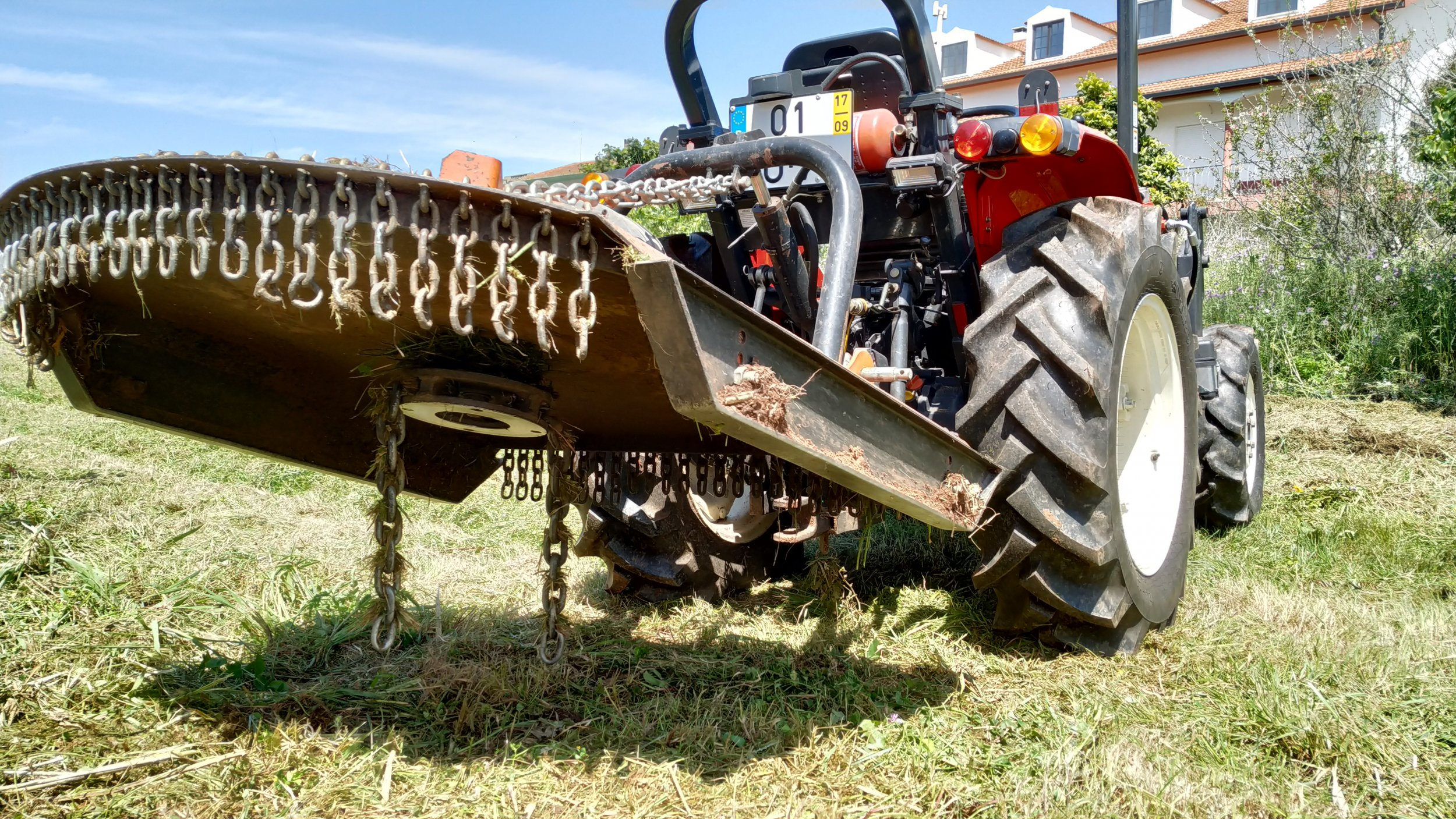

My actual question was about what others have used to make a front guard. Just looking for inexpensive options rather than the pricy guards from the manufacturer.

Chains will handle this

My new Landpride cutter came with rubber belting on the front.

Understood. However, you don't need to buy the overpriced stuff from the manufacturer. I say for less than $100, you can have a chain skirt both at the front and back of the mower looking as nice or even better than the factory one.

We use pieces of old John Deere hay roller belts.
I'll be interested to see how chains are, compared to nothing. I'm sure better. I have another JD cutter I am finishing up with new blades etc. Once ready I am going to test in the same field as the other to see how much the chains cut down this issue, if they do.
I'll be doing the rubber front shield next week once one more item gets here.
Then I can compare both types.

Why not just use the tread section of tires? I think a lot of people don't realize that you can actually fairly EASILY cut away the sidewalls of car and light truck tires with a simple hooked razor blade. I've done it to a bunch of tires i used as 'rock bags' in a retaining wall.
Once you cut away the sidewalls, make one cut sideways across the tread 'loop' (i admit, this cut will be a bit of a pita) and you can flatten that out to a long strip 6-8 feet long. Pretty much any car or light truck tire from the last 30 years has at least one, but probably two layers of steel wire in the tread, along with one or more 'fabric' layers. They are very tough, but can still be drilled through with a normal drill bit for your mounting holes. A few bolts and washers later you've got a serious piece of rubber on there, and the cost is basically nothing. Even if i didn't have any sitting around, i usually drive by probably 10-20 tires a day set out in people's yards for pickup, or dumped on the side of the road.

I use the tire treads shedded from semi-trailers I find on the side of the road. I cut them to size with a portaband saw and mount them with bailing wire.

You could always add some chain to reinforce the belt if needed (like every other or third hole) Nothing wrong with doing both. Belt for dust control, chains for more safety.
