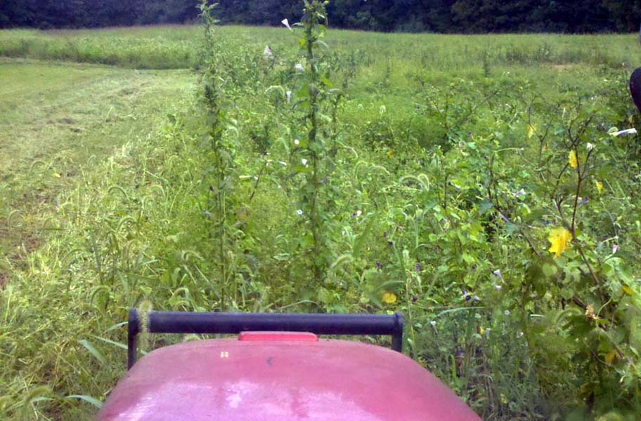

Agreed! Mowing this with a 33hp engine and 6' LandPride bush hog can bog her down at times. If I mow monthly, it's not much of a challenge.

I mow a hilly rough 6 acre field, lawn and a couple of miles of trails with a 4 foot brush hog with a stump jumper hub.
I generally mow with a 19hp iseki/bolens diesel. Weight about 2200 without weights or deck.
Weight of the mower is only a problem when trying to turn on a hill with the smaller tractor. I built a box from half inch steel for the front of it and carry steel and lead weights. Still if it gets slipping on an uphill, lifting the the mower to gain traction is a problem in that it can wheelie. I have learned to avoid maneuvers which cause lack of steering ability.
