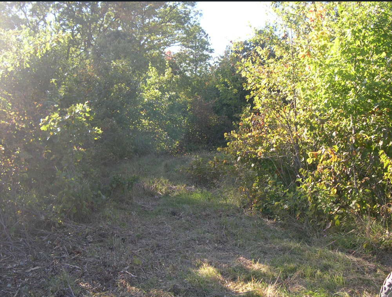

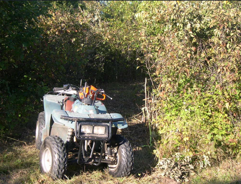

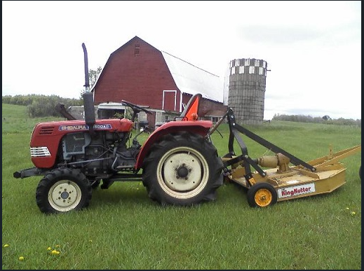

To me,a 4 footer best suits the size of the tractor, not just in terms of power, but also maneuverability, and intuitive use. I have to say that a stump cutter has saved my bacon more than a few times when I ran over stumps that supposedly knew they were there. By the time I hit the clutch, the cutter had "jumped" over the stump.
BTW, here is my former 15hp Shibaura with a 4' rough cut mower. I would drive right through 8' brush to make trails.
