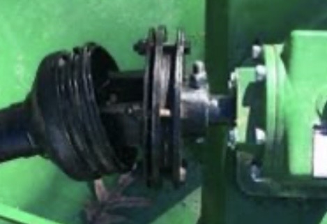

I have not read the 181 posts, so sorry. Has the clutch been checked to see if it is not frozen and it can freewheel? Also, is there a specific torque on the bolts to give it the slip range you need?. I am only familiar with the type with springs, your seems to have a torsion/compression plate of some sort.

   / PTO Shaft to Gearbox Bolts Keep Breaking! #183
The clutch is bouncing back and forth ( left/right) and after time causing the bolt to break.
I would guess there is some wear in the coupler on the clutch and maybe on the the gearbox shaft were the bolt goes thru.

   / PTO Shaft to Gearbox Bolts Keep Breaking! #192
Would it be possible to get a picture of the bolt and surrounding mechanism so we are all sure to be talking about the same thing? I have seen bolts holding flange faces together, flange faces with only one bolt holding them together, sleeve couplers with shear bolts through the shaft and sleeve, etc. I don't know exactly what the arrangement is that's causing the problem.
   / PTO Shaft to Gearbox Bolts Keep Breaking! #193

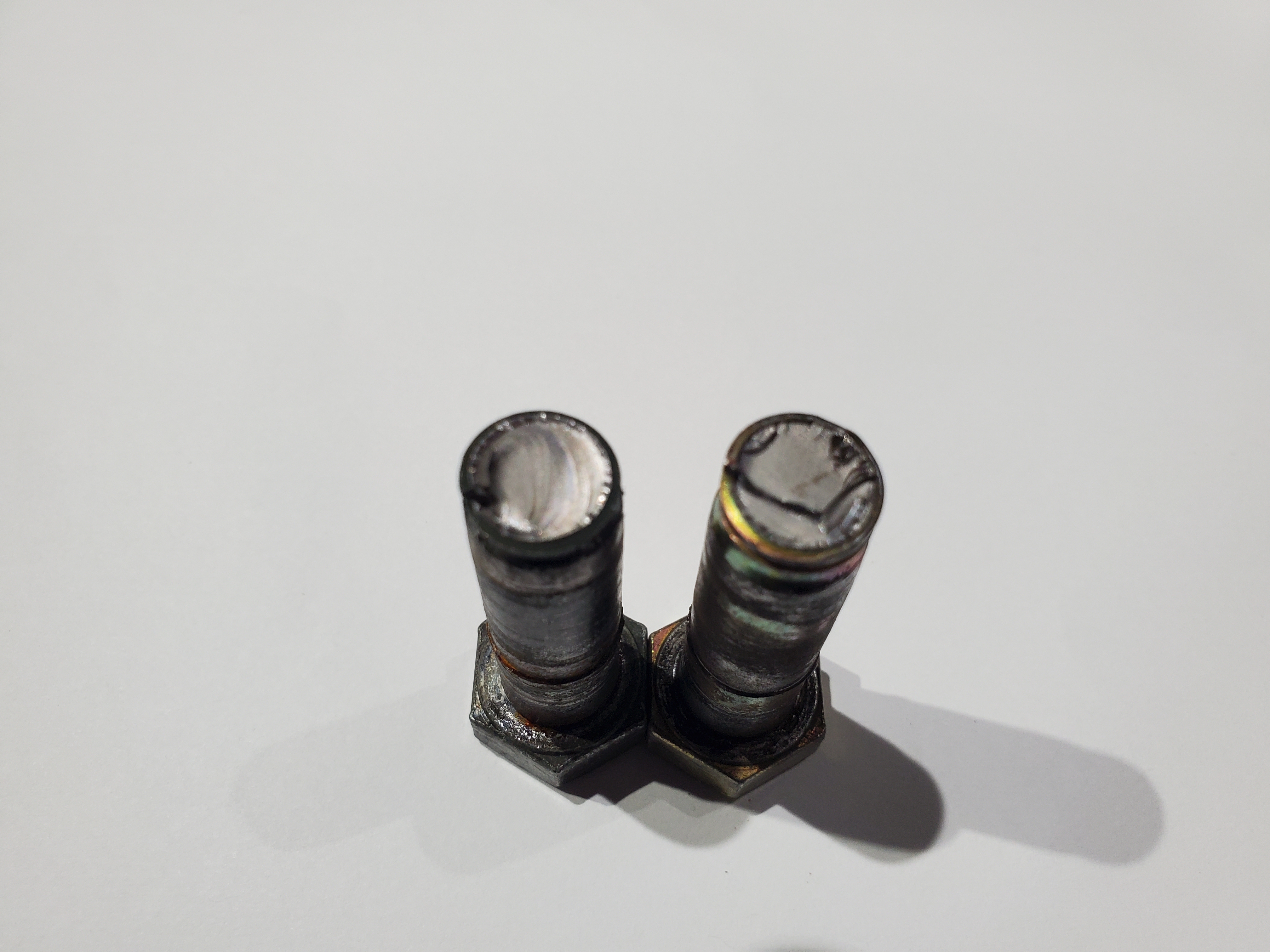

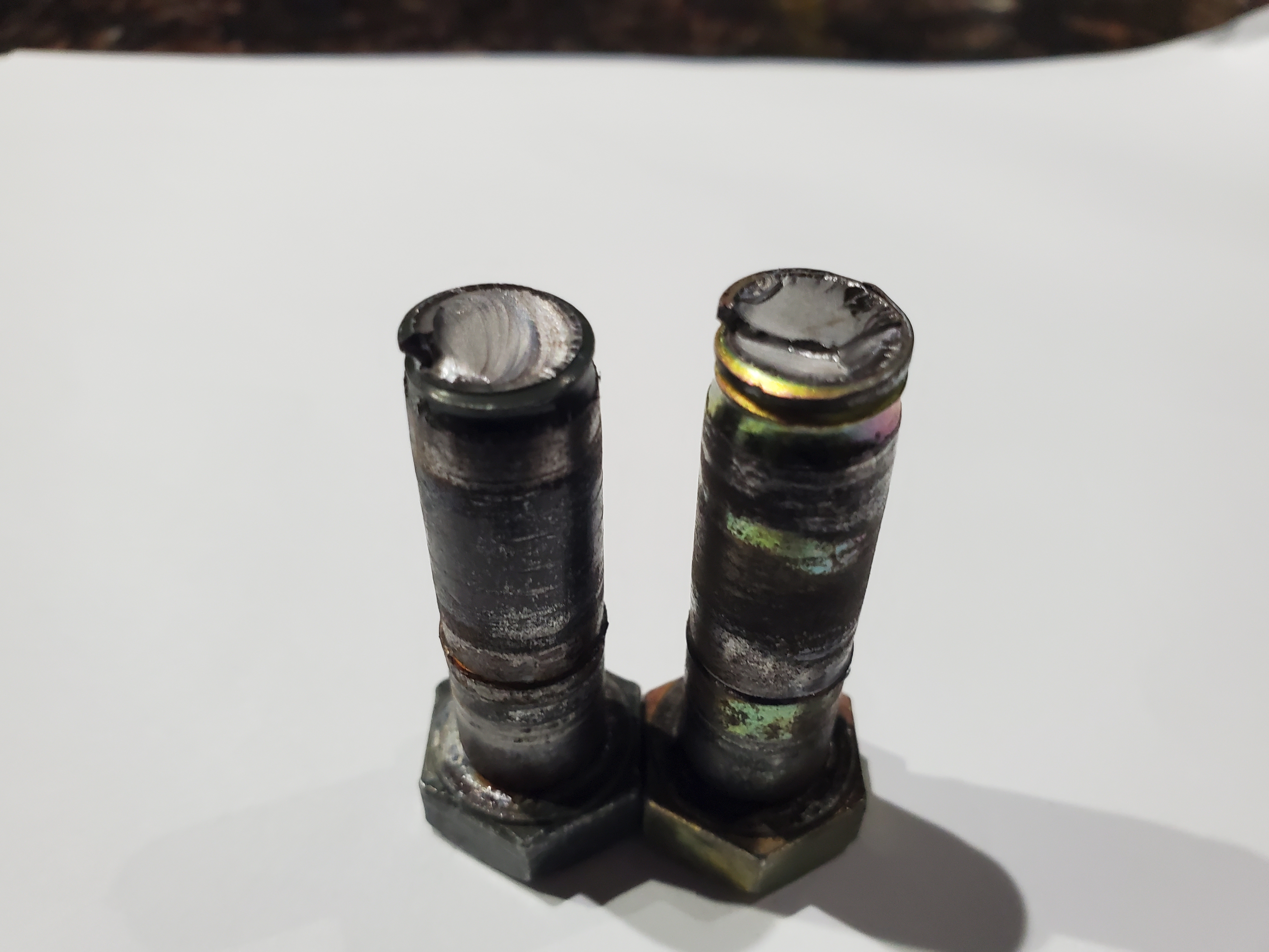

   / PTO Shaft to Gearbox Bolts Keep Breaking! #196
Here are the last three that broke. 2 grade 8 and 1 grade 5.
This is a lighter duty cutter and I don't push it hard. I engage and disengage the cutter with engine RPM at about 1500.
I use it mainly for doing fields that are in good shape and just cutting the field grasses.
Most of the time it is areas that I do about once a month to maintain. Next step would be a finish mower or mid mount and mow a little more frequently, but the customers don't need it cut that often.
It's obvious to me the threaded portion is breaking. FWIW I use 3½" bolts, it is a bit too long so I use a heavy flat on each side of the PTO yoke and torque the nut to maximum recommended.
Every gearbox shaft I've touched is hardened steel, good luck doing any machining to the shaft.
IMO you should lighten up your slip clutch a bit, breaking bolts is telling you something.

it is only breaking one side so it is not actually shearing them. I did use a 3 1/2 and it lasted longer but did eventually break. I think the grade 2 bolts are lasting longer than the 5 or 8's.
Also, they are breaking while mowing nothing more than regular field grass. Cutter is not taking any hits. Not that it is breaking them every day but enough to be a trend and not random chance!
When I am mowing this stuff it barely even affects the RPM it is so easy to cut.
I'm going to change to another PTO shaft and see what happens. Might just be the combo isn't aggregable.
