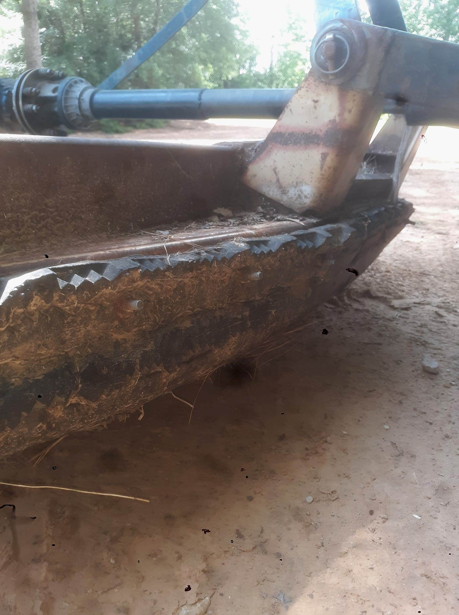

Dust was my biggest issue too. My 6 foot Land Pride cutter had square holes in the front of the deck already that where a perfect fit for carriage bolts. I think they are 5/16's, but I don't remember for sure.
I cut the tire and it fit perfectly across the front of the mower. The curve of the tire was perfect for catching all the dust!!!
It's been on there for well over a decade and still working perfectly.

Eddie, What sized tire did you use that - once cut - spanned 5'? Was it a big 18 wheel truck tire? I want to do the same as you but am unsure how large a tire I need to get? Thanks for the idea, but size would also be a good help. Greg

I dont know what size it was. I just found in on my land and got lucky that it was big enough.
Before I bought the place, people where dumping their garbage here. I had quite a few tires to deal with.

Even a 15" tire with ~ 4" sidewall is going to give you a 72" length.
circumference = π × diameter

Eddie, Thanks for the reply, I'll see what I can find.
IndyJay, Thanks for the mathematical equation and I can easily find a 15" tire. Good to know it'll work.
ArlyA, Thanks to you for helping me think "outside" the box! If to short - dang, just use another! Hah, sometimes what's right in front of me is so hard to see.
